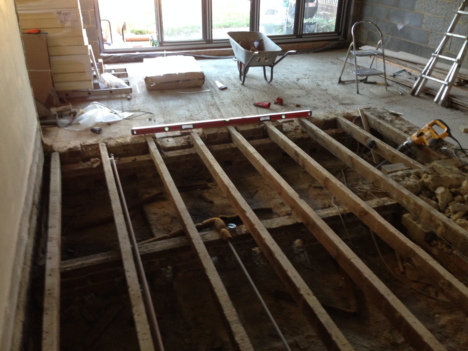

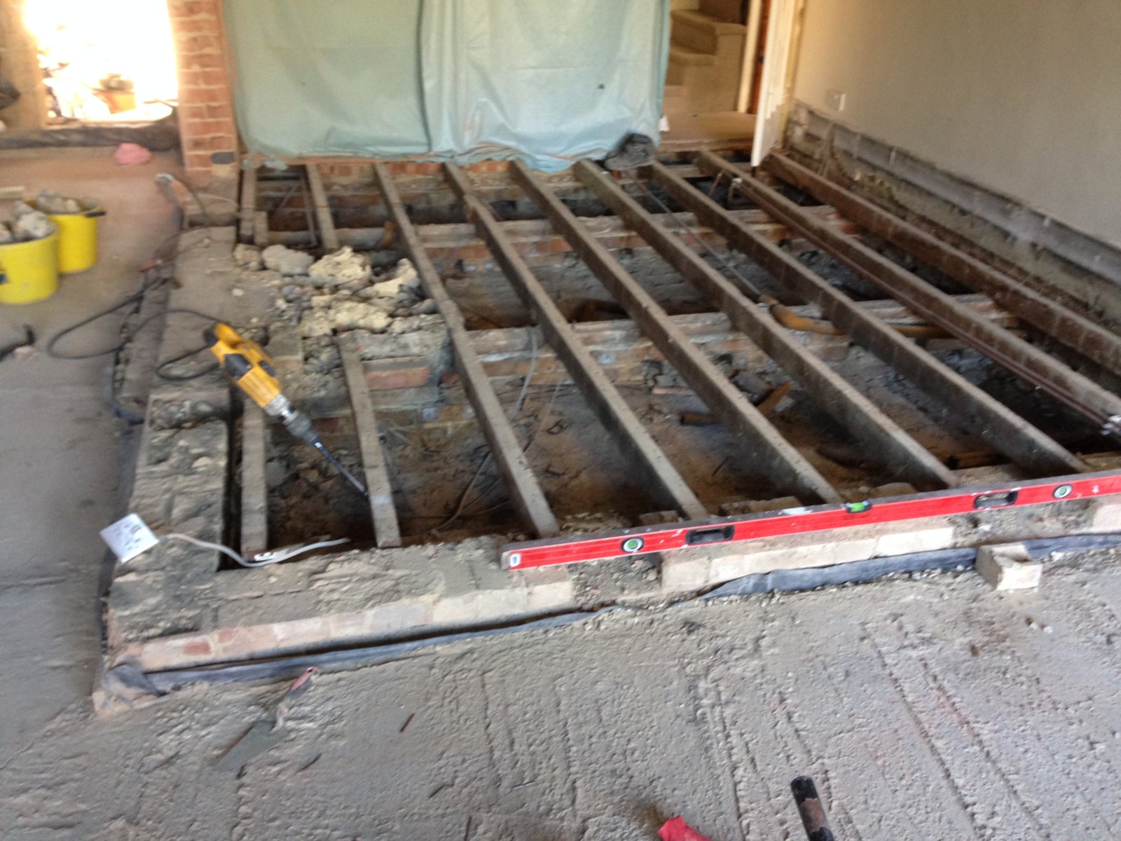

Hi,
As you can see in the pictures my liquid screed will meet my existing timber floor on 2 sides.
The timbers are not level.
Is it best to cut/ lift the floor joists possibly replace and get them level?its about 10mm out at various points. They have been lifted as I'm putting underfloor heating in- both parts of the floor .
What is best to do over the existing 9inch outer wall?
Many thanks
Thanks,
Pack them up from underneath? With plastic?
If I knock the first course off then the liquid screed will just flow through to underneath the floor boards?
Was thinking of bedding timber on mortar on top of this bricks? What you think?
