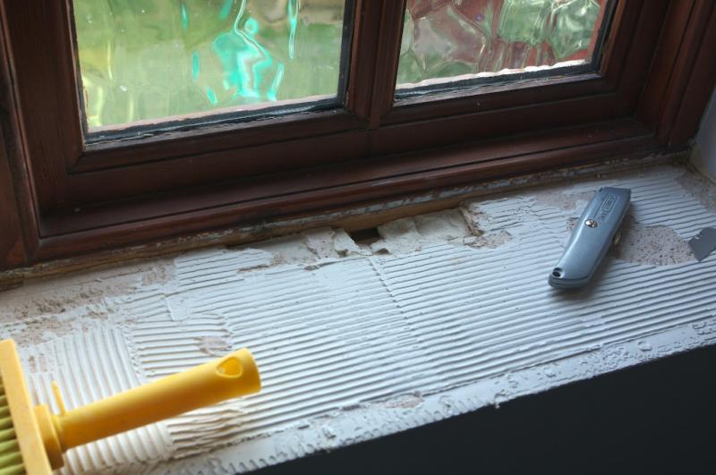

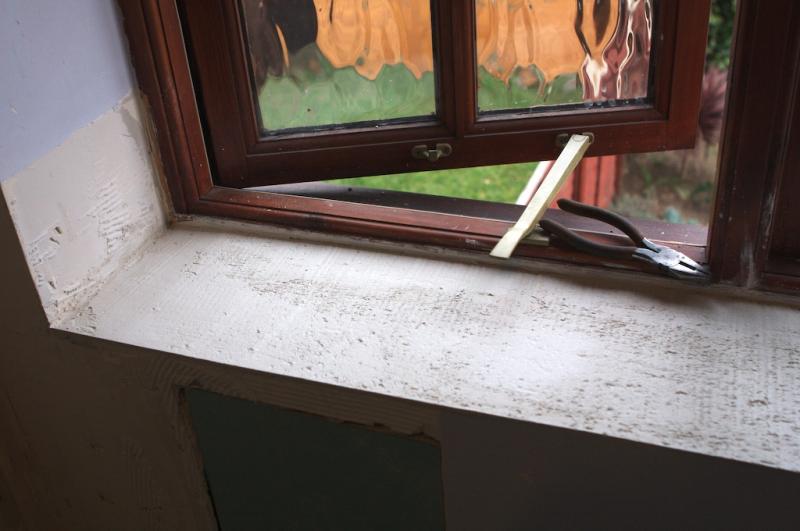

I've removed the tiles on my window and some of the plaster has come away in places while over the majority of the surface the tile adhesive has remained in place.
Attempts to remove the tile adhesive have further damaged the surface so i've bought some plaster and i'm considering sealing the existing surface with PVA and then applying Easi-Fill or Finishing plaster to provide a level surface and fill in the deep holes. This will make tiling easier for me.
Is this advisable? I've posted pictures.
Forget Easyfill it’s not really suited for what your doing & too soft. You could do it with Multi but you will have to fill in those deeper holes in a couple of stages, if you apply it too thickly (more than say 6mm) it’ll crack.
I don’t often recommend the stuff but, in this case, your easiest option is probably to buy a small bag of one coat plaster, fill the holes first & skim across the adhesive ridges. It doesn’t have to be perfect if you’re tiling over but wait until it's dry before tiling. You could also skim it with tile adhesive if your using a cement powdered type adhesive.

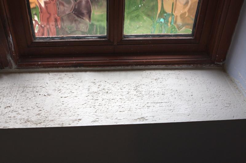

I bought the bag of 1-coat plaster as Richard C suggested and had a crack at the window and I'm fairly pleased with the result only because i know i'll be tiling over it. The main aim was to produce a level surface and I've done that. Unfortunately there is a bit of an overhang as the batten I used to guide me didn't have a perfectly straight edge and it's not as smooth as some plaster jobs but I figure that'll actually provide a good key for the adhesive.
If anyone wants to give me suggestions on improving I'd welcome them. Before and after photos are included.
