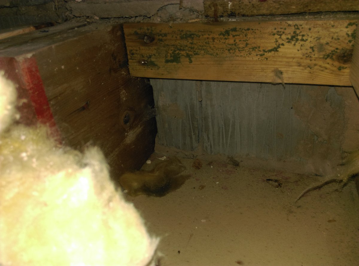

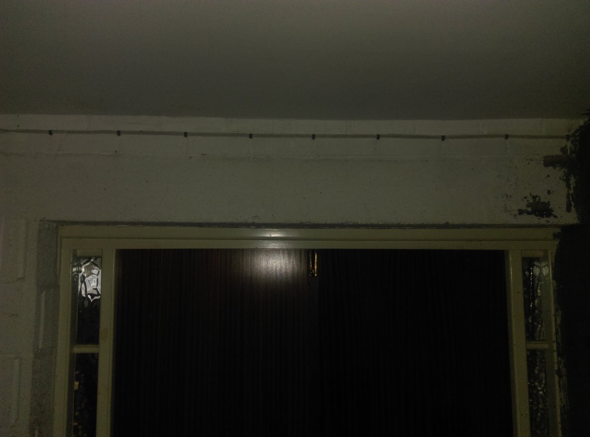

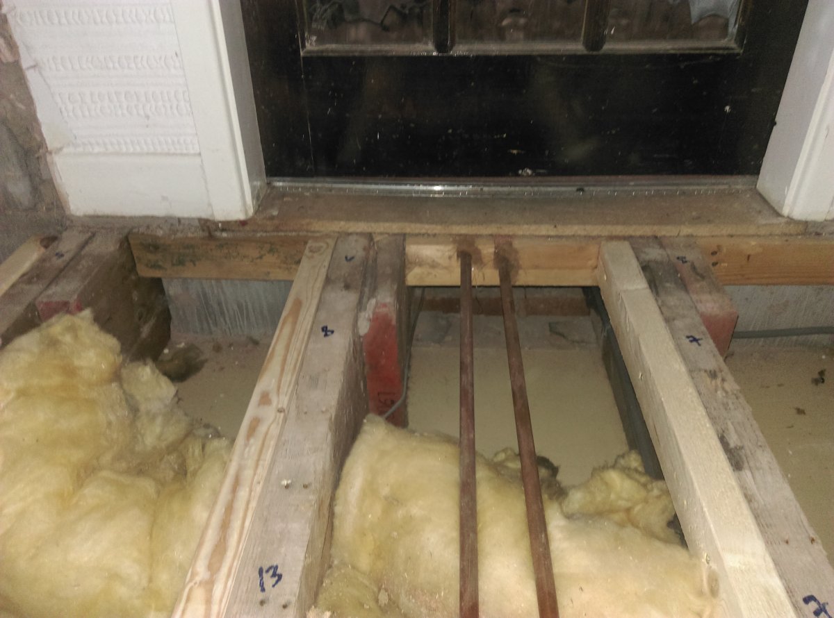

Hi folks, OK, here are some photos. You can actually see the sag in the first photo, but the second photo is from the other side of the door and there doesn't appear to be any sag.
There are no signs of cracking anywhere.

Looking at those, I'd be suspecting there's no lintel or not much of one above that doorway- the frame doesn't look that beefy but the 'drop' is on the inner skin of the wall where the frame isn't and timber is quite good at supporting dead load (much better than PVC). 15mm is quite a lot across 1900 mm or so

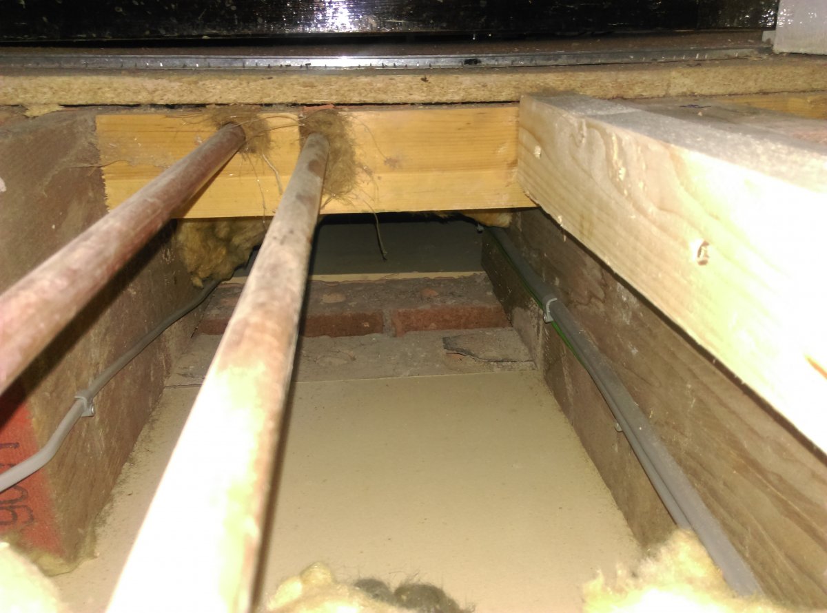

Hard to tell for certain- is that double doorway original or has a single door or window been enlarged for a conservatory/extension addition at some stage? Have you already fixed 3 x 2 along the dropped joists? (pic 3)
Difficult to determine presence or absence of lintel without knocking plasterwork off, you could try drilling with a long 3 or 4mm masonry bit and see if you hit metal, timber or concrete under the plaster. Or try a stud detector. End of the day, if it has been there for a while and not cracked then whatever structure is in there is probably going to stay there unless you do something major to disturb it. Me, I'd like to know.......

That what you see there above the doorway is the actual concrete lintel (or whatever it is) - there's no plaster there.
We only moved in a year ago so don't know the history but looking at the paint around I'd think it's been a doorway for quite some years.
Yes I've screwed 3x2s to the sides of the joists to level them out - it's worked a treat, and so much easier than nailing stripwood to the top of the joists and planing down like I was planning on doing!
Problem now is that the ceiling below is gonna need levelling out too before we board over it :(
Thanks for all your help, will keep an eye on the "lintel" and cross that bridge if it moves any further.
