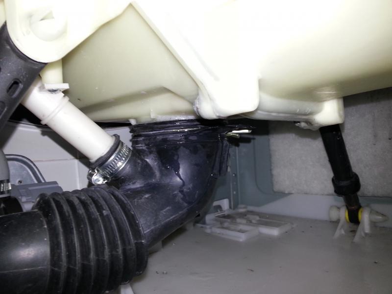

We have a LG washer/dryer model F1403RD . The washer is leaking water inside somewere and the white plastic bottom of the washer fills the eventually overflows and I have to tip the washer up to get it out then mop up.
There is like grey fluff matter in the water which suggest it"s not a small leak. Is it hard to check were ? It just looked hard to get access to all the inner pipeworks without a full tear down.
I originally thought there was a leak on the drain hose but as far as I can see it was muck not a hole.
I changed both pumps on the washer and replaced the clip-on hose springs with a sturdier jubilee clips thinking it might be from there but it's still leaking.
Does anyone know were else apart from the pump hosing were it could be leaking from ? it only leaks on spin.
I'm at a loss as to why and were the water is coming from. It flooded the kitchen when on spin. It seems to do it when the washer is say over 1/2 full.

Spooky that , because I have just done that. I filmed and took pictures while it was spinning from the back going inside and underneath and it is leaking from the main drum.
Were the 2 halfs of the plastic drum meet there are 2 bolts this is were water starts gushing out. The water then must be travelling to the front part were the pump is with all the vibration.

The water comes out in and around the 2 bolts then splashes onto the bellow hose so given the impression its the hose but I double checked and it's def the drum seal. I have given them a slight tightening up, I got about
a undrert a 1/4 turn on both. If that stops it then I will get some loctite.
Certainly hard to see exactly where its coming from but easiest thing 1st is to replace the hose clip, clean both spigot and inside of the pipe to be sure of a good clean seal. Being OTT you could use a sealant too!
If this does not work its clearly coming from the drum seal which is a bigger job.

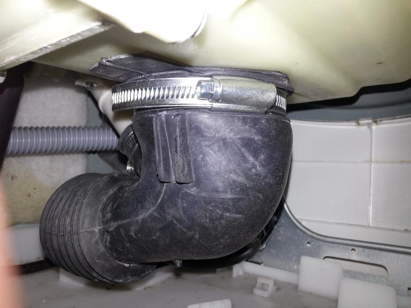

Both pumps were replaced a few months back and I have lowered the drain hose. Would you recommend a jubilee clip for the bellow hose ? .I'm scared of overtightening the clip that's on now as it's a wire and I'm thinking it would cut through the rubber hose.
Would you happen to know the diameter of the bellow hose were it fits to the machine drain hole ? , I might nip out and get a jubilee clip
Not sure, quickly and roughly measure probably about 4 inches so a clip thats slightly oversized to make it easier to fit on.
problem solved !!
Turned out to be the original screw wire clamp around the top of the hose that just wouldn't seal the hose no matter how tight I screwed it up.
I replaced it with a 70mm-90mm jubilee clip from b&q made sure I got it snug and the rubber hose right up to the top and tightened it up well.
