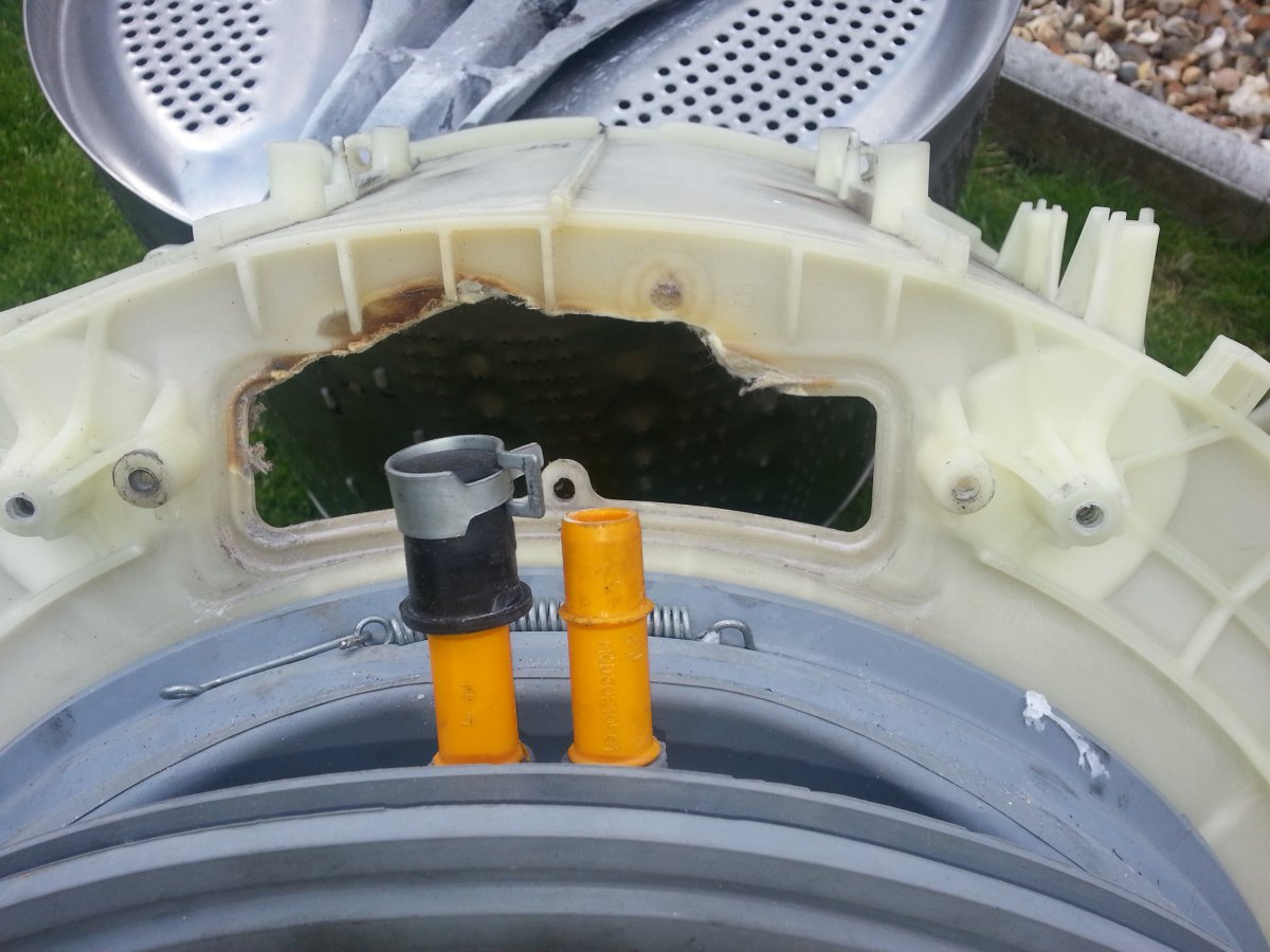

I have stripped down my LG washer/dryer F1403RD to replace the bearings and gasket after a leak and I've come across a couple of problems. Firstly , the front outer tub is burned like it's melted at the front top so I'm pretty sure water has been leaking out the top on spin the running down the inside drum door seal onto the motor.

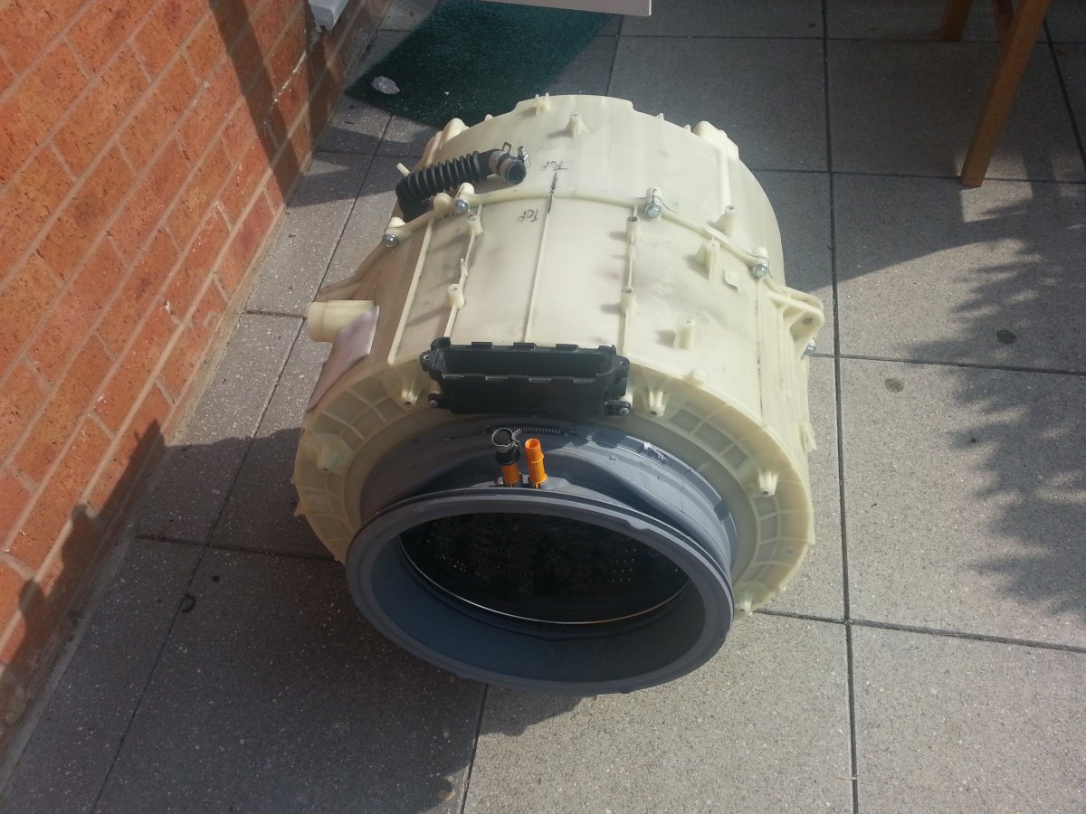

I decided to take matters into my own hands :) I used a largish center punch and bashed a load of holes just on the edge of the metal part of the tub were the bearing sits to expand it and it seems to have done the trick then.............. while browsing on eBay I found someone selling a boxed LG genuine rear tub for my model.....a one off end of line stock for £35 in stockport so I drove there this morning and collected it as I'm only 1/2 hr away.
It comes with bearings and seal installed and hose and heater extraction gasket in place. I am just waiting on the front tub been delivered today and it's all systems go. It's a job not for the faint hearted but if you make a note of were every screw comes from (draw a pic and tape the screws to the pic) and take lots n lots of photo's then reverse it for assembly you can't go wrong. Hopefully it should be good for a few more years as I changed the pumps last year.
Well I spent the best part of a day rebuilding the washer with a few hitches here and there but all's now well and at this moment in time the washer and dryer are running fine. There was one major thing I found that alarmed me, were the vent connects to the top of the front outer tub there was a huge hole which had burned straight through the tub (see pictures before strip down and after).
This black vent part is made of metal so if my memory serves me right from my school days metal is a fantastic retainer of heat therefore holding the heat from the dryer and burning right through the tub you can see the scorch marks. There is nothing wrong with the thermostat and heater element they have been checked and are working fine now. So while I was looking for holes and changing door gaskets and hoses galore not to mention every hose the problem was tucked out of site behind the vent cover.
I also found the hole were the rear sealed bearing sits was damaged to the point were a new bearing was too small and the whole outer edge of the bearing span round as well !. So i changed the outer tub as well.
I have emailed and live chat to LG asking about the tub and fire resistant to what heat. Can you imagine your out while your washer is on a timer wash/dry and you come back to a pile of ashes that resembled your home ?. I have the tub and I will be sending it to a friend for him to test the properties of the tub. For over 2.5 years I have fought tooth and nail with this washer. It's been one thing after another ,endless changing virtually everything bar PCB's.
