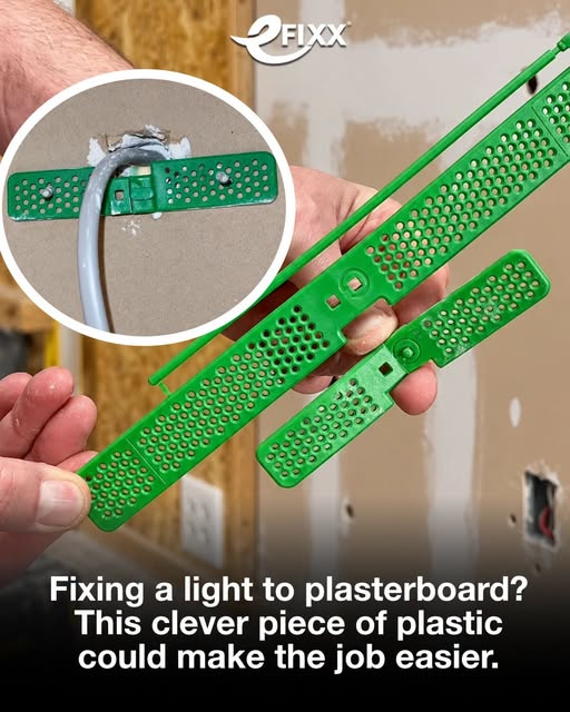

I know when my mother had a winch fitted to get her in/out of bed, lamp needed to move, and it was fitted to plaster board. Pro job, not DIY, but little option to where it went, so there are times lights are not fitted to the beam.
But in the main, as a pro, we have to consider what will happen latter, I know son was doing some council house refurbishment, and council rules did not allow chandeliers so he had to remove any fitted, and the tenants were charged to have their chandelier removed and skipped, seemed a bit unfair, but they knew the rules before fitting them, and so in that case, we know you can't have 5 kg on the plaster board.
But in the main, there is nothing to stop an occupier going to the limit, so the fitting must take the limit.
So to fit a winged type plaster board fitting to stop a cupboard tipping over, or for any other use, it is down to the user to decide if the fixing is good enough. But to market a device to hold light ceiling roses, not just general use, but for this job then it must clearly be able to take the 5 kg weight, should it fail, the responsibility has shifted from the person who has used it, to the manufacturer who has marketed them for that use.
