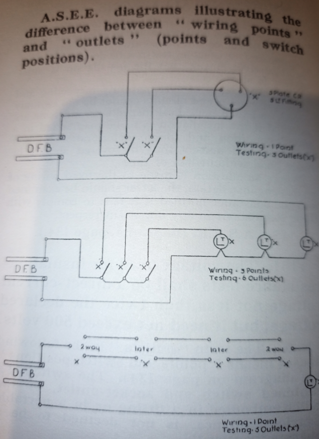

1102. When an insulation test to earth is made of the wiring only (ie before the fittings and switches are fixed) all conductors shall be so connected together as to ensure that all parts of every circuit are simultaneously tested and the insulation resistance to earth shall not be less than 100 megohms divided by the number of outlets.
A new one on me!
The guide then prints the following:
A new one on me! The guide then prints the following: ...
A new one on me, too. However, I suppose it wasn't too bad a
rule of thumb to estimate the extent to which whole-installation IR may decrease with increasing complexity (and increasing cable lengths) of the installation.
Mind you the definition of "outlets" they go on to illustrate is, to say the least, rather 'interesting' !
upload_2020-10-7_19-18-35-png.207290
