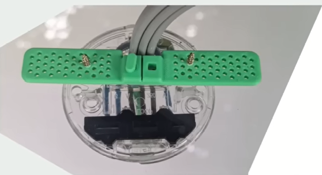

1738248373270.pngI watch eFIXx quite often and 559.6.1.5 of BS7671:2008 says "In places where the fixing means is intended to support a pendant luminaire. The fixing means shall be capable of carrying a mass of not less than 5 kg." I can't see how plaster board can take a 5 kg load.

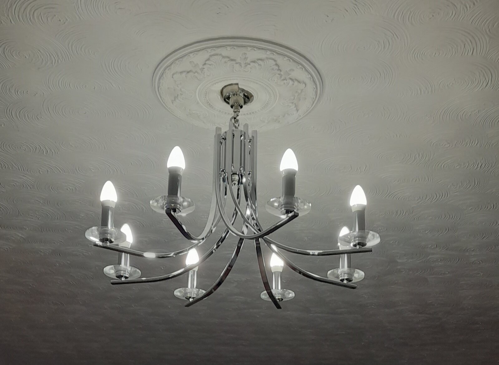

To be frank, not seen many chandeliers which weigh 5 Kg, and I would question if the flex can take that weight. But we don't often know what supports the lights, with my own lights, Ceiling light.jpg I know the ceiling rose has reasonably long screws which fixes it to the beam, but if someone else was to unplug it, and plug in a replacement, they would simply assume the person before him had followed the regulations, and 5 Kg falling on one, is something one would not forget in a hurry.

I think it's much more a question of the nature of the fixings, particularly the extent to which they 'spread out' the load they are supporting (and how far they are from the supports of the plasterboard), than to the question of 'what weight plasterboard can support.
If one uses fixings which have lugs/arms/whatever which 'spread out' above the board, I think that plasterboard can probably support a good bit more weight than you seem to think.

View attachment 371208I watch eFIXx quite often and 559.6.1.5 of BS7671:2008 says "In places where the fixing means is intended to support a pendant luminaire. The fixing means shall be capable of carrying a mass of not less than 5 kg." I can't see how plaster board can take a 5 kg load.
