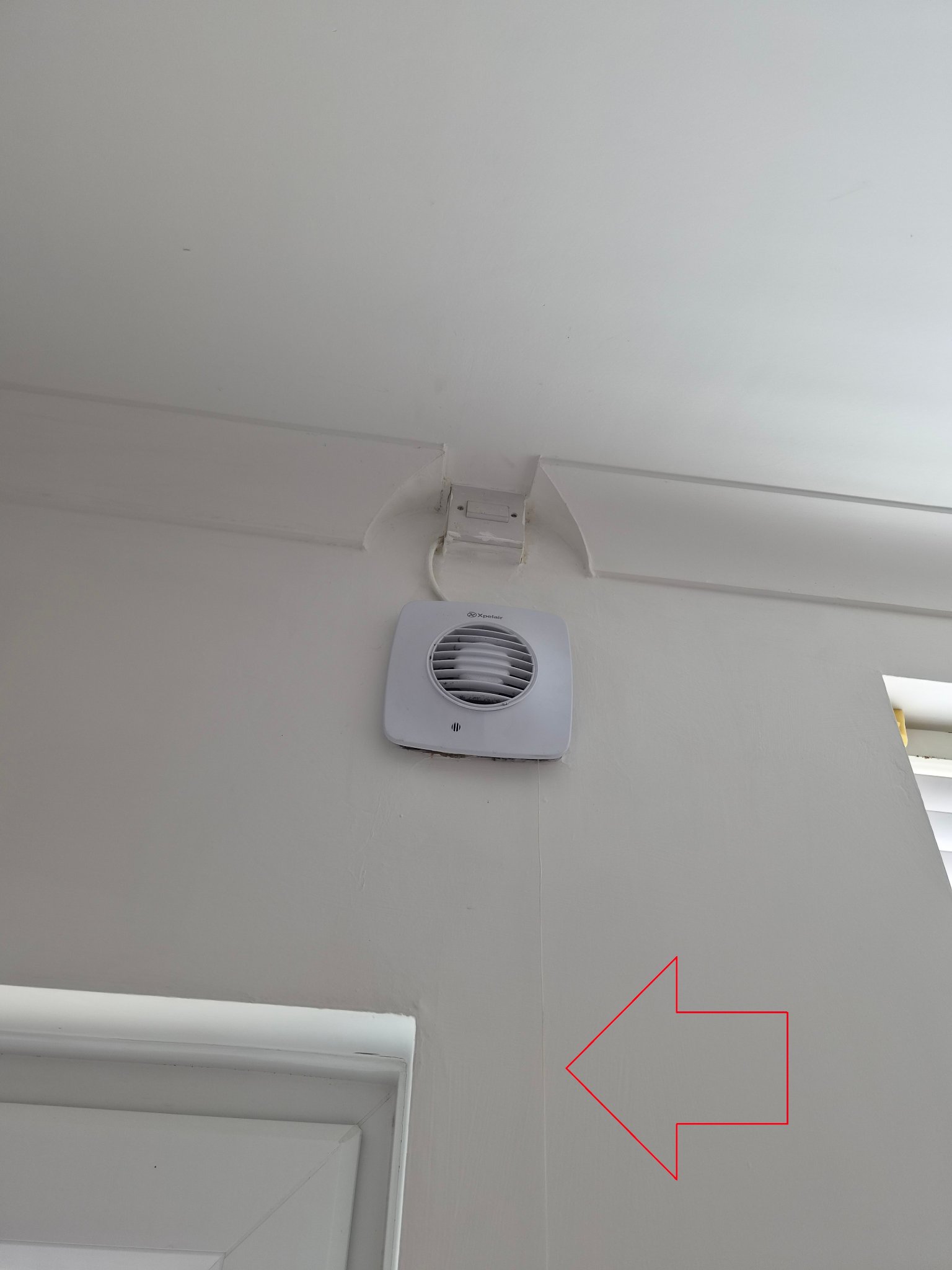

My FIL is hard of hearing so he can't hear the extractor fan turn on and off. He therefore leaves the fan on as he doesn't realise he hasn't switched it off!
He has an extractor fan that has a pull chord as shown in the attached photo. The fan doesn't have a timer.
You can see the isolation switch directly above the fan in the photo. I have added a red arrow to show the long pull chord on the fan, which turns the fan on and off.
Is there a simple way to add a light indicator to the arrangement so that he can see when the fan is on?

Could you alter the wiring so it comes on with the light?
it is in the kitchen so he turns it on when he is cooking. there is a cooker extractor fan but that doesn't have a vent to the outside so this one is used to extract air to the outside.
during the day time he doesn't need the light on in the kitchen and he may want to leave the fan running when the lights aren't on.

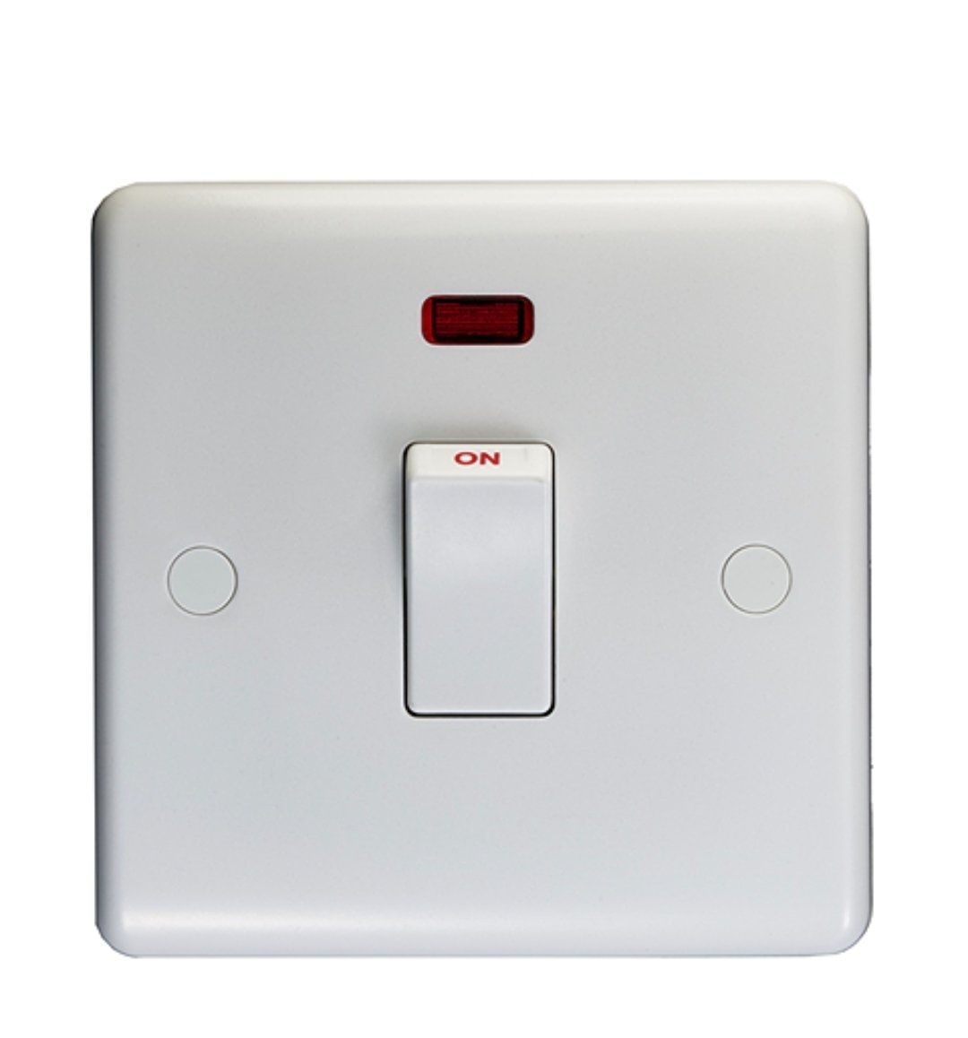

Could the switch be changed for one with an indicator lamp/led?
if there was a switch, that would be the simplest way to put a light indicator in. unfortunately, the isolation switch is high up so you can't use it as an on/off switch.
one way would be to put an on/off switch in with a light indicator but that would mean running a new cable and putting in a new switch. i was wondering if there is a simpler solution.

I’m not an electrician, so not sure if it’s possible (@pete01?) maybe wire a switch with lamp in from existing switch then back to fan?
