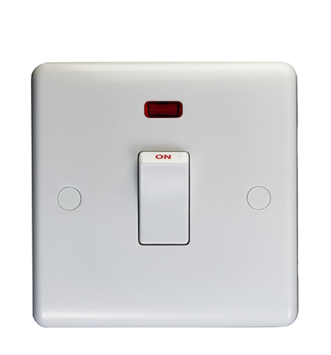

Yes something like this, might have chase down or a bit of trunking (maybe)
that was the solution i had thought of by it needs chasing in the wall and trunking, which means redecorating. that switch would replace the pull chord, which can be set to be permanently on.

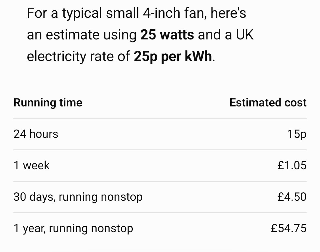

lol. does a 4" extractor fan like that cost much to run if he accidentally leave it running all day? how much would it cost to run a day if it was left on 24 hours?
15p ish
i was hoping there is a simpler solution but it appears there may not be one, apart from buying a new fan that has a light on it.
You would just need a short length of surface mounted trunking down to a surface mounted switch, no redecoration required. Then switch on at the pull cord and cut it off so it can't be switched by it but just the new wall switch.
