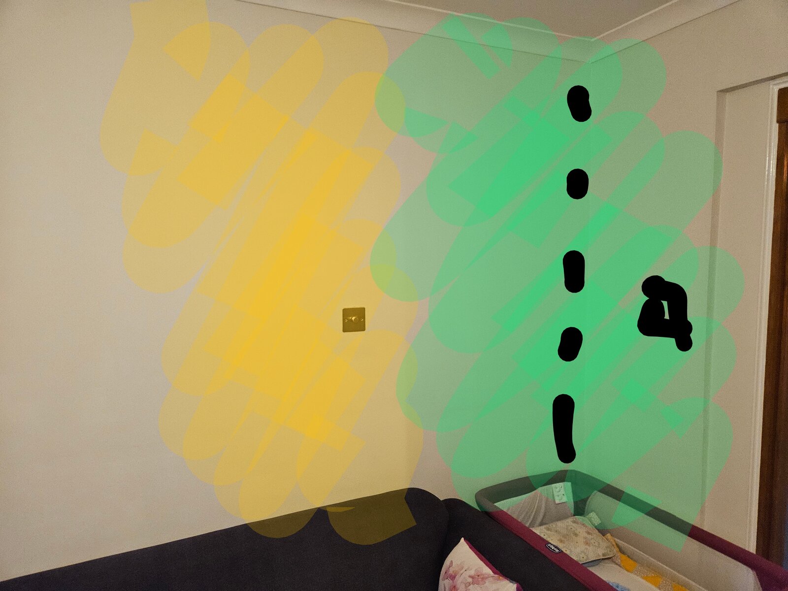

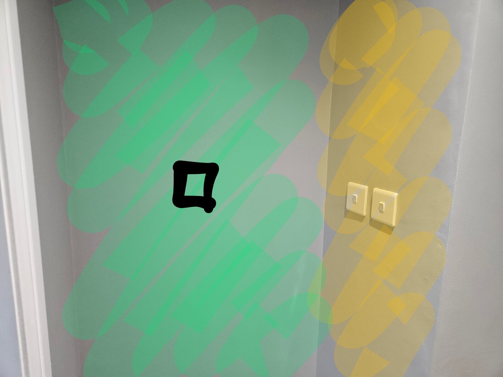

I'm looking at moving a couple of light switches to a new location and thought I'd see if anyone had any good advice on this at all.
So, first off, I've messaged a couple of electricians to see what they'd quote for the job. One has come back to say they'd do it for about £400, which seems steep to me for the work involved.
I'll see what the other quotes come in at, but if anyone has any thoughts on a reasonable pricing then I'm all ears.
If I don't go down the route of someone doing the whole job, I figured the next best solution would be for me to basically so all the wiring and then get a qualified electrician to rubber stamp the work or do the final steps. I'm no electrician, but extending cables to make a light switch reach a new location seems like the easiest of jobs.
The trickiest part to my mind is getting those cables to the spot that I want.
The attached pictures show the two switches I'm looking to move. The orange hilighting showing where brickwork exists and the green where plasterboard exists. The black boxes where I'd be looking to move the switch and the black dotted line is a 90° corner in the wall that became less visible after the highlighting.
For the brickwork, I imagine I'd just need to drill out a chanel for the extension wire to run along. Then afterwards I just need to plaster and repaint.
For the plasterboard, I'm honestly not sure on how best to run that behind. Should I be drilling holes at intervals to fish the wiring along? Also, how would I deal with any supports for the plasterboard? Try to go behind somehow or make a cut in the front?
As you can probably tell, I'm a bit clueless here.
In terms of where the old switches exist, I know that a faceplate needs to be added, which is fine as pictures/mirror is going in front
Also, there's no joy to be had from going above as there's parquet flooring that'd stop that.
What do you think? Am I making life hard for myself by even considering this, or is this totally doable?

Why do you want to move them?
Have you heard of safe zones?

not 100% sure i follow the images supplied
is thet 3 switches moving - one on 1 wall and 2 on another
what do the switches actually supply ?

Thanks for all this. There's a lot that I don't know and will only appreciate when someone draws my attention to it.
So, I'm away from home so can't photograph, but I'm pretty sure my circuit breaker has rcd protection, though I'll check when I can. The electrics were completely redone when the previous owners extended the house about 5 years ago.
As to why I want to move them, it's that there in inconvenient locations. One is in the hallway when it controls the light for the dining room (not too far, but a nuisance). The other is smack in the middle of the lounge wall, which is where I'm looking to put a large mirror.
From searching, safe zones seem to be a practice of routing cabling around edges or corners of walls. Presumably so that idiots such as myself won't drill through them when adding large mirrors. Sounds very sensible and I've no idea if the electric works in place have followed this.

Ahh, that's a fair point about someone not wanting to sign off on work that I'd completed myself. I suppose I imagined doing the more manual and time consuming element of the work and the professional could do the part of the work that they're most skilled at.
It's just two switches I'm looking to move. The one by itself and the left most of the two. I've mentioned what they supply in another message
In your second pic. the new position of the switch looks like it is going to be behind a door when the door is open, which is not advisable. Unless the door hinges the oposite way to how it appears.
So it's going to be on the right as you walk through a partitioned divided space that folds back away from that wall, so it should be fine. Thanks for the thought though
