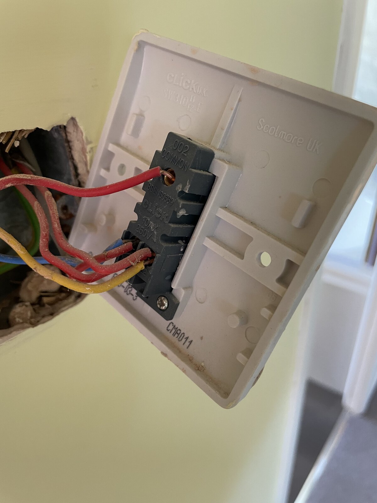

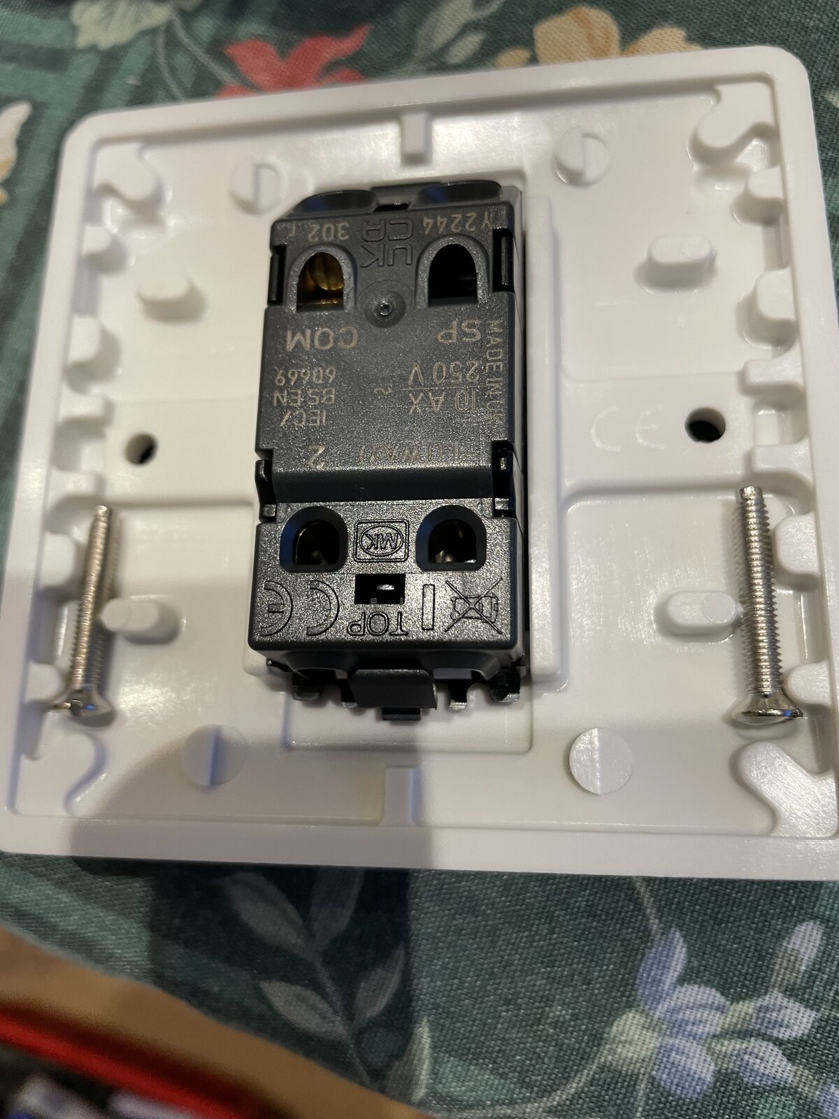

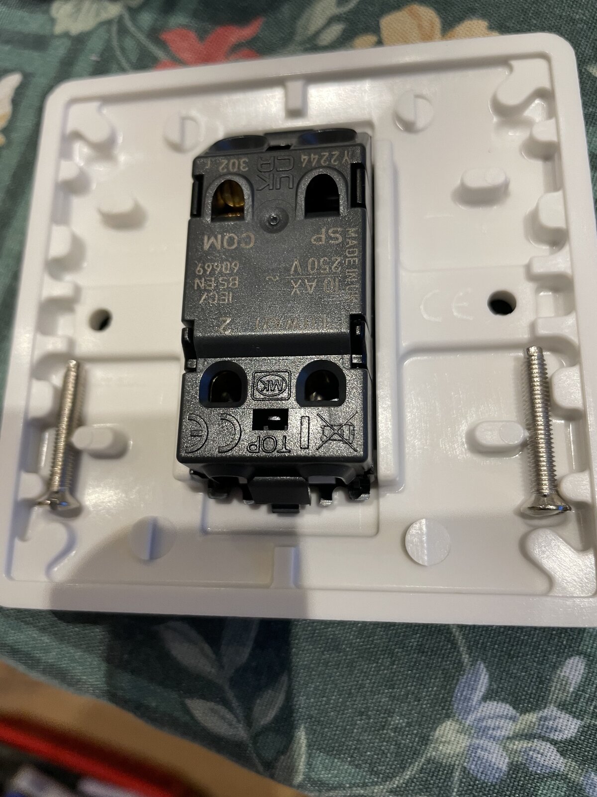

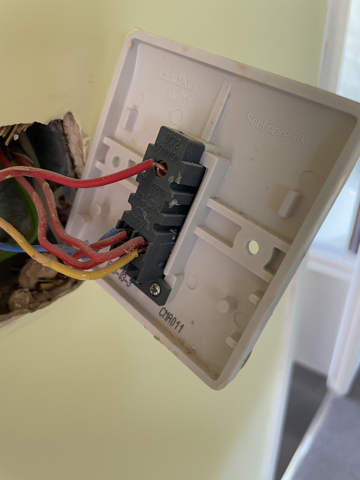

I need help please.
Is this straightforward changing this
The old one and the new one are in the pictures. Thanks.
Yes, just a straight swap across but just ignore the SP terminal on the new MK switch
Top single red into the COM terminal and then move the others across. You should be able to do it one terminal at a time to avoid any mistakes.
To be on the safe side, mark the red that is in COM. It doesn't matter which way round the other two go.
