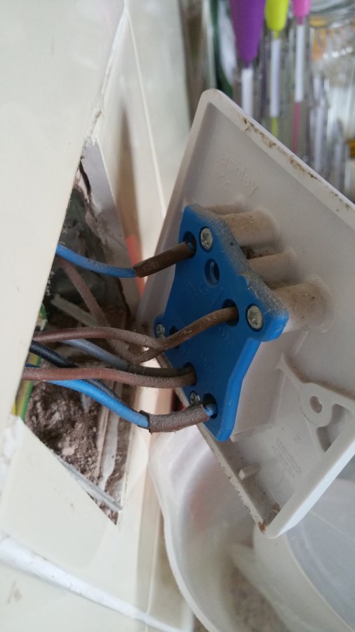

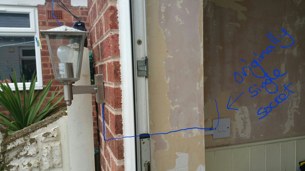

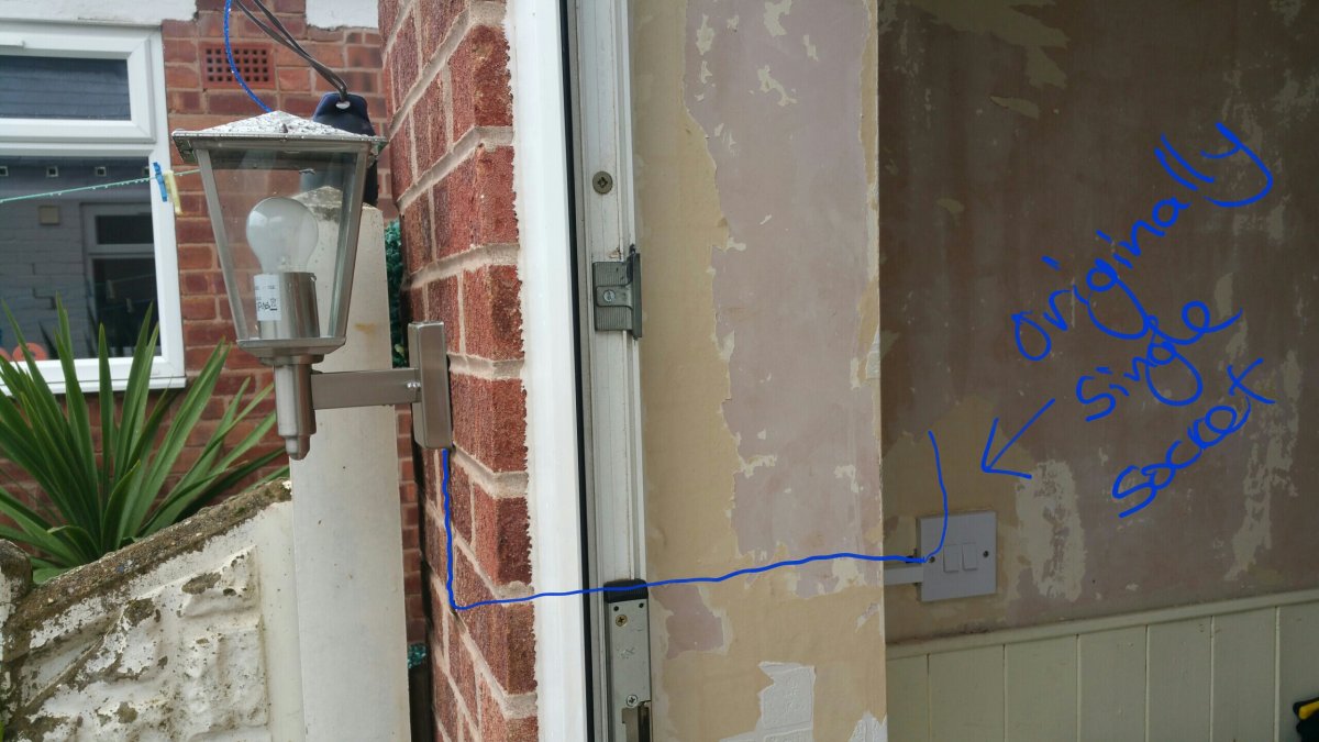

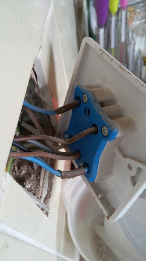

Below is a picture of the outside light and the wiring i have installed. The new wire gas the usual blue, brown and earth.
I have connected the earth but cannot see another earth already connected.
Below is also a picture of the other double socket which power both of the sets of lights in the kitchen. This one does have blue wires in it.View attachment 104088 View attachment 104089
Given the fact that you are obviously re decorating :LOL: run a cable from lighting circuit ( possibly the existing ceiling light). And let rid if that bloody trunking ! and please use earth sleeving ! Do it right ……… :)
