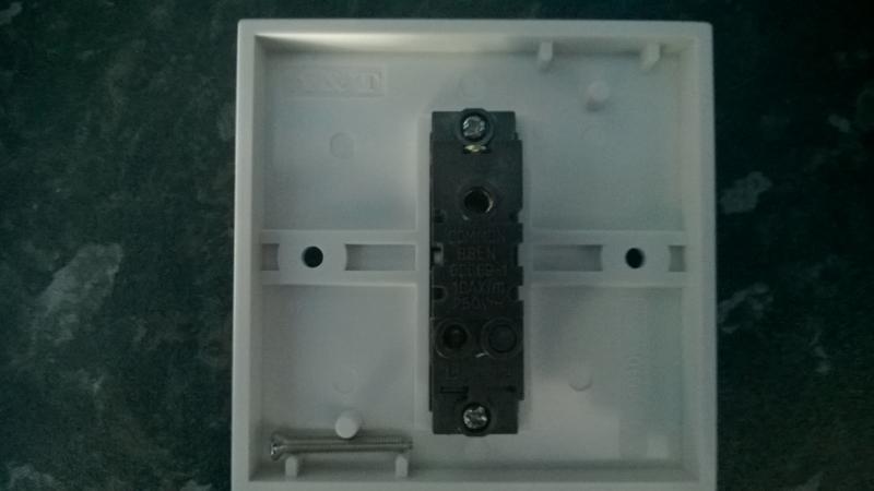

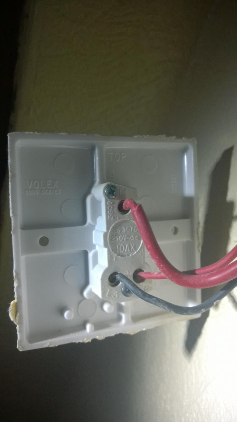

hi there just need small advise please, went to old man house today as he said a light switch is broken, but on the old one there three connection, L1,L2,L3, but the new one I bought today has only L1 connection L2 there nothing there and one un named could you tell which one I use or I need another type any help much appreciated thanks

What wires were connected to which terminals? Can you post a photo?

Most likely is as follows:
OLD NEW
L1 unmarked/COM/C
L2 L1
L3 L2
No harm will occur if they are connected incorrectly, they just won't work as expected.
You have the wrong switch - the new one is a 1 way, you need a 2 way.
The new one appears to have 3 terminals to me - the photo is so dark that I can't see if there is actually metal in all 3 though. If not, then as you say, it's the wrong type of switch.
The red sleeved wire goes into Com or unmarked top terminal on your photo.
The black goes into the left terminal on your photo and the red into the right terminal on your photo.
When you get a new switch, it will most likely be marked "C"or "COM", L1 and L2. Most likely connection is as in my earlier post (now edited).
Andy, please look again at your new switch.
I have looked at the pic (zoomin) in your album and I can clearly see a copper sleeve and a terminating screw in the single connection at the top of the switch?
Yes.
I don't think anybody has tried to claim that there isn't one there. What's missing, it seems, is an L2.
