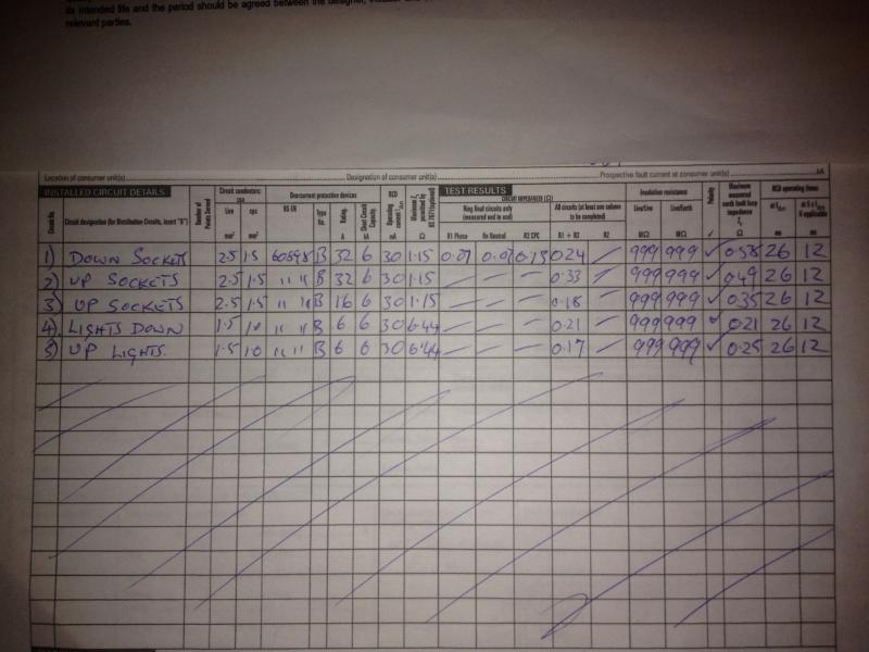

The board was left uninstalled with the house, and the electrician was happy to fit it, but we didn't realise it wasn't to standard.
I've uploaded the photos of the board and the certificates he left.
In your opinion, should the board have been installed and is there any overseeing organisation who we can complain to as we feel we've been ripped off? http://media.diynot.com/198000_1979...ot.com/198000_197924_54314_87166852_thumb.jpg

More to follow I'm sure as I browse the EIC
Maybe it's the only BS number he knows as aparrently the main switch is a BSEN 60898 device too (which it clearly isn't!)
The 'test' results on those certificates are worthless.
Some obvious and blatant errors:

Ring circuit measurements are implausibly low.
Upstairs sockets not a ring, yet using 2.5mm cable on a 32A device.
Lights recorded as both 6A breakers, yet clearly one of them is a 10A. (Maybe is was replaced later on - but why?)
Loop impedance measurements are all lies.
999 M ohms for everything seems unlikely - and which instrument would give such readings? Flukes only go up to 500, and many others only to 199 or 200.
