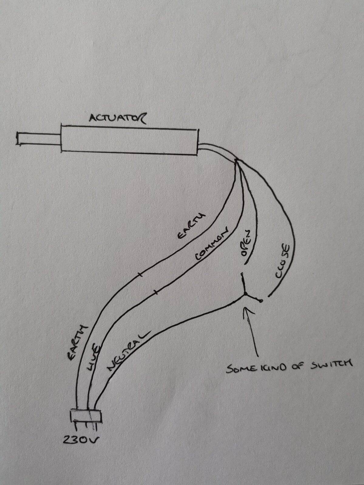

Thought this might be a good place to ask this. I'm building a scissor lift for my garage, capable of lifting 200kg ish. I bought a 24v hydraulic pump and was going to buy a ram and pendant remote. However I've just come across an electric linear actuator capable of lifting 300Kg. Its a gate opener but should work. It will be much neater, quieter, lighter, cheaper and hopefully less hassle.
I've seen how to wire up an actuator with 2 wires to a rocker switch but the actuator I'm looking at has 4 wires. I'm trying to get my head around the 'common' wire.
Is this diagram below how the actuator would be wired up or am I nowhere near?

Does it not come with any instructions?
I’d imagine the common wire will connect to your neutral supply wire, and you will need a two way centre off retractive switch to operate it. Something like this https://www.tlc-direct.co.uk/Products/MKK4900.html (plus a grid frame, plate and backbox) should be ok.
Does the ram have inbuilt travel limits? If not you’ll need to think about how you stop the ram being powered when it reaches the end of its travel to avoid damaging or burning out the motor.
Gate actuators usually have an external capacitor connected between the 'open' and 'close' wires, common is neutral, and line is connected to either open or close depending on the action required.

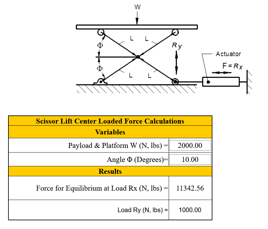

A 2000N load, with the scissor arm in the closed position (i've gone for 10 degrees), needs a force of over 11000 newtons, just to stay in equilibrium, let alone raise anything.
Your gate closer won't cut it, sorry.
Thanks for the replys.
So Is the common wire always neutral in all applications? Or do you need the wiring diagram to figure out which wire is the common?
There are instructions but they are terrible and show no wiring at all.

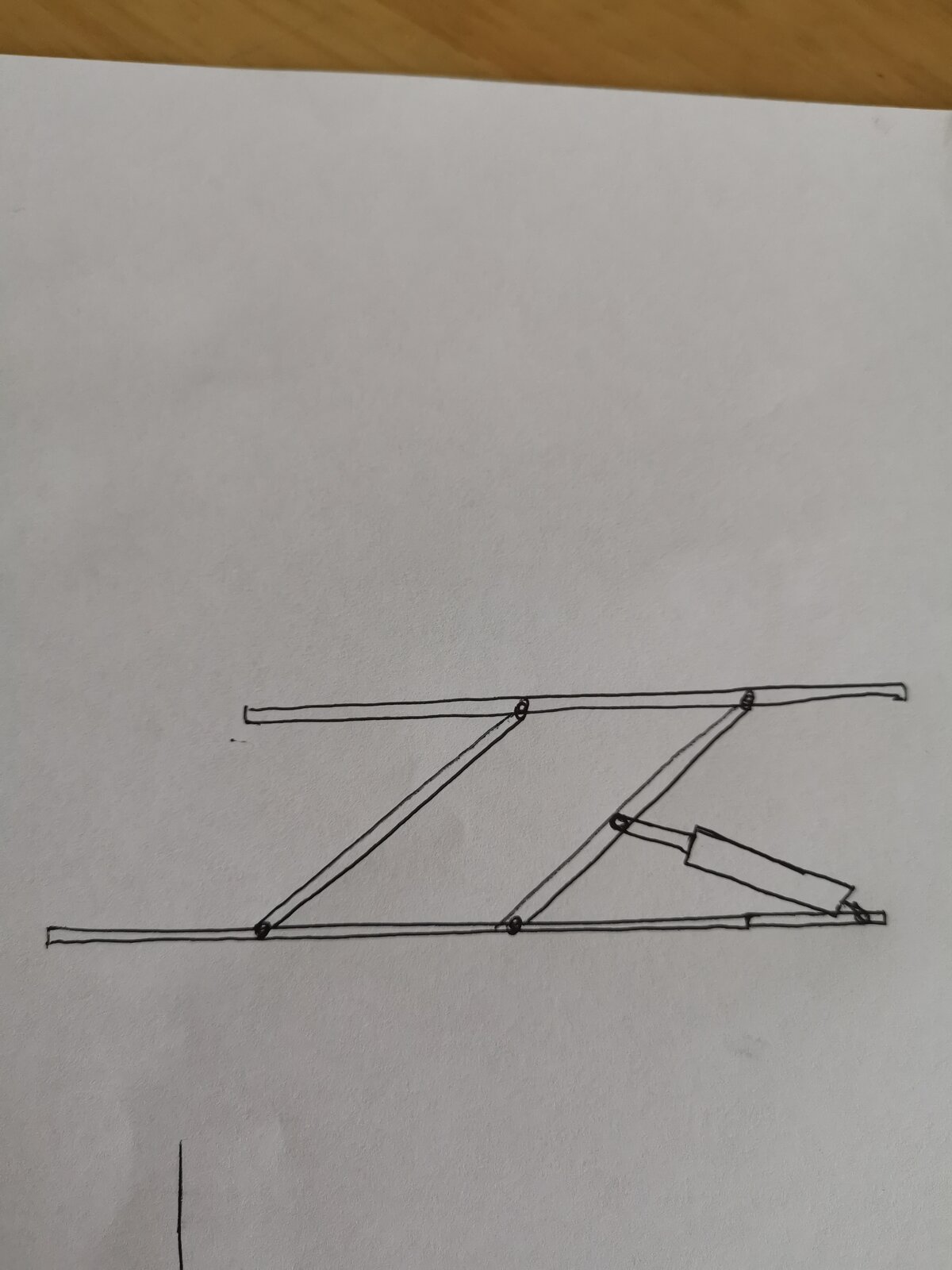

Rsgaz, thanks that's good to know before I go down that route. Do you have a program for calculating forces? What if I connected the ram like this picture and didn't do a scissor lift? IMG_20200708_082428.jpg

You're going to be much better off either buying a motorcycle lift or redesigning your scissor lift so the lifting effort is provided by a trolley jack or similar (a very clever local chap built us a piano lift working on similar principles so we could get a 6' Steinway onto 3' staging. Top of the instruction sheet - NEVER GO UNDER THE PIANO WHEN THE LIFT IS HOLDING IT).
EDIT Just buy a lift if you're asking strangers on a web site to design it for you. Either design (scissor or trapezoid) will involve substantial loadings at pivots and energy input points. Have a look at motorcycle lifts & see how chunky those key sectiond are
A Chinese motorcycle lift is the way to go.
Either hydraulic using a jack, or screwjack if you have a motor.
