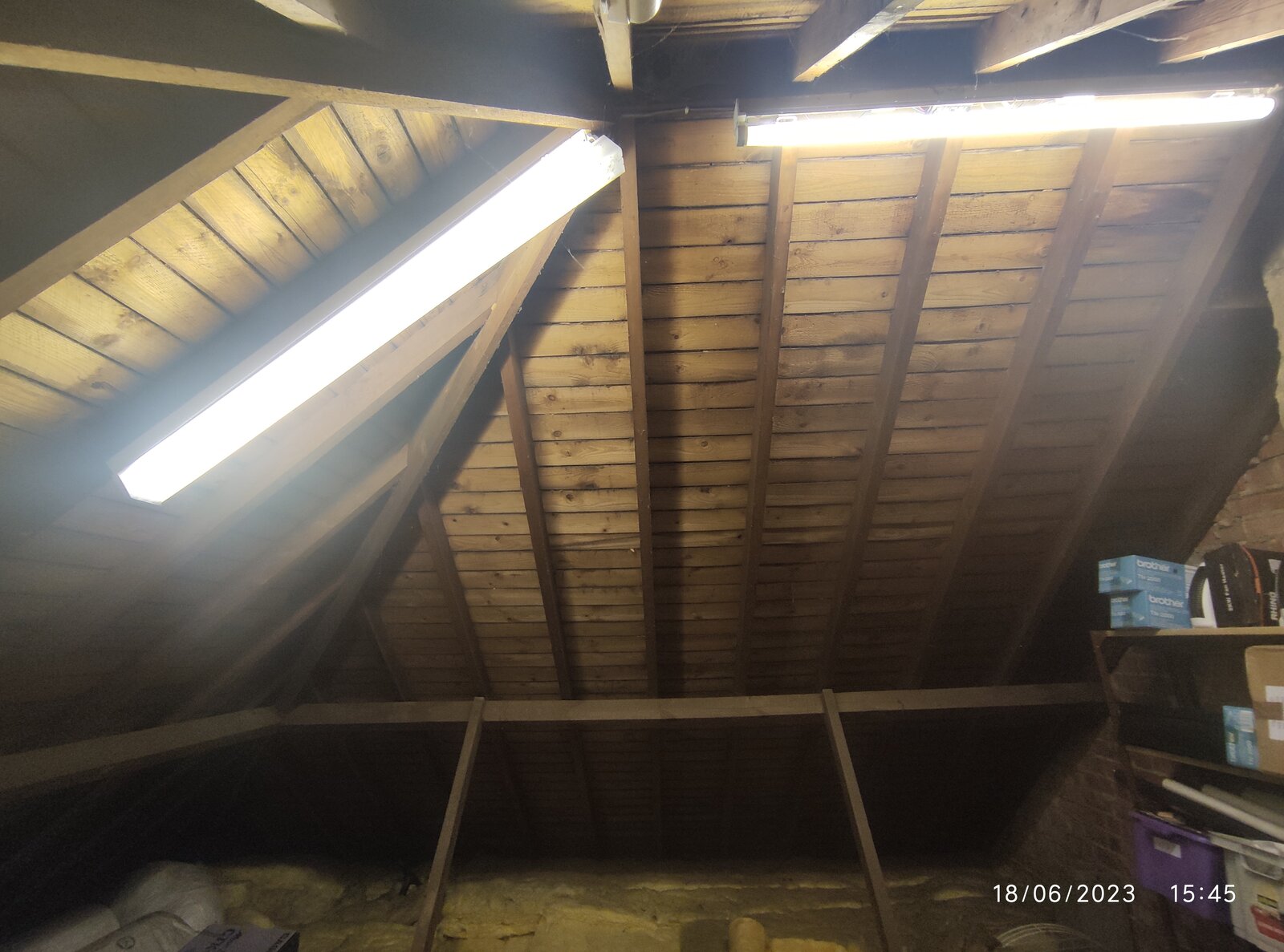

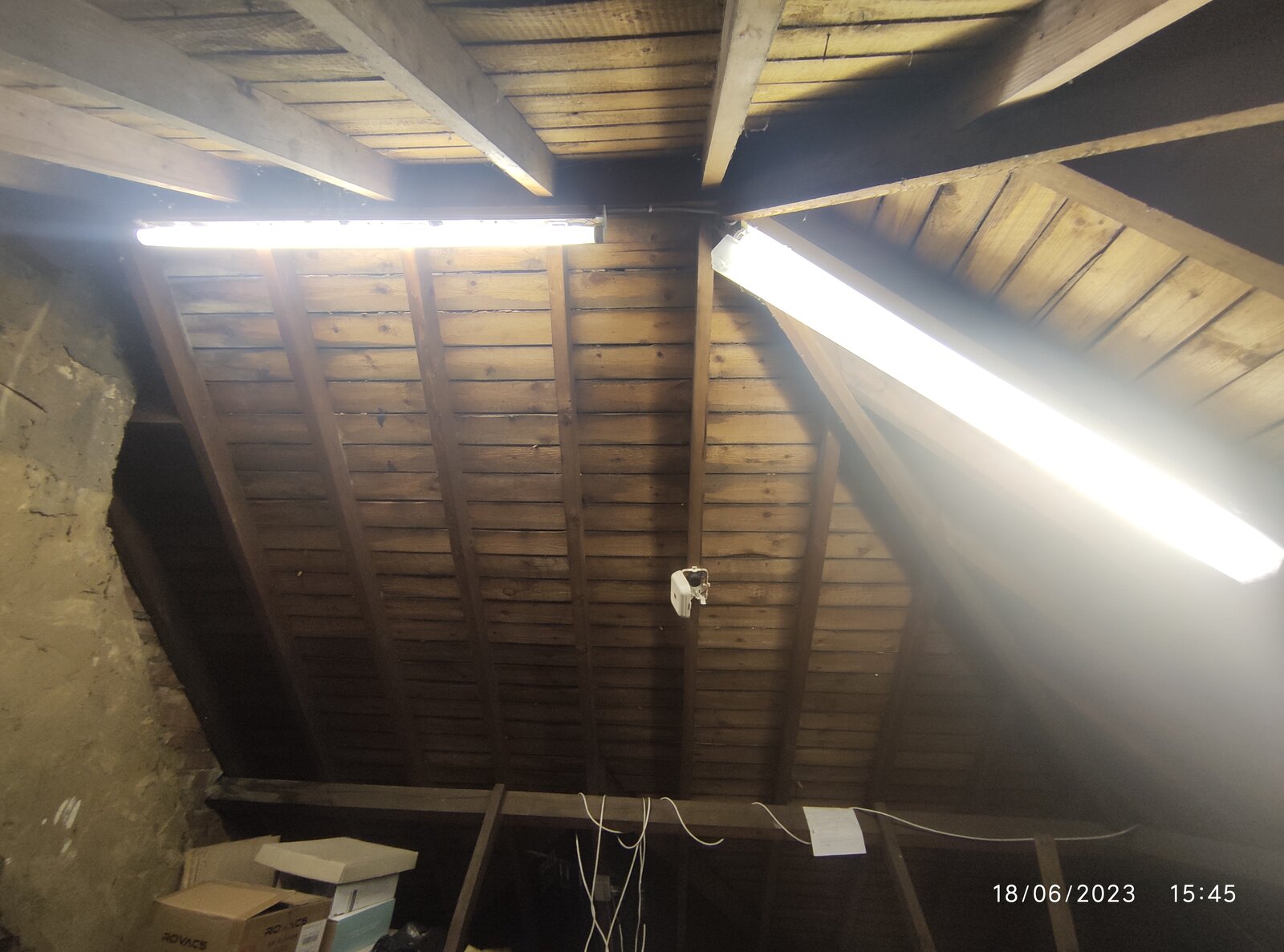

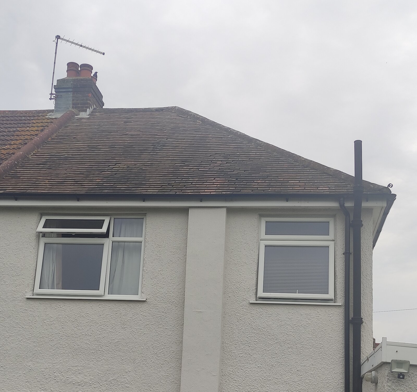

My Dad's getting free solar panels installed, so the installers have got to setup the scaffolding for that. They've said that if there's a few tiles that need replacing they'll do that whilst they're up there.
He also wants to fit some internal lining in the loft to stop dirt getting in and also to stop it getting so hot in summer and cold in winter, so I was wondering whether it would be sensible to have someone ready to do that whilst the scaffolding is in place in case they need external access, or is there no chance of that being necessary and we can just wait and get it done any time, or just do it ourselves?
I've attached some photos showing the roof at the back where the solar panels will be going and inside the loft. There's some sort of wooden cladding on the inside of the roof, so the tiles aren't visible. Would foil lining be OK, or should we use a breathable membrane? Do you just staple it to the inside edges of the rafters?
Those look like sarking boards - common in Scotland and some parts of northern England because they help make the roof more weather tight and warmer. The felt or membrane is nailed onto the outside of those then the battens (slate/tile laths), then the tiles.
I'd probably insulate between the battens with a 50mm air gap between the top of the insulation and the sarking boards. Staple chicken wire, or even just strings across the joists to keep it in place.
Any membrane goes beneath this, but if you seal the inside of the roof with a foil lining will there be sufficient ventilation to allow any moisture build up to escape?

Thanks. We live in Surrey/Greater London so I guess it's not so common down here. If there was felt/membrane on the other side though, wouldn't that stop the dirt getting in already?
Yeah, I'm concerned about whether it's safe to use a foil lining or whether we need to use a breathable membrane instead, or just no lining and rely on the sheep's wool or rockwool insulation to act as a barrier to stop dirt getting in, but I'm not sure that would work as the insulation is breathable. I don't know if a breathable membrane behind breathable insulation would be any better though. What do installers do to allow sufficient ventilation with loft conversions, where they insulate between the rafters and then cover it all with plasterboard?

If the house was built in the coal fired period (prior to the 1970s) there will be a lot of soot and general grubiness in the attic already. Add to that lime mortar and/or lime plaster and decades of human habitation and there will be all sorts in your attic already

Yeah I guess, but a lot of that old dirt should be under the insulation and floorboards we've fitted, so the fact that stuff is still getting covered in dirt suggests that new dirt is coming in from outside.
I don't want to waste money fitting a lining if there's already one under the sarking, but I need to be sure because if there isn't one there already we should probably fit one before fitting the insulation. I guess if the solar panel installers need to replace any tiles, they'll be able to see if there's a lining there already.
On a previous house we had to have vent tiles installed. On some of the builds I've worked on they just went for air space, mineral wool, plasterboard then plaster skim
I guess it's less likely to be a problem if we're not planning to cover the insulation with plasterboard, as long as we leave an air gap between the insulation and the sarking and use a breathable membrane rather than foil for any lining.

I was once a big fan of PIR, but having seen it shrink, these days I'd probably full fill the cavity between the rafters with wool, go over the rafters with foil faced PIR, tape the joints and board over. Moisture would be dealt with via an MVHR
If it wasn't being turned into a habitable room I wouldn't do any of it, just staple breathable felt up to catch dirt if that was a concern

Given the stated complaints, for the dust n dirt issue I would buy a roll of roofing felt and staple it to the underside of the rafters (Not pulled tight, then wedge the felt open at the overlaps with short sticks. Work top down) and insulate the floor well
This will stop stuff getting quite so covered in crap, leave gaps in the felt for ventilation, and keep the insulation close to the warm envelope of the house that is actively used.
