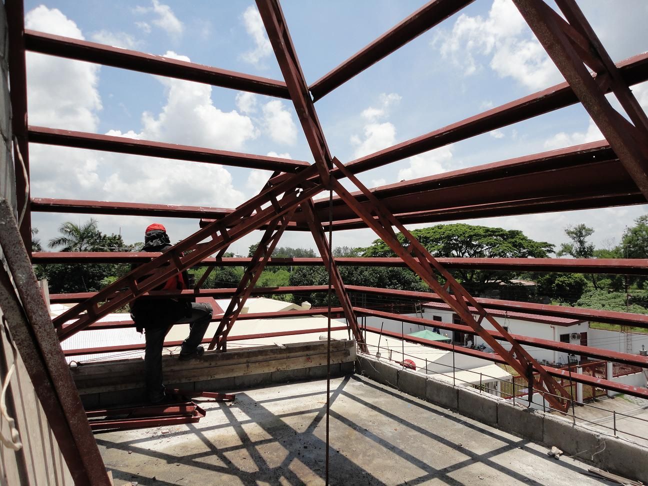

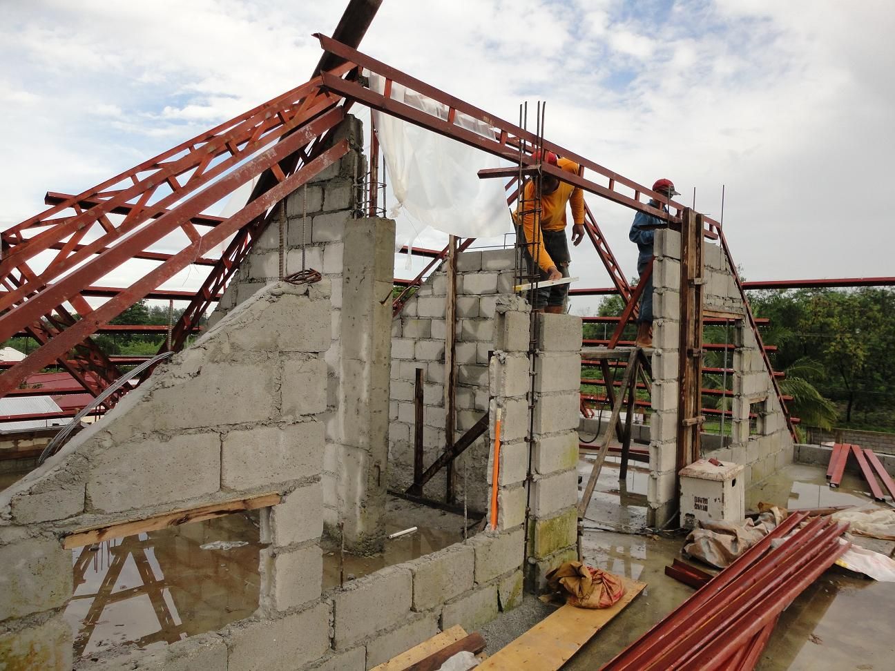

Lining out a steel framed loft, not the floor, the sides.
13 Jun 2007
69
2
We're building a house, and the roof is to be tile-effect steel sheeting on an angle iron truss steel frame.
I'd like to line it out with 3/8" plywood sheet, varnished and made to look pretty, as it will be used for living space/tv room/bedrooms maybe.
So, any suggestions how to do it? It is a bit of a convoluted awkward shape, so should I secure wooden battens and screw the plywood to that. Or is there a better way?
It is not in the UK, so no worry about planning permission, 'code', damp, snow, frost etc. :D
This will be the overall shape of the final roof, apart from the flat bit on the top is now pitched.
