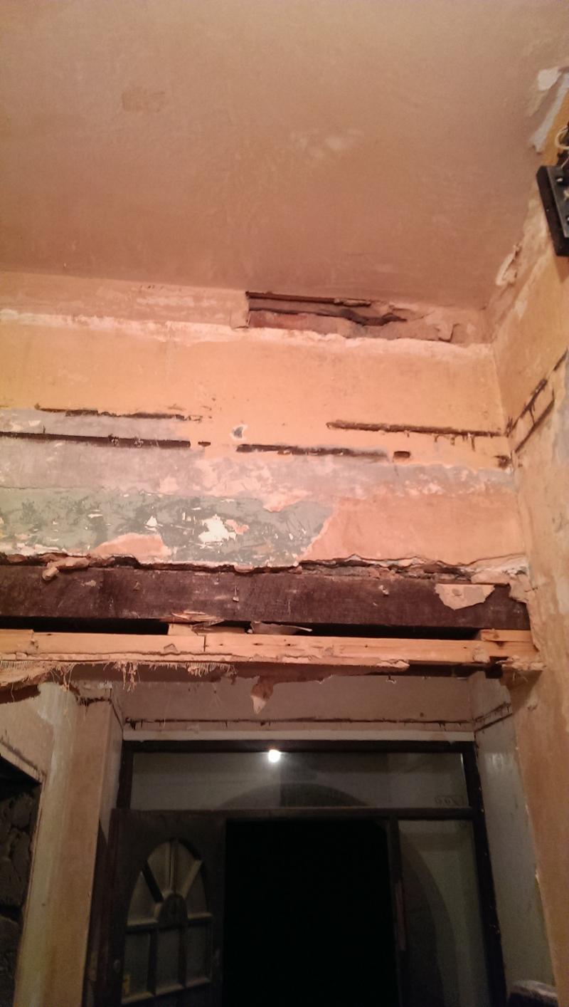

Finally got around to taking a look at this and started having a proper look at what is currently there.
From the bottom up, there is an old head of a door frame, some packers then a wooden beam (110mm wide X 75mm high) a few courses of brick then the wall plate that is carrying the joists above
Exposed view

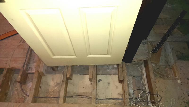

Upstairs
Builders yard down the road didnt like the idea of a trimmer and reckoned steel or a pre-stressed head would be better but visible.
Given that the current wooden beam is taking the load of joists and brick (is load reduced due to the knitting of the brick?) any reason i couldnt re-use the same beam higher up to carry just the wall plate or use it as a trimmer?
If using as a trimmer i would be turning it on its side so that it would be 75mm wide by 110mm high as this would match a doubled up joist and give a stiffer profile.
Cheers Neil
Re-using the timber beam you have will be fine, especially turned on its side. And yes, the bonding of the brickwork at the sides helps to reduce the load on the beam.
