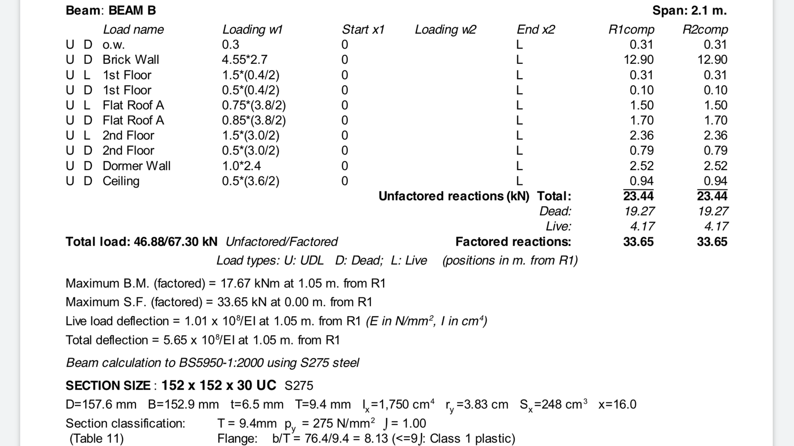

My SE has specified a steel beam 152x152x30 with 10mm plate welded to top and bottom flange. This is support a clear span of 1.8m for a patio door. In their calculations, they said the load on each bearing is 33.8kN so total load is 67.6kN.
From what l have tried to understand about how to calculate load on lintels, this seems very high. There is a window direct above the opening on the 1st floor and dormer loft above that. It’s a normal cavity wall.
Reason I am doubting all their calculations is because they also specify a steel beam 178x102x19 for a 1st floor lintel to support an opening of 1.9m. Here the load given is only 10kN so don’t understand why a concrete lintel would not suffice.
Before I go back to them (as they are slow at answering), I just wanted to get a idea if my concerns are valid or not.

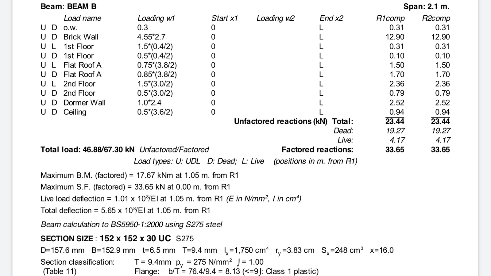

I got the structural calculations for the lintel. Can anyone tell me if there is anything wrong with the figures used?
I don’t know why they used a calculation of 4.55x2.7 for the bricks.
I did ask the “engineer” to check but they insist it is the correct beam size for the clear span of 1.8m.

The 4.55 x 2.7 = (load of wall in kN/m2 x height of wall in m) to give the load in kN per meter run (all the loads are worked out in kN/m run).
There will be some torsion on the beam due to the outer skin being supported off the bottom plate and offset from the centreline of the beam. This will add some additional bending moment to the beam.
They could have reduced the floor live loads by 10% to 1.35kN, which is an allowable reduction for two floors, but that would not make much difference to the final load. Also, they could have worked on the clear span of 1.8m, instead of what looks like a span of 2.1m.
But looking at the overall loads, I'd say the choice of section is not unreasonable. Maybe a 152 x 152 x 23 would have done, but cost-wise hardly much less.
They seem to calculate based on the length of the beam rather clear span. Also, why does the 45 degree triangle of load not apply here? Instead they have used the load of the full column of bricks.

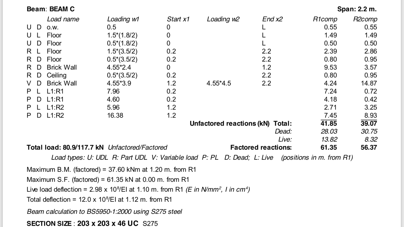

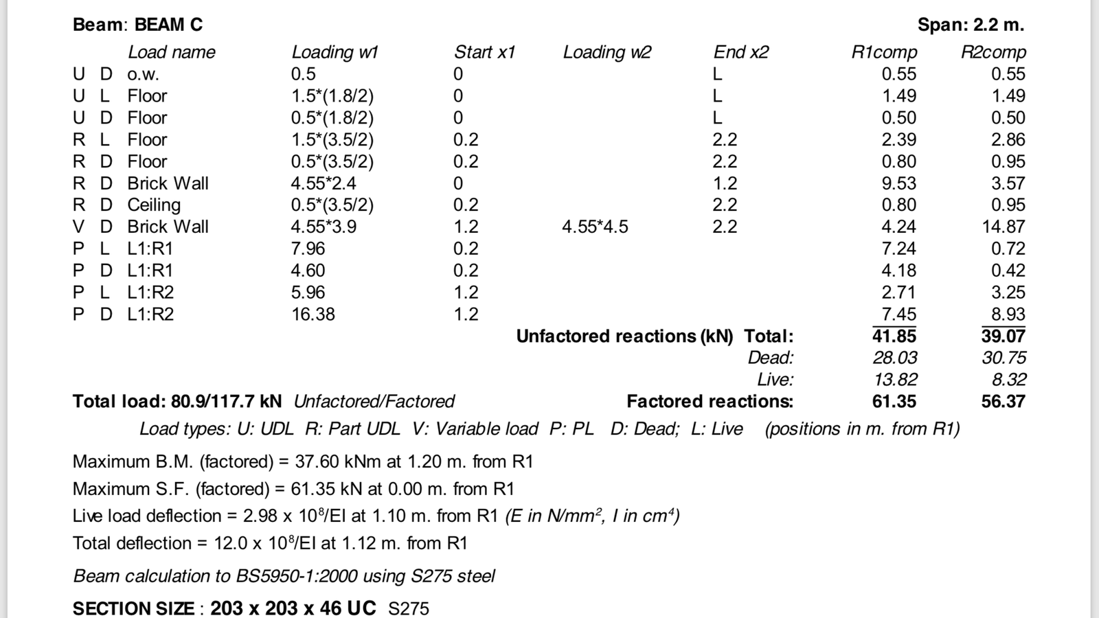

We want to widen the old entrance by 30cm to 1.2m clear span. They have specify a beam of 203x203x46 with length of 2.2m. They said this is due to point load from a beam directly above in the loft floor and need the longer length to spread the load. I have attached the calculations for this beam which has an even high load on it (118kn).
Is it worth paying another engineer to calculate the beam for these openings?
Yes, their maximum bending moment has been calculated for a span of 2.1m. Working on a 1.8m span, the bending moment comes down to just under 13kNm.
They will then also have over-calculated the deflection by around 40%, having regard to the reduced span and load.
If there is no window over the beam, you can allow for the arching effect of the brickwork, particularly on the outer skin, which will reduce the torsion on the beam.
Looking at this again, you might possibly get away with a 178 x 102 + welded plate, but at the end of the day, there might not be much cost difference between that and what they have specified - some of the cost will be taken up by the welding of the plate.
They allow a bearing length of 50cm. If the inner skin is celcon or similar, this then implies that they are assuming that all the load is going on just the inner skin, which can't be right?
And worse than that - as with the previous beam - they've worked on a clear span of 2.2m instead of 1.2m, which makes a huge difference to the bending moment and deflection. No wonder they computed such a high load (118kN) which would be difficut to achieve on a 1.2m span in a domestic setting, even allowing for an incoming point load.
Frankly, all this is just a rookie design.
