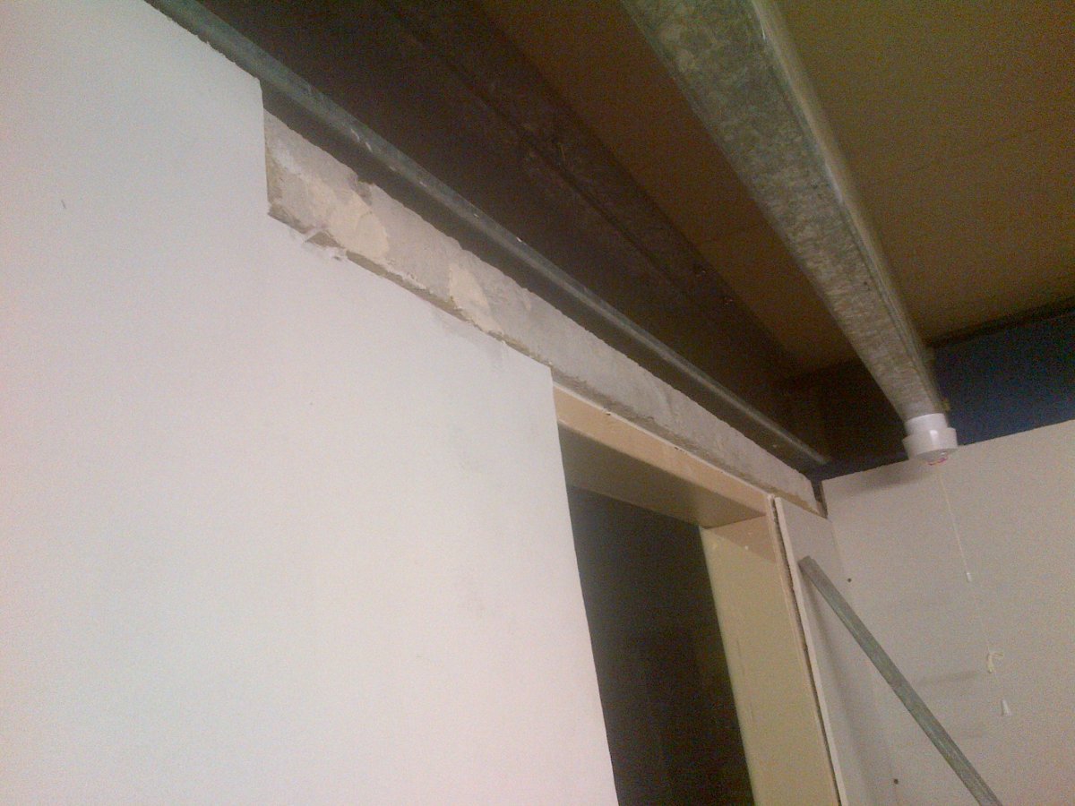

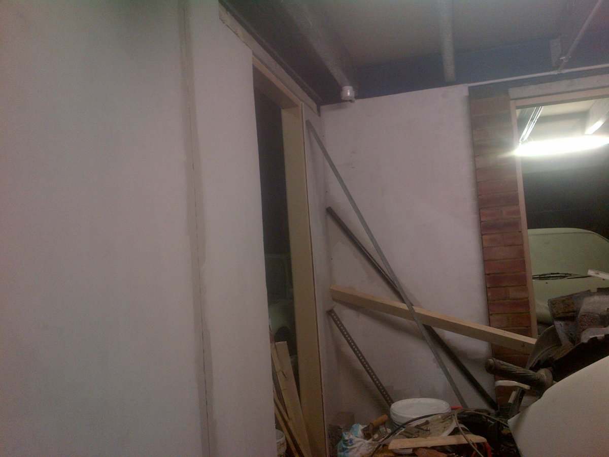

The lintels ive used seem to be slightly wider than the blocks which is normal from past experience. However im trying to fit plasterboard using dot n dab adhesive to either side of a block wall and the lintel is pushing it out at the top. Ive removed some of the plasterboard sheet to get round this problem but now im unsure about how to go about finishing this job? Just use filler to bring it out at the top?

nuzuki, good evening.
Many years ago, an Architect that was at that time really switched on told me if you screw something up? make a feature of it???
How about you consider fixing the main wall Plasterboard as normal right up to the protruding lintels, then fix a further layer of plasterboard on to the lintel ? in effect plating out the lintel proud of the overall wall surface? BUT? it may appear better if you extend the lintel plating over the full length of the affected walls. OR?? make a feature of the plating around the entire room??
Now, if you use two [or more] thicknesses of plasterboard as plating [to the protruding Lintels] you could consider fixing timber shaped beading on the underside of the plating at its junction with the main wall. and again at the junction of Plating and ceiling??
In effect a feature, a Homage to bygone Fibrous plaster cornicing?
Just a consideration?
Ken

Hi Ken,
Sorry only just seen your reply. I was thinking of making a lintel fascia out of some wood and staining/varnishing it to make a nice feature as you say. Ive got another room to do which I think may also have this problem so I shall look around my scrap wood pile and see if I can make something good out of something bad. I was also thinking some coving or skirting board/architrave running around the top of the room might hide it. As the plasterboard is 9.5mm I may use some 5.5mm ply stuck on with no more nails to bring it out flush. Sometimes that gravel board sanded and stained can have a nice driftwood effect so I could go that way if wanting to make a feature out of it.
Anyhow thanks for your replies. I'll update when I decide what to do.
