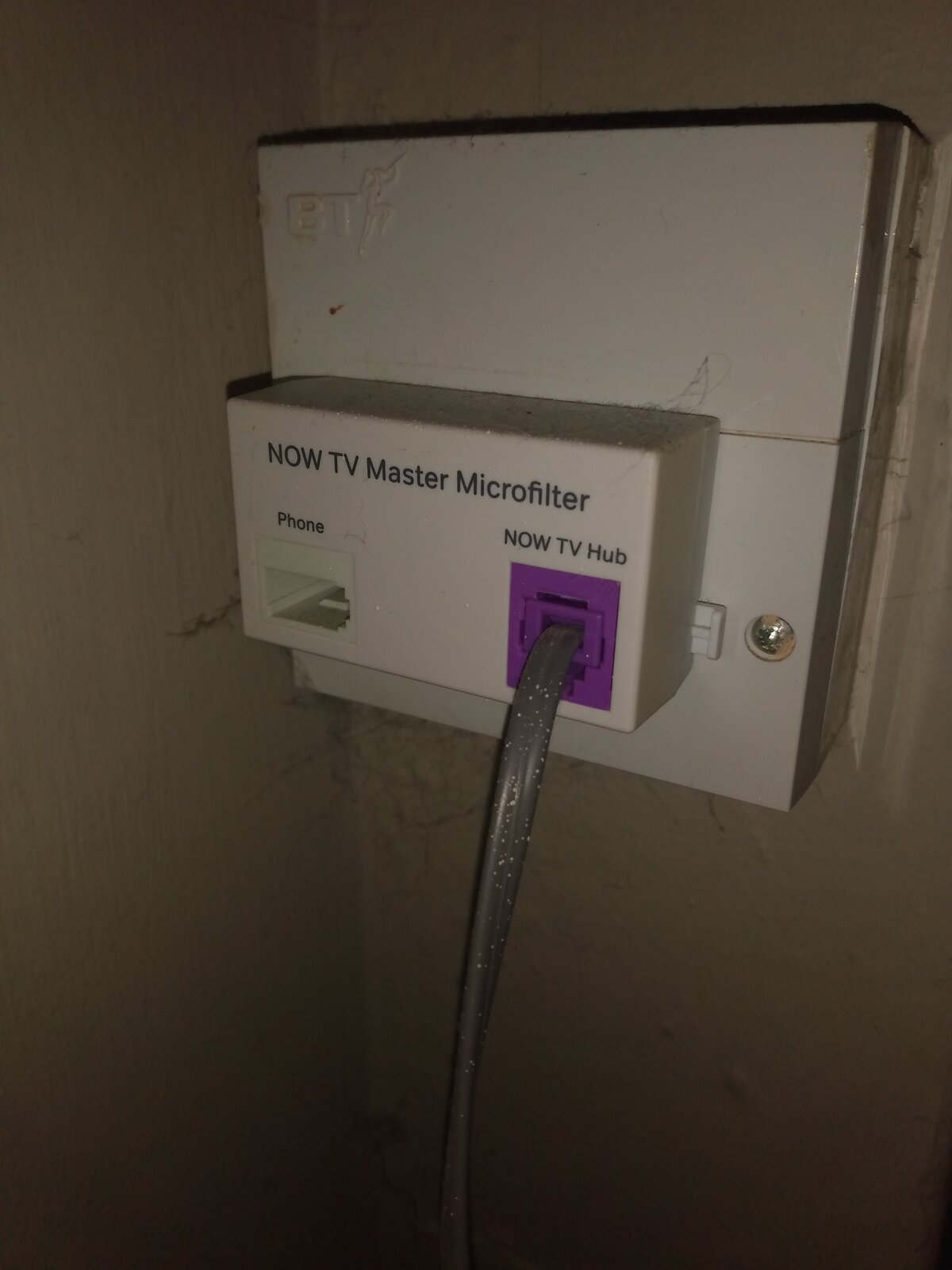

Hi all - can anyone help a complete novice?
Have just moved into a new house but can't see any aerial outlet in the sitting room, even though the house has a big antenna on the side. There is just an ethernet outlet with a "NOW TV Master Microfilter" attached.
We previously had the Freeview channels in our old flat, and thought we'd be able to just plug in our coaxial cable and go. Is there a way to get "live TV" when there's only an ethernet outlet, or are we stuck with "on demand" for now? The house was built in the 60s so I don't really understand what previous owners did without an aerial outlet in the pre-streaming days?
Any advice gratefully received!

Look at the roof and in the loft. Can you find an aerial? What shape is it?
(Edited)
A 1960s house might just possibly have been built with cable TV but more likely an aerial and co-ax, which might have been tacked to the outside wall and entered through holes drilled in window frames near the TV position. You might find marks on skirting boards where it was clipped. It was not normal to sink TV or phone cables into the wall until much later.
If the house has been renovated all traces may be gone.

I'm not sure about the NOW outlet.
But Freely TV is coming onto the market with more brands. This will provide Freeview type TV without an aerial but via ethernet.
May not suit you, but worth a look.
The Now outlet is merely a splitter to enable someone to attach a phone to one outlet and the internet router to the other.

He said there's an antenna on the side of house, @JTench maybe post a photo, you mean a traditional TV aerial? See if you can follow the cable and where it enters the house ....
A photo of this 'big antenna' on the dwelling would maybe assist. (Antenna is the correct technical term for satellite dishes as well as various other transmitting and receiving aerials.)
On buying / selling homes in England there is usually a 'property information form' that details stuff like utility suppliers and whether there is terrestrial and satellite antennas. Check your Solicitors packs... (they may say 'not known' under the relevant question, of course).
"Live" TV (delayed by the encoding and propagation via the internet) is available from some but not all broadcasters. Provided one has an internet service contract with a provider. "Now" is just one of many ISPs.
Do a proper and thorough search for coaxial cables and sockets in the dwelling. They may be hiding? Or of the F-socket variety which you may not be familiar with compared to the usual TV plug... especially if the antenna outside is a satellite dish.
