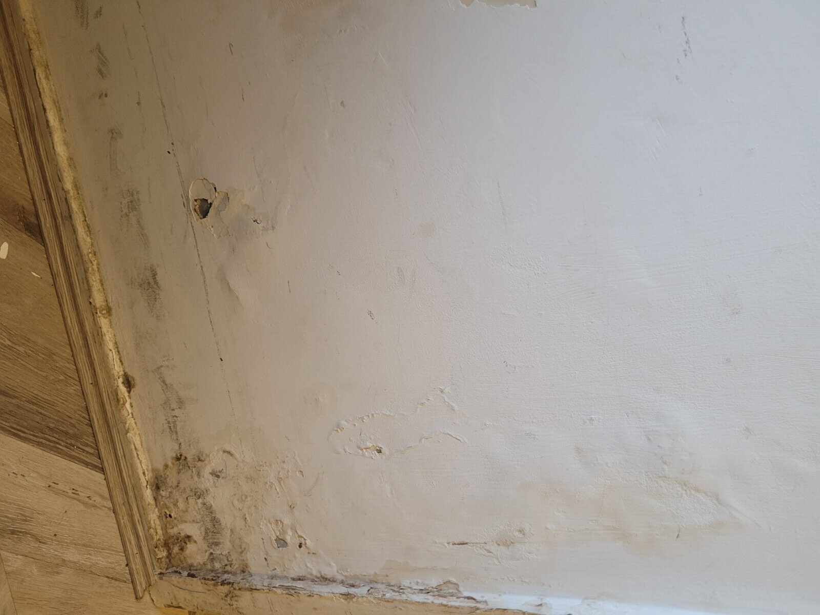

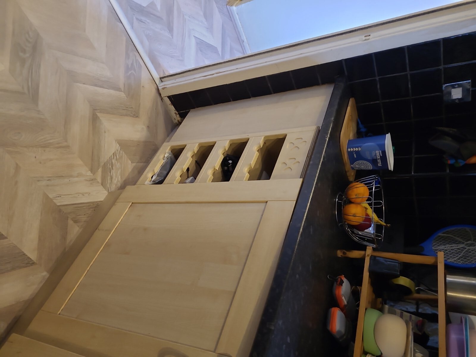

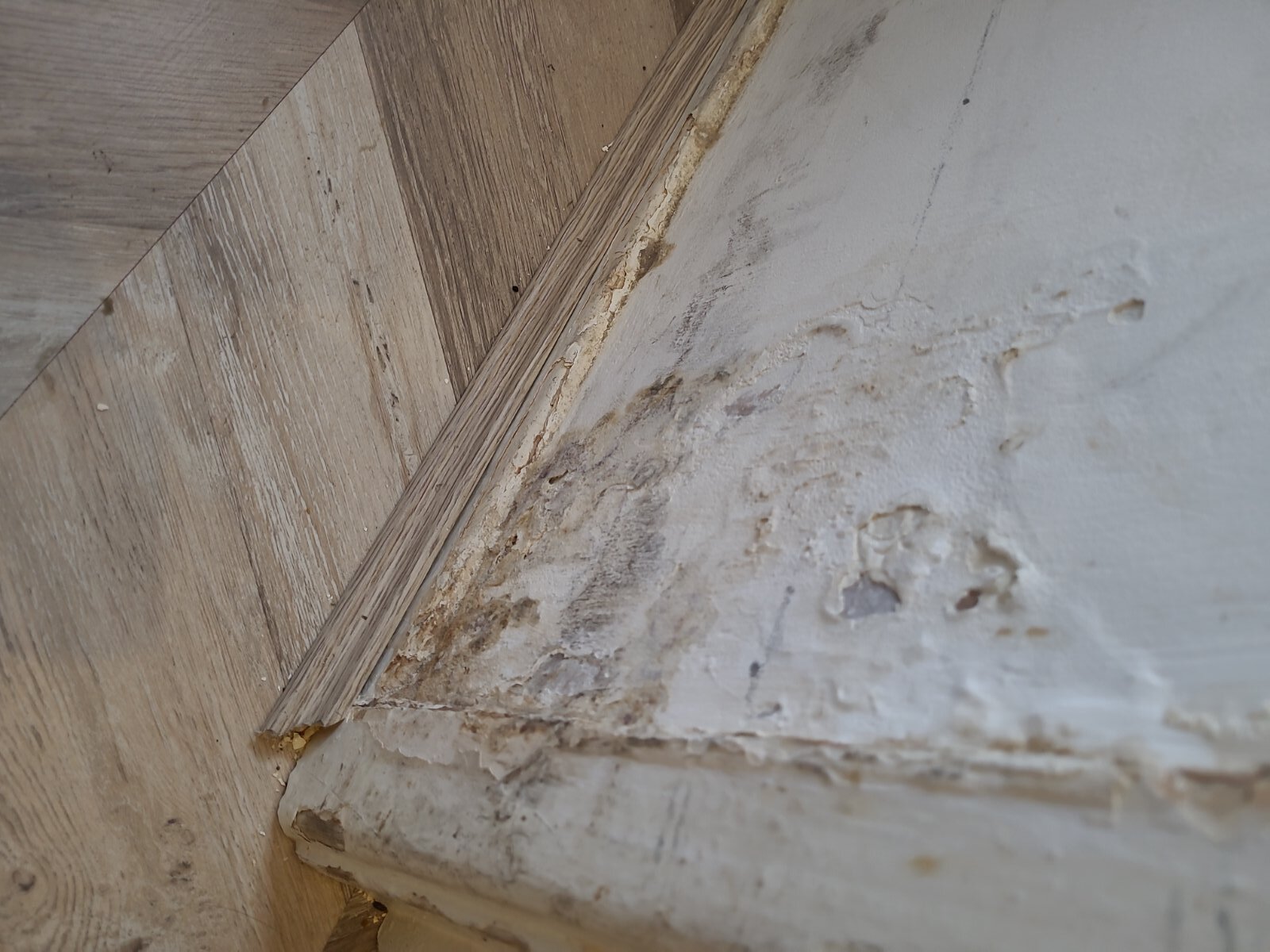

Hi all,
I’ve got a localised low-level damp / moisture patch on an internal wall near the front door / kitchen (photo attached).
No obvious leaks internally, house is otherwise dry. The patch hasn’t spread much but doesn’t fully dry out.
Before calling any damp companies, I’m trying to work out likely causes and what to check first. Possibilities I’m considering are:
– external ground levels bridging the DPC
– door threshold or seal letting water in
– external pointing / brickwork issues
– possible minor plumbing leak from the kitchen side
Any advice on first checks or simple fixes to rule things out would be appreciated.
Cheers.

You're not considering condensation then?
And hygroscopic plaster (salts absorbing air moisture)?
Stand back and take wider pics, of the whole wall, both sides, so we can see what's going on. Include watery items such as sinks, showers, washing machines, radiator pipes, kettles, water pipes

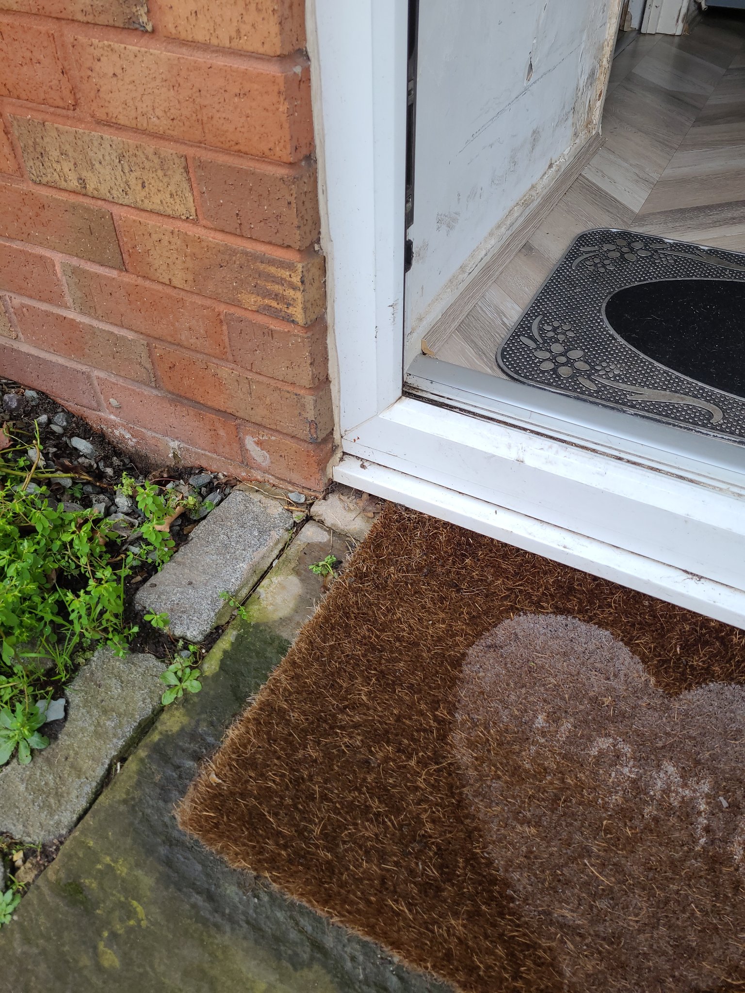

It is on the ground floor? Show the airbricks outside and their height above ground level. Show nearby drains, gullies, downpipes and manholes.
Is the floor wet?
Do not allow anybody who sells silicone injections into your home, even if they masquerade as a damp consultant

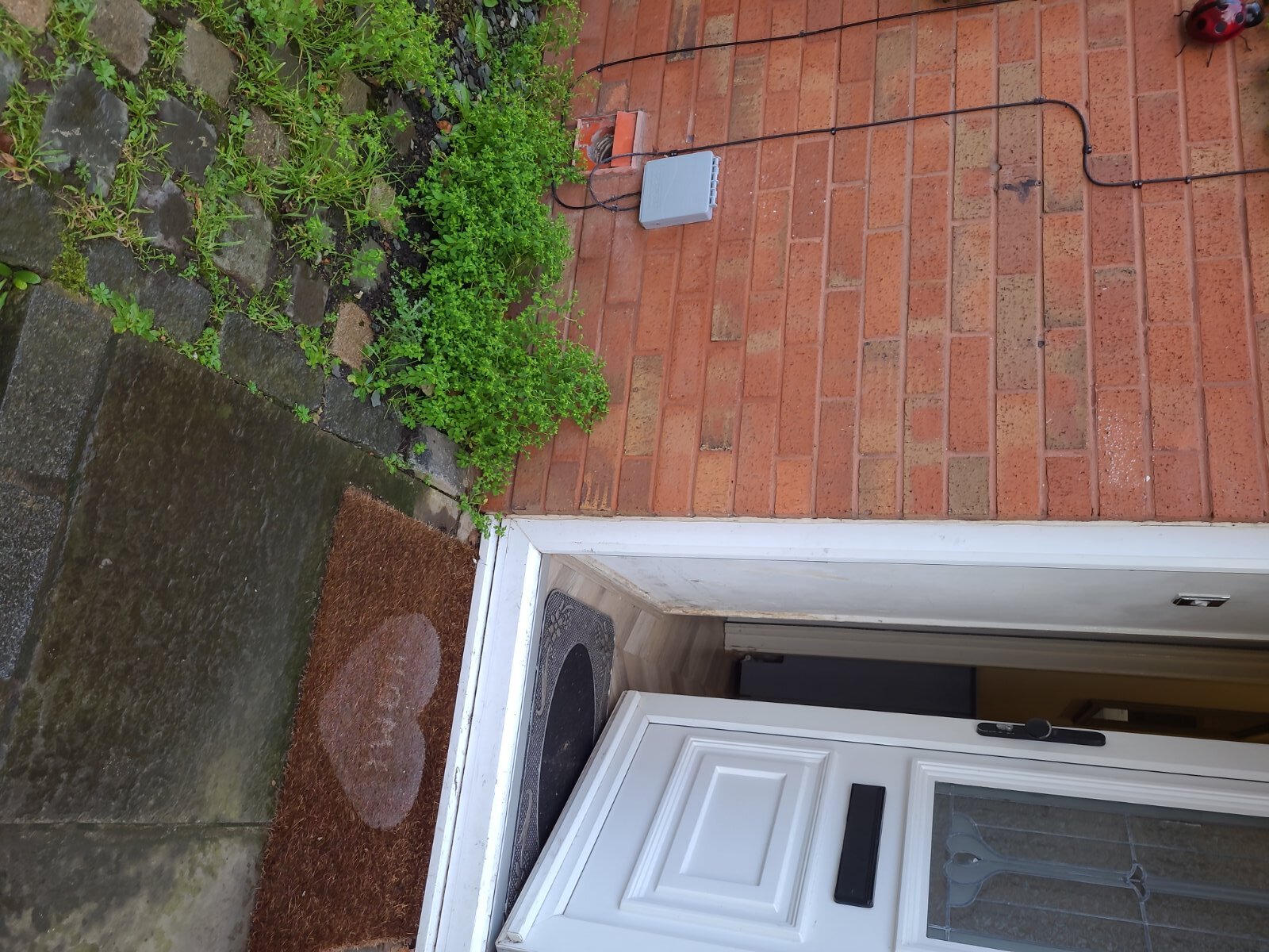

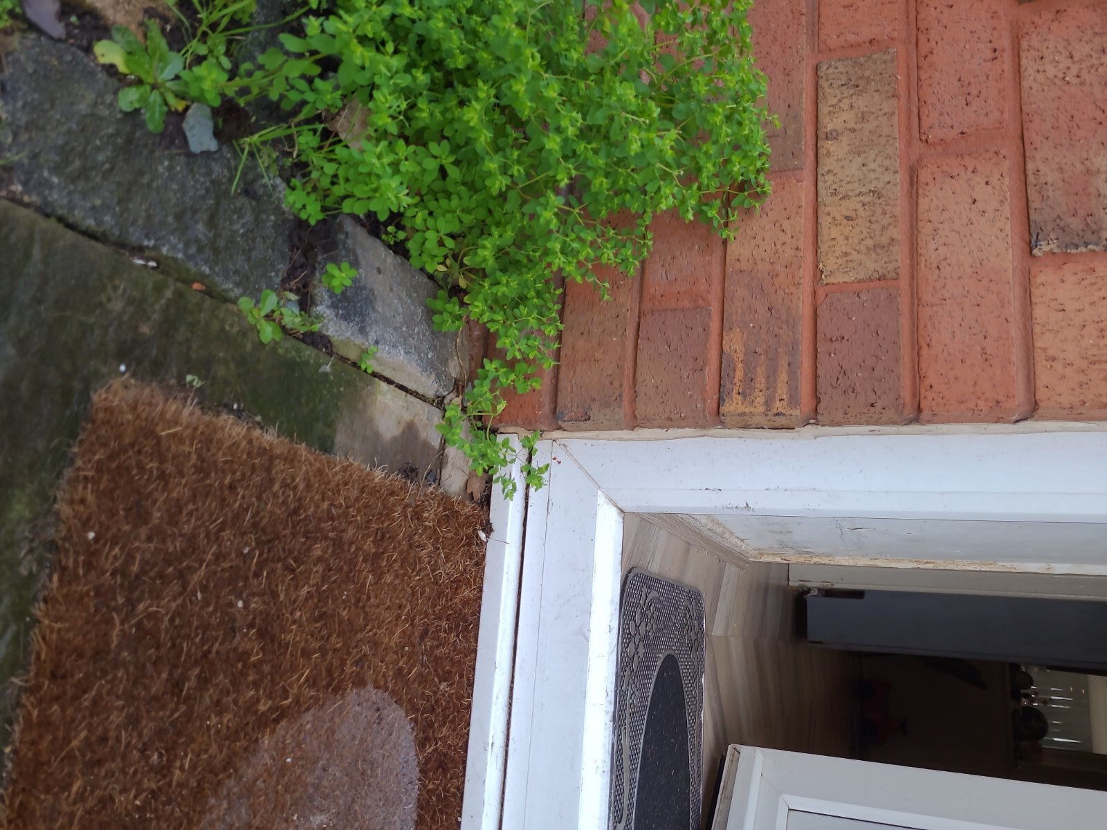

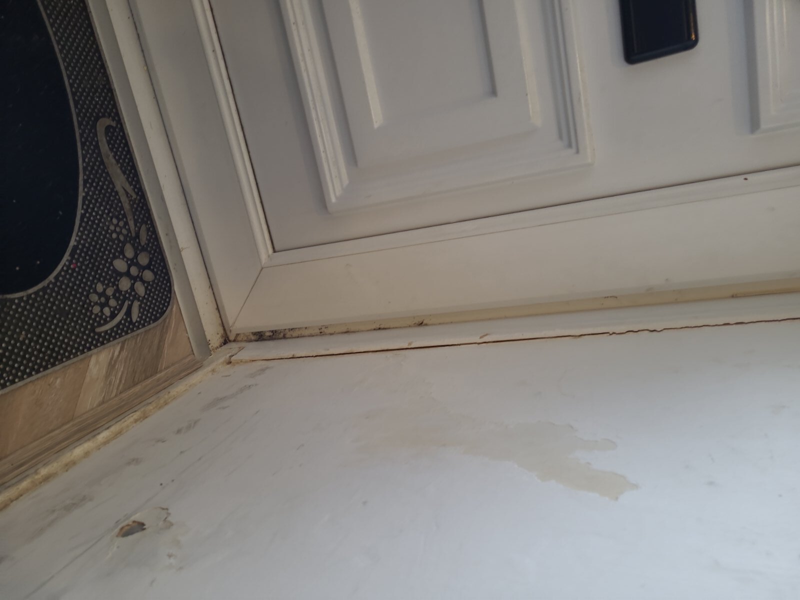

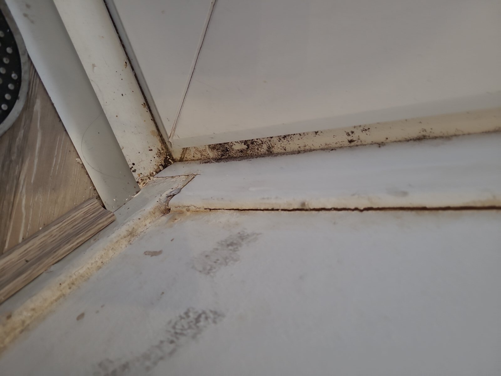

Thanks all for the replies so far.
Condensation was my initial thought, especially being close to the kitchen, but the patch is very localised, low-level and doesn’t really come and go with cooking or weather. The rest of the house is dry and well ventilated. The floor feels dry at the wall edge.
I’ve now added wider internal photos of the whole wall and both sides, plus external photos showing the door threshold, ground levels and surrounding area. There are no plumbing pipes, radiators or appliances directly behind this wall.
Someone suggested ingress at the door reveal / threshold or external ground levels being too close to internal floor height seems plausible, but happy to rule condensation or hygroscopic plaster out properly if I’m missing something.
Any thoughts on what to check or address first would be appreciated.

The ground level is much higher too high. Look for the DPC. You may need to pull back some earth in the flowerbed beside the door.

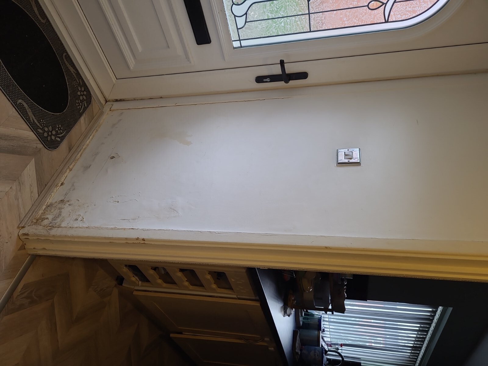

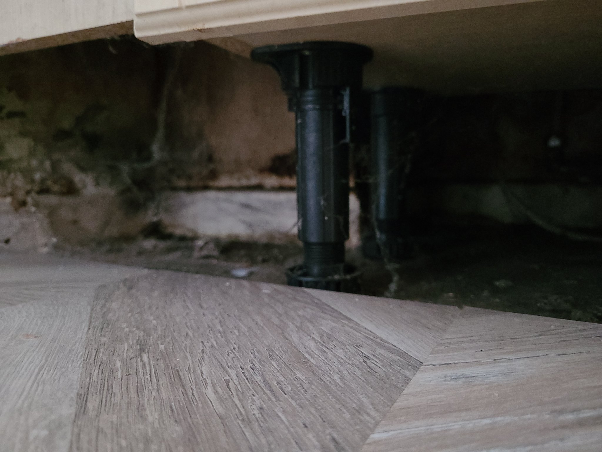

I think, on the other side of the wet wall is your kitchen unit. Take out the plinth. I expect you will find bad damp. Ventilate it.
Is there any part of the floor you can see or touch? It looks to be concrete covered in laminate.
Look at other parts of the kitchen walls and floor. It's possible for water to track unseen under floor coverings. A leak somewhere in a kitchen can saturate the whole floor.
I suspect the door /frame is leaking in the corner. Get the hosepipe out and test it.
Thanks for the advice. I’ve removed the kitchen plinth and the concrete floor behind the unit is dry, though the back of the wall shows localised damp. I’m pulling back and lowering the gravel outside to expose the DPC and will do a controlled hosepipe test around the door/frame next. I’ll leave the area ventilated and report back.

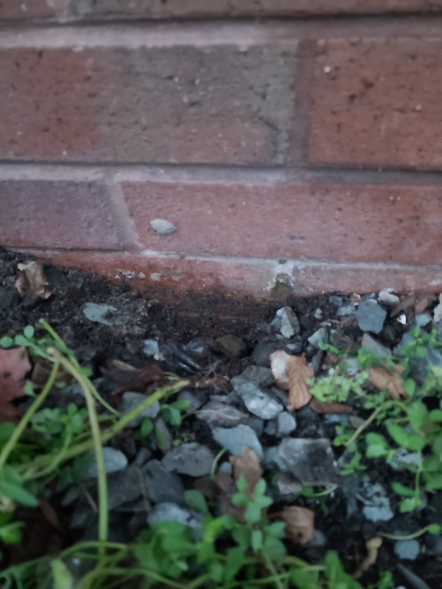

Not specifically yet, but I will check the guttering above the area for any leaks or staining. There’s a canopy over the door, but I’ll rule it out properly.
I’ve checked the ground level more closely. The gravel isn’t fully covering the DPC from what I can see, but it is quite close to the bottom brick and there’s soil/debris holding moisture against the wall. I’m going to pull it back and lower it to give clear clearance below the DPC and create a small inspection gap.
I’ve also removed the kitchen plinth — the concrete floor behind the unit is dry, though the back of the wall shows localised damp. I’ll leave it ventilated and carry out a controlled hosepipe test around the door/frame next.
Can you mark your photo please to show where the DPC is.
I can’t see a visible plastic strip externally, but based on the internal floor level and brick courses, I believe the DPC is in the mortar joint above the second brick course from ground level.
You ought to be able to see it. Scrape back the soil to find out if it has been covered. Look at the rest of the house. Unless you are on a hill, the DPC will be at the same height all round.
Slab out side door looks high , also does appear to be cement infill back to wall which suggests it was installed with a space which would have prevented rain running back to air against wall , exterior matt also keeps area wet .
