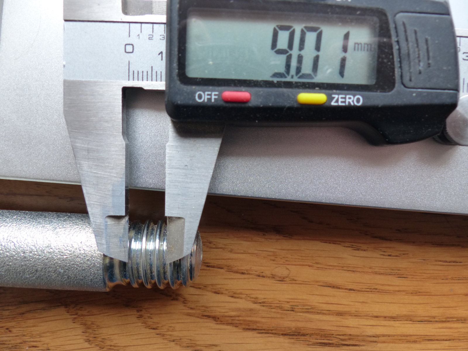

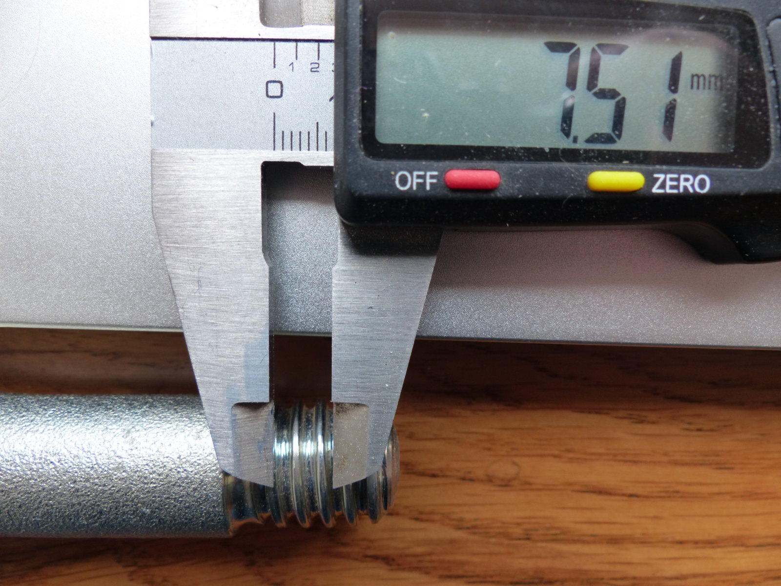

I hear what you say - BUT
Yesterday I found a forum where a guy wanted to use his tow hook bracket for a support to take the extended length for a Kayak on his roof rack, and he says he found the thread was 18 x 3.
Also - have a look at the two attached photos showing callipers set to 3 threads
- at 2.5mm (7.5)
-and 3.mm (9)
I am now trying to find some 18 x 2.5 bar locally to check it out just to try and confirm one way or the other.
