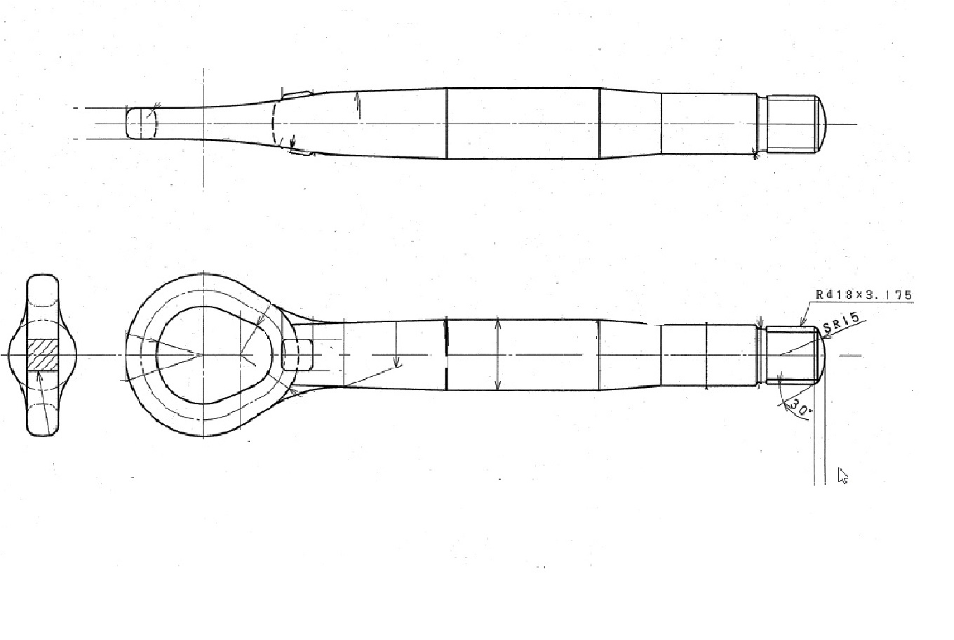

Having requested details from Lexus I had a response asking for the VIN number within 24 hours - but after over a week have heard nothing since giving them the details.
I have now ordered a gauge off ebay - hopefully will be here tomorrow so I'll hopefully have an answer at the weekend.
Turns out the thread is actually Non-Metric.
It is 3/4" diameter and is definitely 8G - ie 8tpi.
Just waiting now for the results of some enquiries for someone to turn me the threads on bar.
This is similar to BSW / UNC but unfortunately the tpi for both threads is 10.....for 8 tpi it would be 1” BSW.

I eventually received an e-mail back from Lexus - it said that all they could find was the attached drawing -
which is confusing because it specifies the thread in metric with a pitch of 3.175 - which is non standard for metric and is equal to 8 tpi, but it also states M18 which is 1mm less than 3/4". Go figure.
Still looks like I'll have to go the custom machine route - but the recent lockdown is going to make it harder to find someone to do it.
