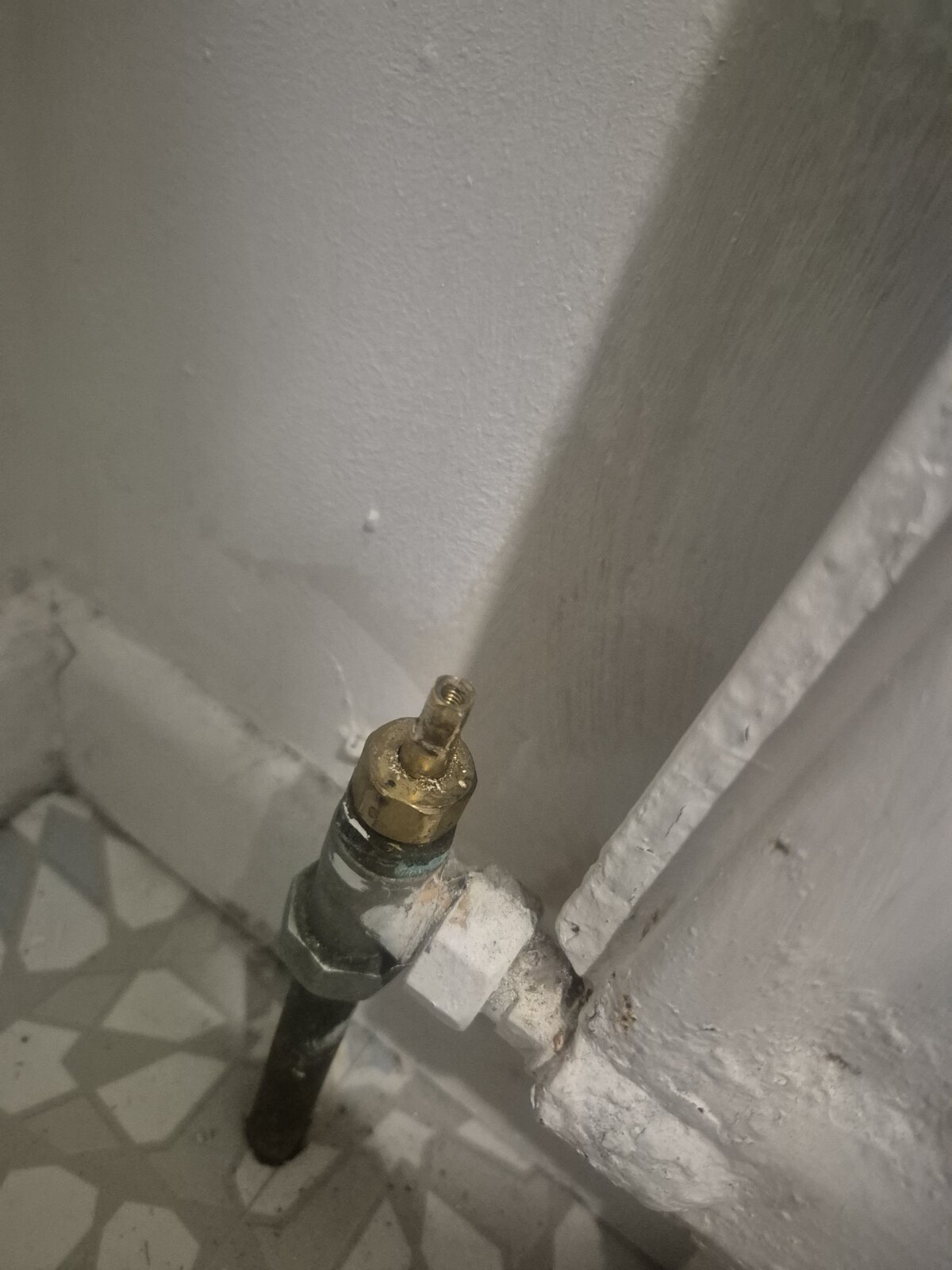

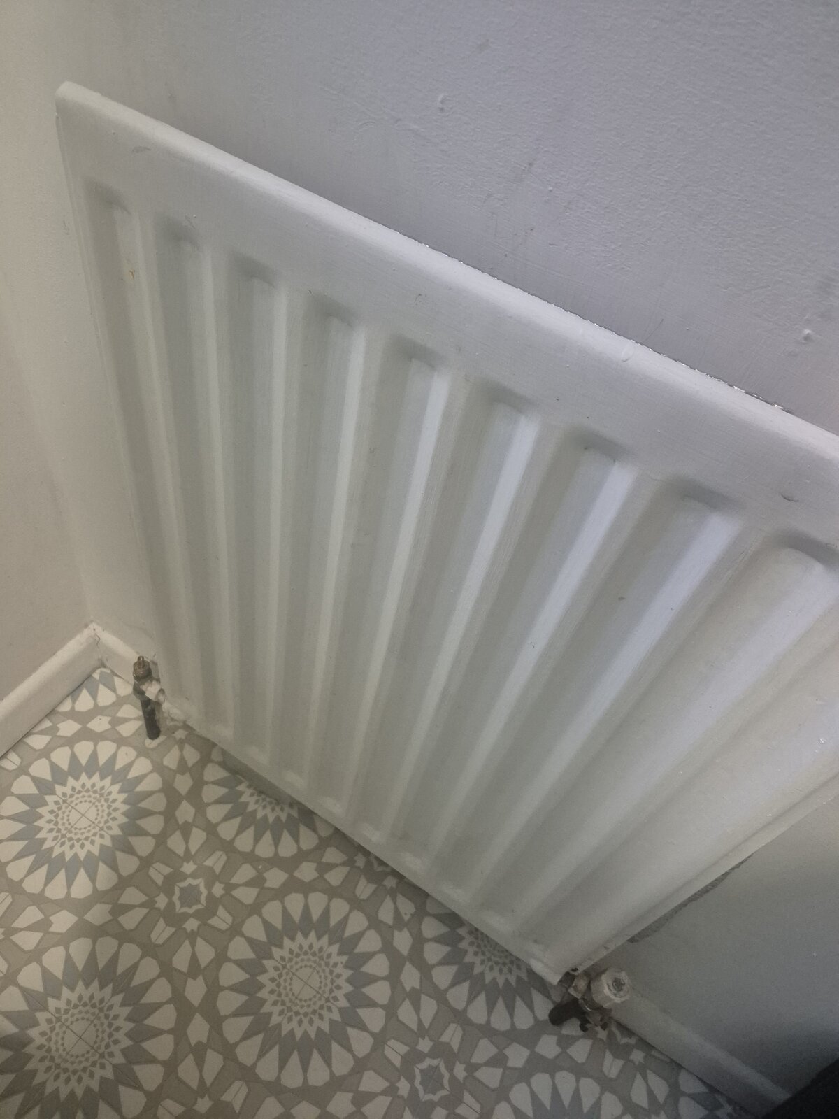

I live in a bungalow with six radiators, five i which you could fry an egg on but in my small bathroom i have a small radiator and it wont heat. When i try bleed it no air just water so i am guessing its full of sludge. I want to remove it to clear it out but the lock shieldvalve wont budge. Any ideas?

Managed to free it up. Some gentle taps with vice grips. So now both valves are shut off is it safe to remove radiator and flush out? Also how do i fill the radiator again do i simply open the valves again? Something makes me think its not as simple as that

Yes and yes - provided the valves are definitely completely off. Have a plan for what to do if they are passing a small amount of water.

After you've turned off both radiator valves, you'll need to drain the radiator before you remove it, by cracking open one of the valve to radiator connectors (NOT the supply pipe to valve connectors!) and then opening the bleed valve at the top of the radiator to let in air.
When the raditor is re-installed, fill it by opening the valves and opening the bleed valve until just water comes out of it. As Hugh Jaleak has said, this water should automatically come from the F&E tank in the loft for a vented system, or via the filling loop if you have a sealed system. This re-filling will dilute any anti-corrosion inhibitor which you should have in the water circuit but, for just one radiator drained and re-filled, this probably won't be significant
Watch out for black sludge all over your carpet when you take it off the wall, bung something in the ends when carrying it outside.
Also, when refilling, you'll need to crack open the Bleed Screw at the top of the Rad to release the air as it fills. Now, with the 2 Valves, one Handwheel should be fully open then crank back half a turn, TRV willadjust as required. Other end, should be a Lockshield Valve, that you've closed using either the Head from the handwheel Valve other end or a small spanner. Crack this open half a turn at a time until Rad get's hot.
