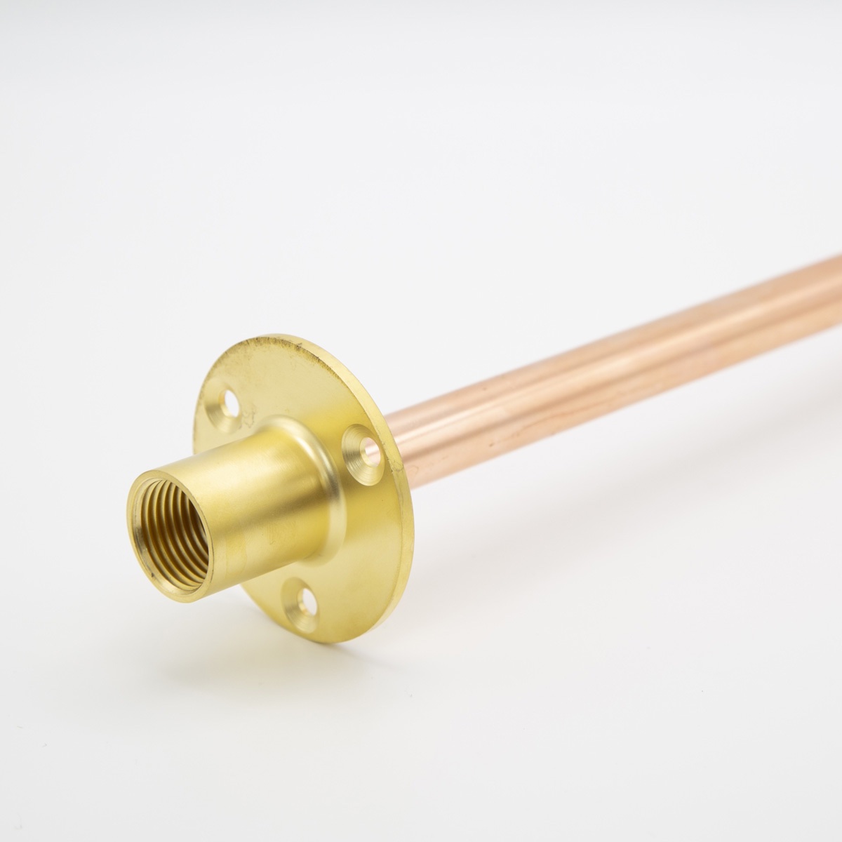

Question about 577 being semi permanent for another fitting. If I used 577 to tighten a fitting to the following picture. This item is held by 3 screws. Then if I ever needed to undo the fitting I could get it off without risking breaking the backplate itself?
As long as the backplate is well fixed to whatever wall surface it'll be screwed to then it should break and loosen ok.
Again though I'd still use Gas tape, 6>7 turns onto whatever male fitting is going in there and then make it just tight enough.
