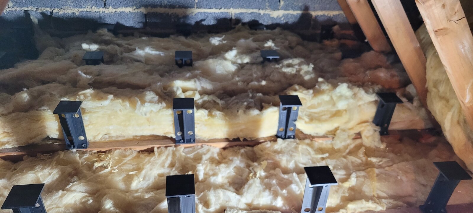

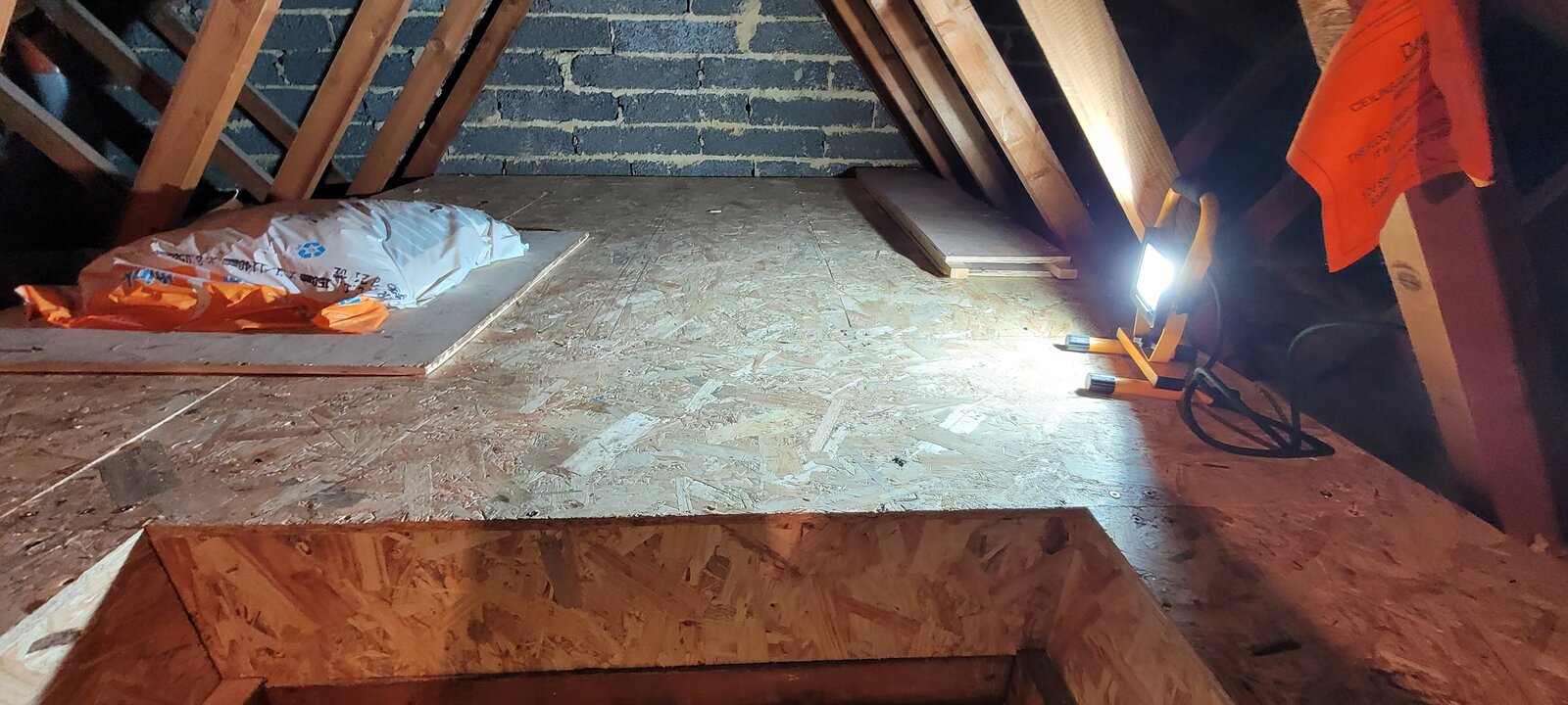

I did this using loft legs in my own house.
Only the middle bit boarded for boxes and pretty much what youre looking to do. 11mm OSB with ceiling joists at 400mm centres and is surprisingly rigid. I certainly wouldn't jump and down on it (it's a low loft anyway) but for gentle moving it's plenty strong enough. 8x4 11mm OSB is about £10ish per sheet from a decent builders merchant and similar weight and strength to plywood. Personally I avoid chipboard but understand T&G is easier to lay.
Top tips, make sure you have plenty of loft legs so you can reinforce areas and lots of screws.
And of course, watch out for plasterboard...!
