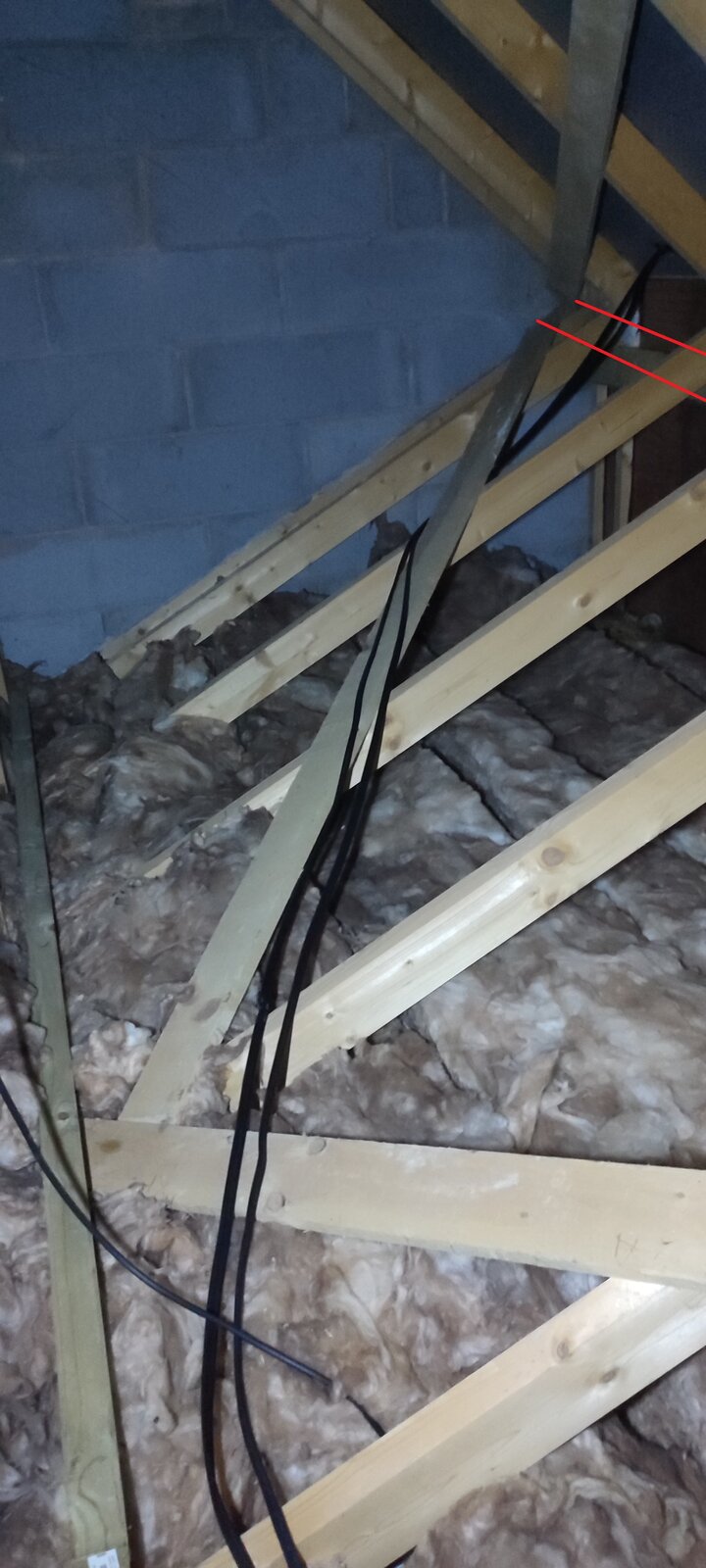

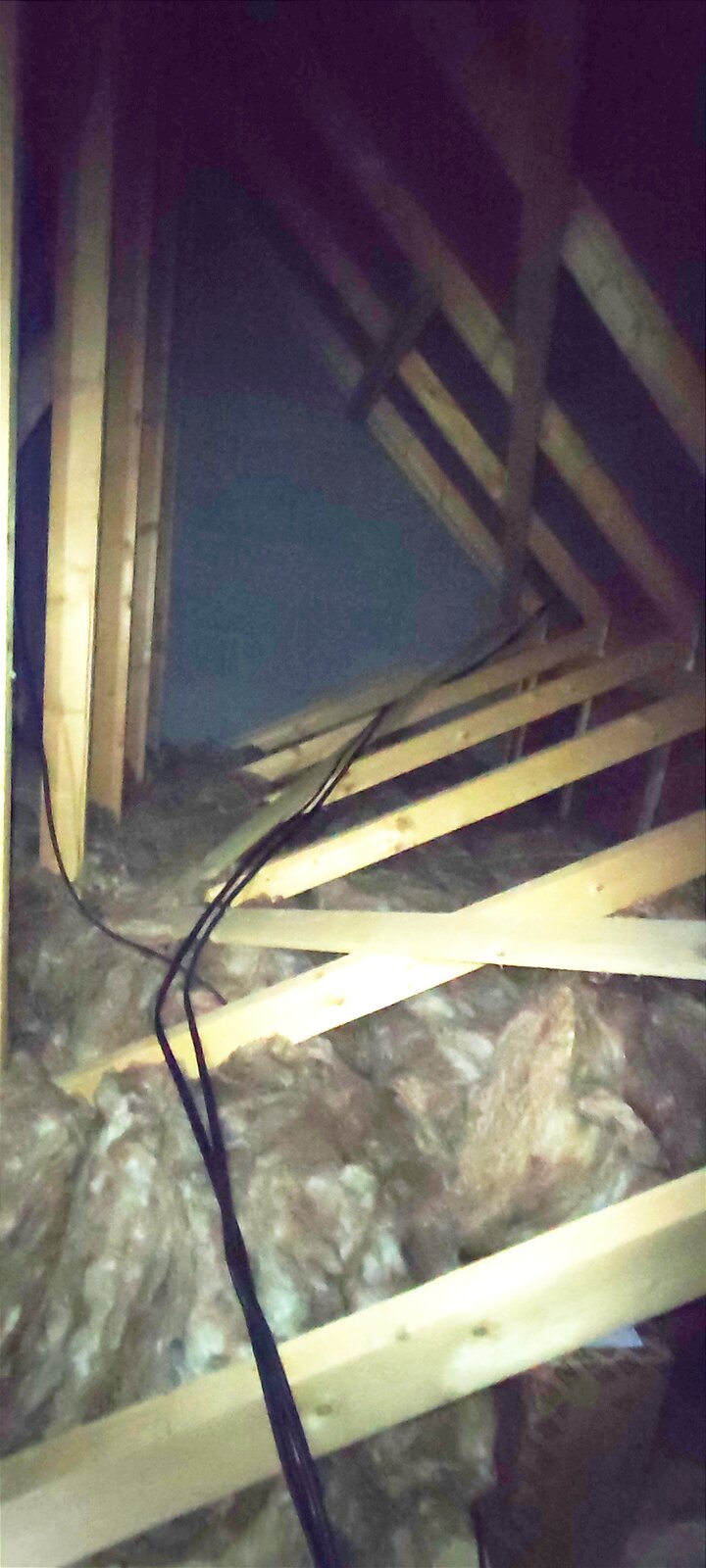

From your pictures there is a pile of insulation, what s the ceiling now?
They wouldn’t be my pictures. I currently don’t have a ceiling just open trusses 6x7m. No insulation, it’s detached garage.
It would be lovely is you shared some with us.
(y)

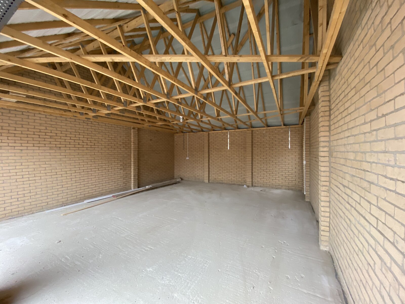

@catlad @noseall Here (easier to show you it before I filled it with crap!) Trusses are 35x72mm spaced at 600mm centres and sit atop a 3x4 wall plate at either end. The room is 7m long by 6m wide.
How would you approach this? The way I see it is I have several options, unless anybody thinks I am missing something:
MethodProsCons
Board existing truss chordsEasier & cheaper
Can be DIY
My roof may fall down(!)
Cannot accommodate storage needs+flooring sheets+plasterboard (if I wanted to PB)
Install new joists parallel to chords and install several perpendicular cross-membersLeaves existing trusses untouched
Can be DIY
Joist spans still far too long so questionable loading tolerances
Excessive deflection
Install metal web joists parallel to chordsCan span entire 7m
No cross members needed
Can be DIY
Expensive
Minimum beam height for span at 600 centres is 373mm so new finished ceiling height would be 2100mm which is not tolerable for a garage/workshop
Install a suitably designed RSJ at centre point to cut joist spans to <3.5mOnly one cross beam needed
Will allow shorter lengths of timber to be used
Will allow for 7x2 to be used instead of 8x2
Piers for RSJ can be built for free ex-materials (family)
Still quite expensive
Structural engineer required to size RSJ
Installing an RSJ will be complex and cannot be DIY
Building control sign off required

For a smaller garage I’d tend to agree as you can access pretty much everything from your ladder hatch, but with such a large space I would need to be able to walk around up there to get from item to item. I don’t particularly like the idea of walking on sheet material that’s suspended rather than on top of the trusses. This also doesn’t solve the issue of weight which I was trying to address by building an independent floor.
The strengthening beams would also still be spanning a considerable distance of 6m unsupported which would presumably put more downward load on the centre of my spans and potentially case the chords to deflect even further.
I’m not storing a grand piano up there, but I have a lot of stuff, and the plywood alone is nearly half the 0.25kn/m2 tested strain.
So unless I’m missing something I’m not sure just boarding it will be sufficient
