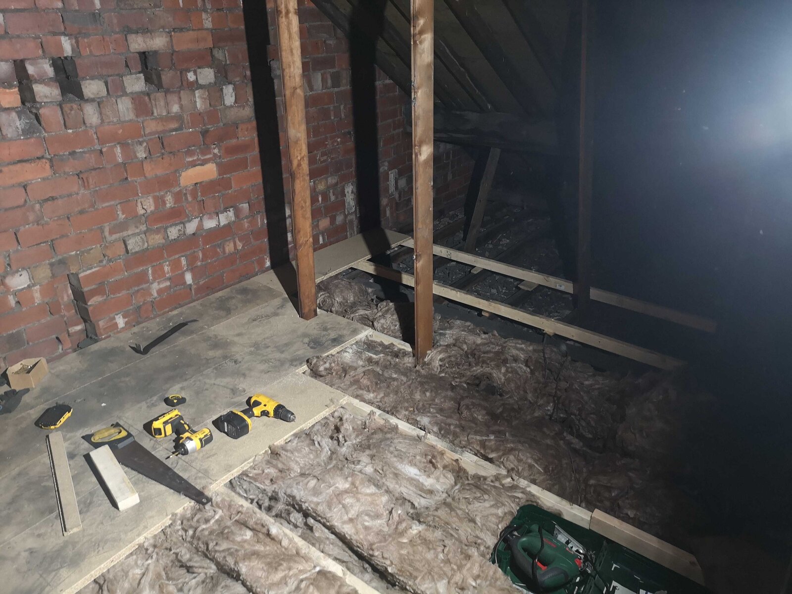

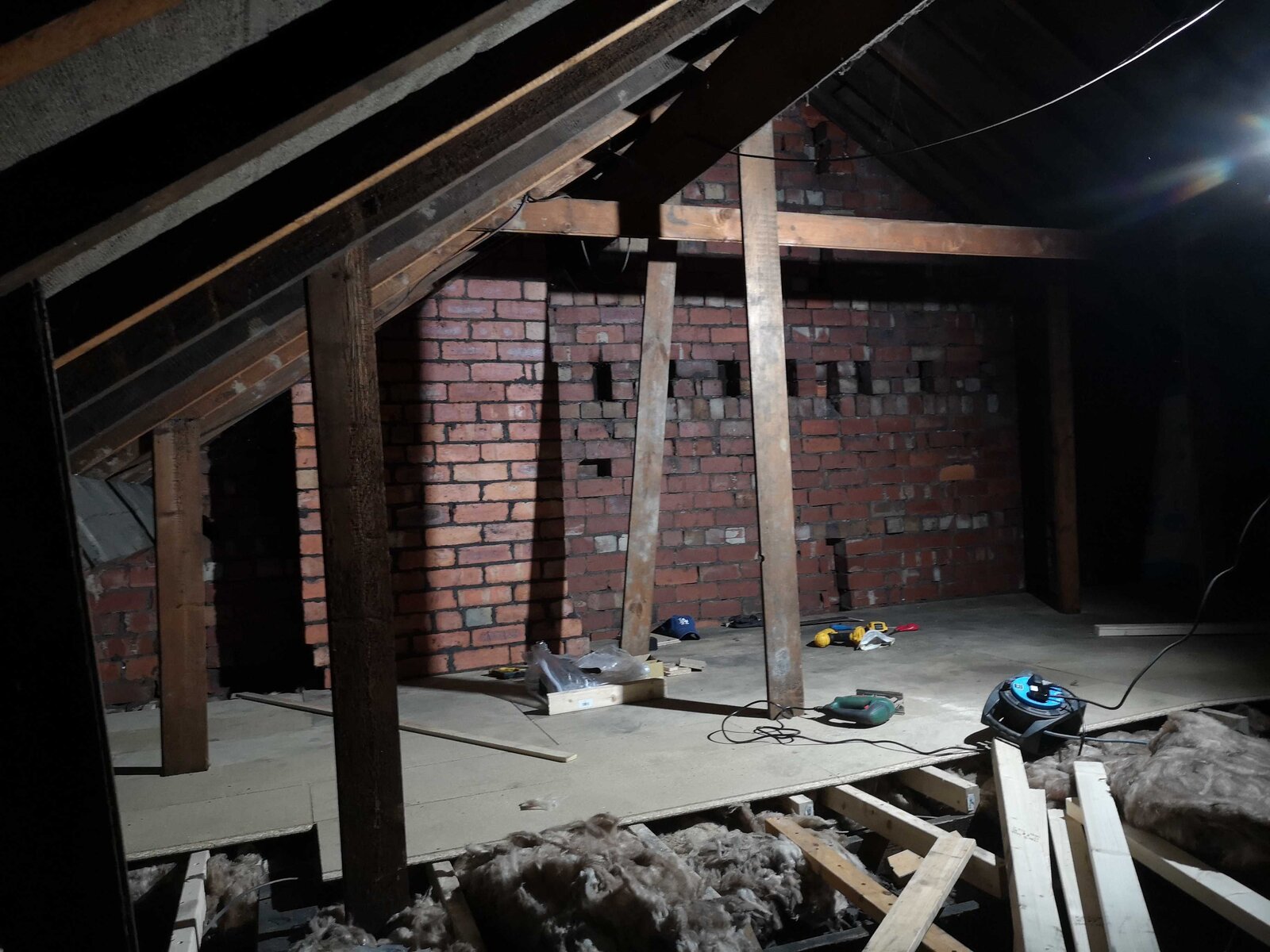

Thanks again, really helpful input. I am not really looking for a loft conversion for a room, just want to stick some old sh1t up there out the way. Things like suitcases, camping gear, some kitchen stuff we dont use, etc. So I am half tempted to just select an area and get that boarded. I expect the roof can take the weight of this light storage, if there was a water tank up there before?
That's the main question, can I chuck some boards down and get rid of clutter from downstairs
if you want a cheap and not-very-good fix for light storage, you can counterbatten by laying new timbers across your existing joists, screwed down, and ply deck on top of that, screwed down.
It will not increase overall strength, but it will spread the load somewhat and add rigidity. Try to position the weight near the supporting walls, and not in the middle of the span. If the timbers flex, your ceilings will crack or pop their nails. L&P ceilings are particularly prone to falling down.
Clean it out and renew the insulation first.
Thanks mate, really appreciate your help. I think that's what I will do - I've got the CLS for counterbattening, boards (will look at ply) and will spread the weight. Also got a load of knauf insulation to put down, just need to tidy cables up etc, and put a couple of strip lights in for proper lighting. If I am going to go ahead and look at a working room then will get a firm in
Brief update on this if anyone is interested: I got someone round who knows about this and so I went with a fairly lightweight option of counter-battening and then boarding with loft chipboards. Plus putting new insulation in and tidying everything up. It's not for a room or even really for anyone to be up there apart from getting stuff up/down. Mostly for boxes of kitchen bits, xmas decs, some tool boxes etc. I took a pic last week when I had done about 1/3 of it (seen in this post), and now have done about 50-60% of it, so plenty of storage, planning to carry on and finish it this weekend hopefully
