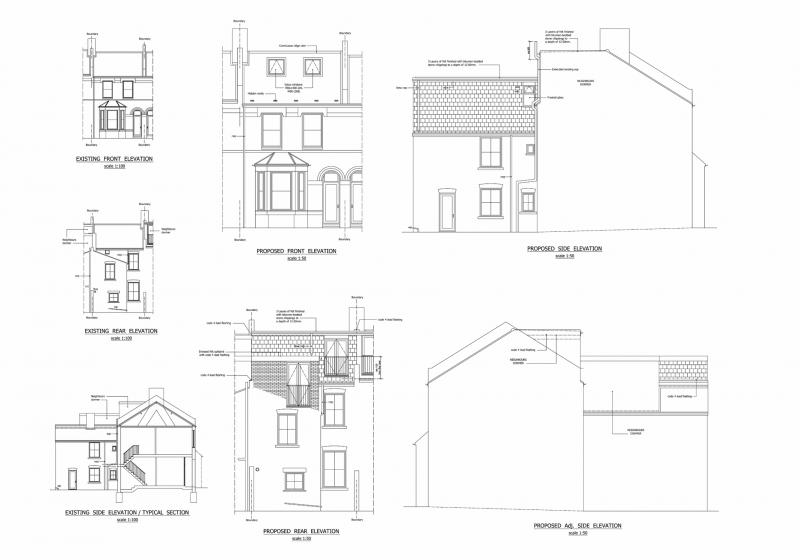

I have a standard 2 storey (ground and first) Victorian mid terrace house.
I want to do a Loft Conversion and Rear extension in one project.
However, on the rear extension I want to come the whole way back on the rear of the house (6m). Most of my neighbours properties only seem to come about half way back but one does come back the whole way.
I have read in some detail (I am not a builder, architect etc) the Permitted Development (PD) technical guidelines and from my reading believe that I can do both of these jobs under PD as long as I do them in the right order.
My main concern is over the 40 cubic metre volume limit in Class B for the roof/loft conversion. Assuming I do the standard rear dormer loft conversion and conform to all Class B requirements can I then do the rear extension under PD Class A which from my reading does not have a specific volume limit.
Bear in mind I want to do both jobs in one project.
Anyone got any experience with this? (especially in the London, Wandsworth area)
All feedback appreciated.
I have attached a drawing which shows the existing layout and what I would like to end up with.
