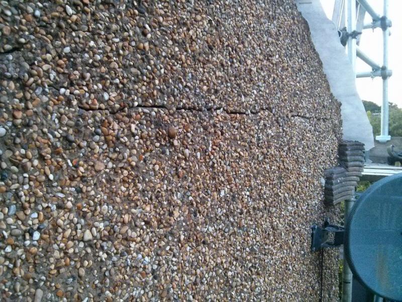

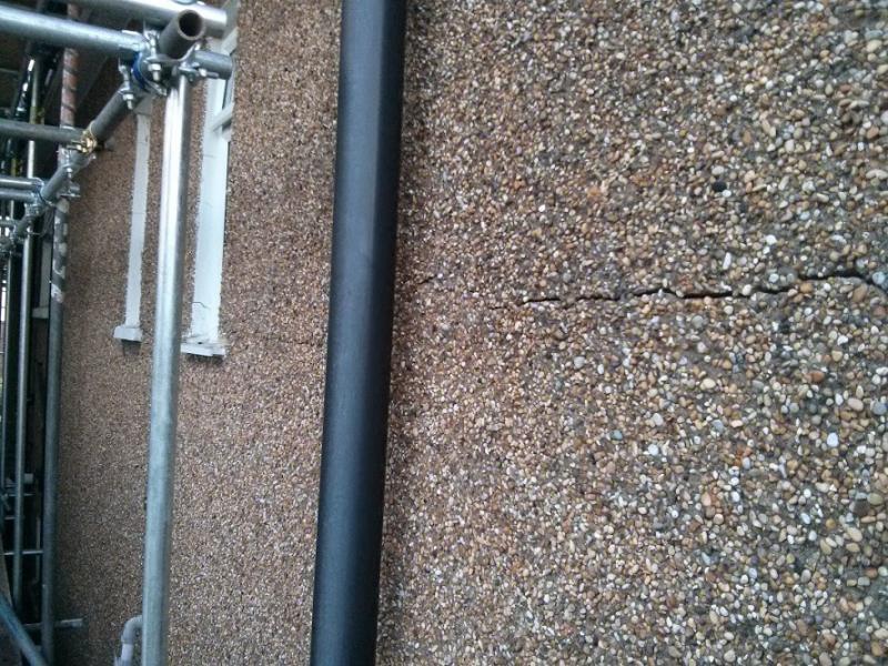

Am in the process of having a loft conversion on my 1950s detatched house. I've come home from work and found a few problems causing me to worry!

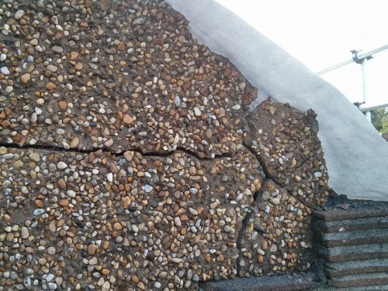

1. A number of large horizontal cracks have appeared on the external walls. They don't appear to have come through to the inside of the wall but it is a cause for concern - is this settlement? You could get a £1 coin into some of the cracks

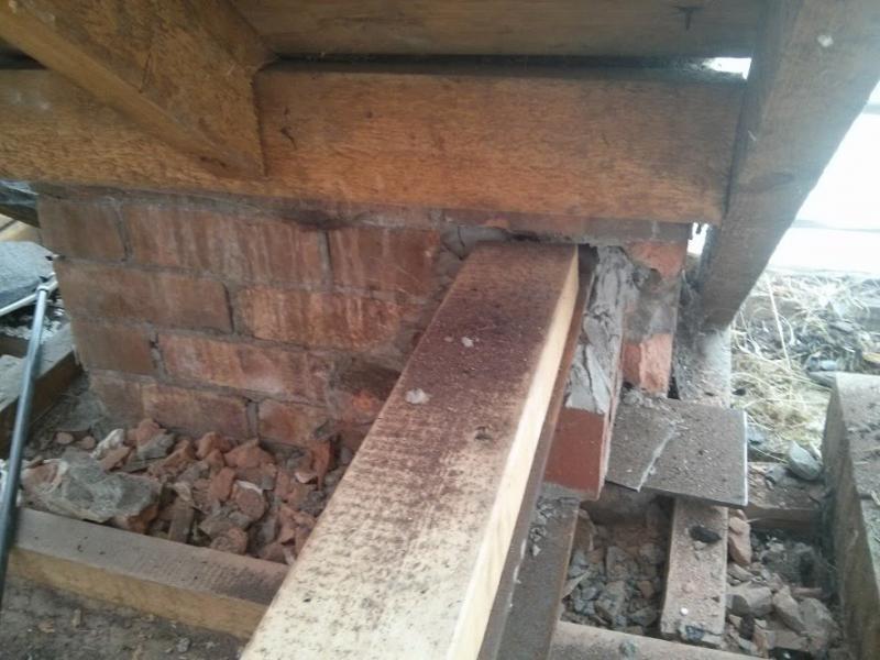

2. The builders have cleared not allowed for a chimney in their plans and have just smashed part of the chimney breast away in order to make a beam fit. We planned on using this chimney...
I'll take it up with the company tomorrow but would be interested to hear others views on the severity of these issues.

The large cracks in the pebbledash suggest they have hit the wall when installing the steel beam under the dormer front; careless workmanship - the brickwork (or blockwork?) should be re-built and not just pointed up as they will suggest.
It is a definite no-no to put a steel beam into a chimney - your building inspector should see that before it's covered in. Was the support detail of this beam shown on the plans? Are there in fact any plans? Or is this loft being done by a firm which does 'everything'?
You need to get a grip on this before it gets too far. If it's like this at this stage, there will be other problems in store

They've damaged your house by cracking that wall, and they've done damage to the chimney they apparently had no business inerfering with. The plans seem to be wrong. ??
