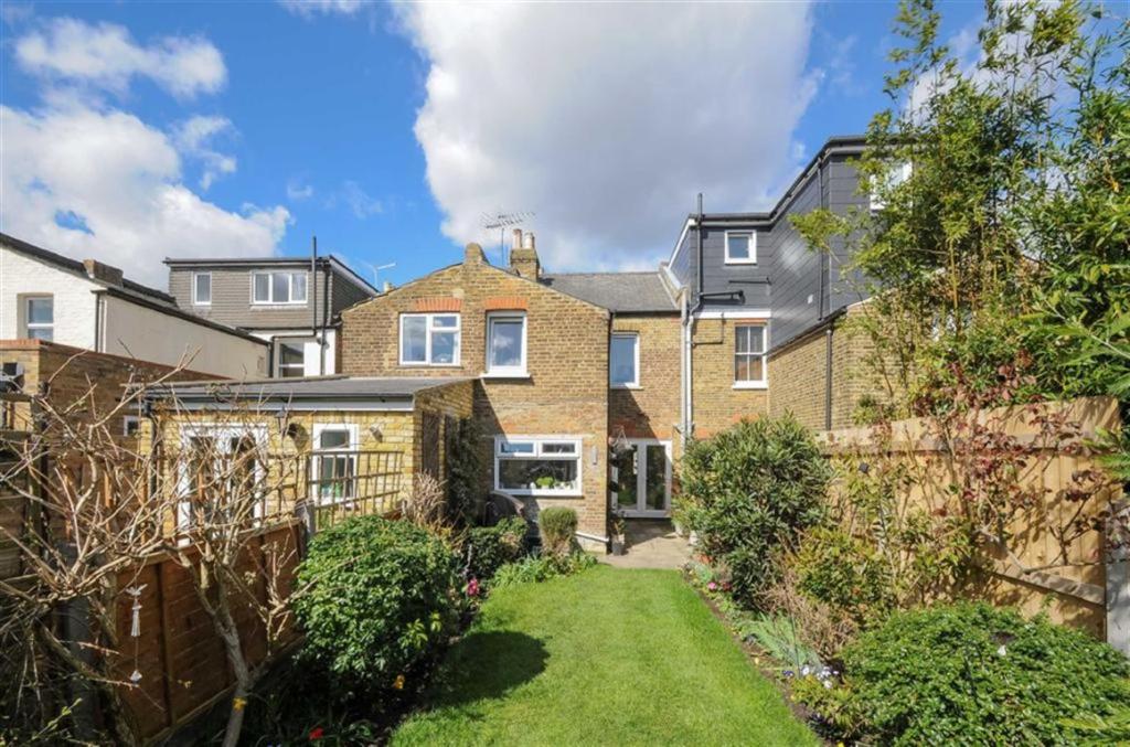

Hi all,
We are starting a loft conversion in our mid terrace property that is in the photo.
Our neighbors on the right (mid terrace as well) have already had a loft conversion some years back and before we bought our house.
Our neighbors on the left will also be starting a loft conversion within 2016.
My question is what is the best way to deal with the parapet walls in both properties.
If we do a similar job like the one on the right will we have enough gap for cladding, flashing etc?
Also on the left hand side is it preferable to do the same and leave a gap, or build a double stud wall and join roofs?
Thanks for your help

Thanks for your reply.
I had a word with my neighbor and he hinted that he expects me to build on the inside of the double brick wall. However, i don't see how a builder will be able to hang tiles and do flashing in between the gap which will be only around 200mm?
