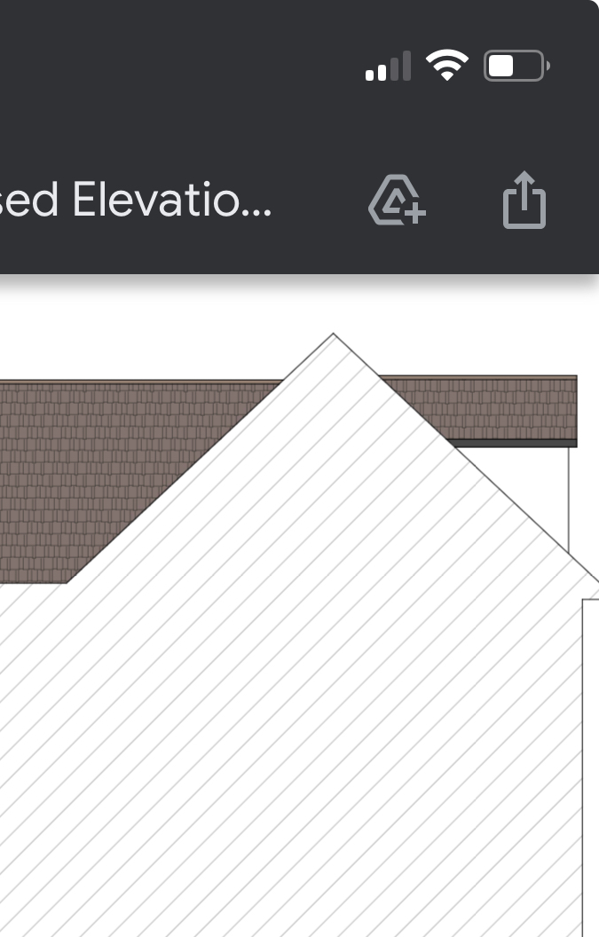

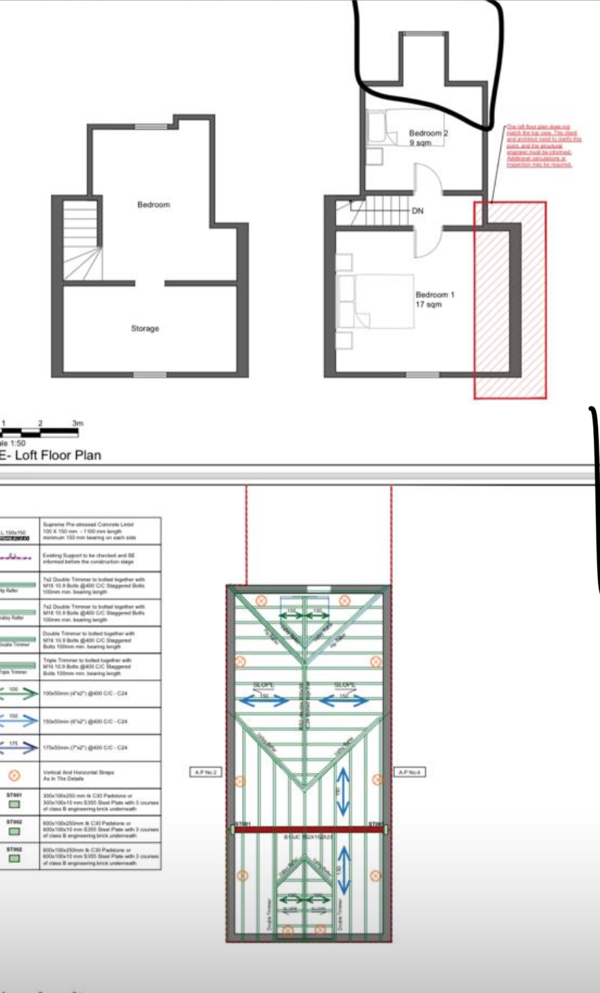

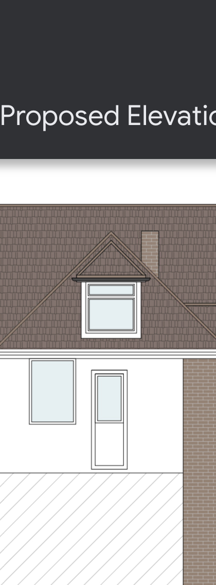

Should the walls with circles be shown as internal walls? The vertical walls will act as cheeks and will rest on the rafter trimmers
The wall circled should be detailed as an internal partition wall. The vertical walls will serve as (cheeks) and will sit directly on the rafter trimmers. No wall underneath them

None of it makes any sense to me....? Your question, the blurry drawings, the upstairs door (WTF), the ridiculously high window next to it etc. I don't understand the layout or the drawings either.
