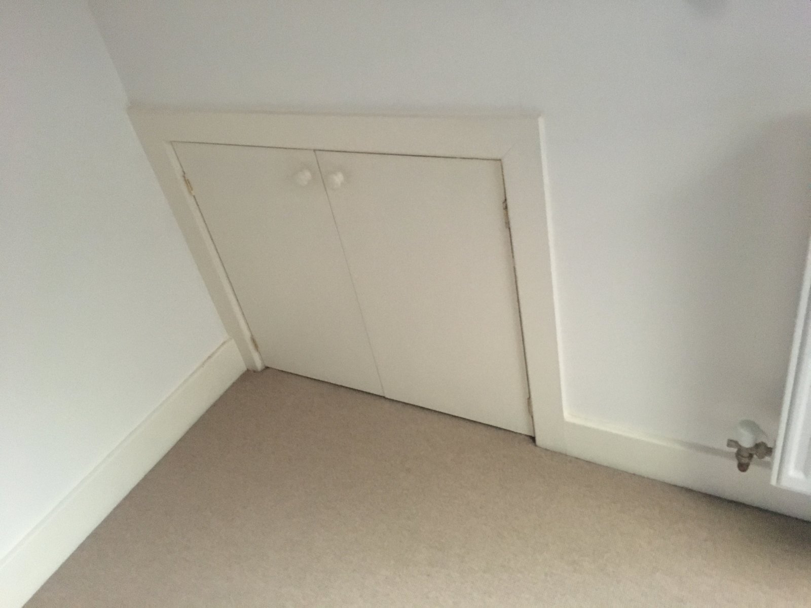

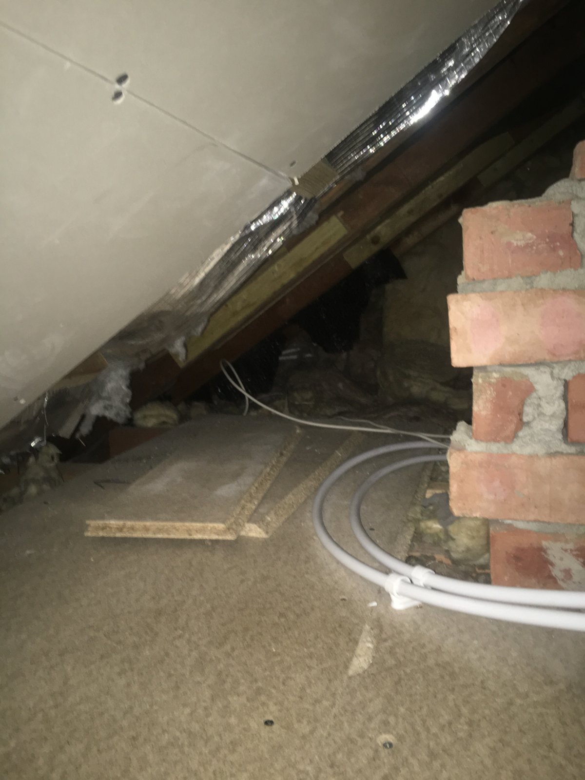

The bedroom in the loft has under eaves storage on both sides (photo attached showing doors), when I crawl into both eaves storage you can clearly see the undeveloped areas of the loft. Should these sections be sealed off? I was reading about ventilation and I think possibly mould/dust (if any) is freely being blown into the bedroom.
If the eaves storage does need sealing off to stop unwanted ventilation into the living area is it just a case of erecting some battans and screwing plasterboard onto these to stop unwanted airflow?

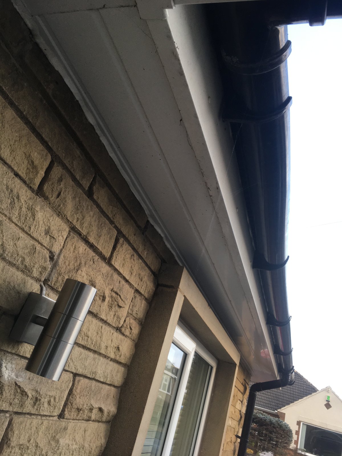

One last question, reading up about ventilation in lofts, my soffits are not ventilated. Should I be installing vent holes in the soffit boards?

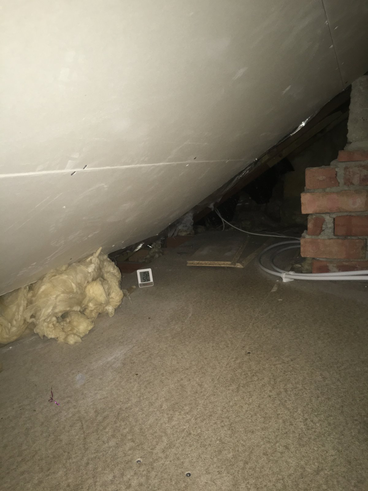

Is your loft insulation yellow?

Many thanks for the reply. The climate abroad was in the mid 20’s and much more humid than in the uk. There was no diesel lorries around the accommodation. Our loft insulation is a dark yellow colour. I’ve attached a photo showing a small piece of insulation.

Wipe round the frames and doors leading to your eaves area with a clean sponge moistened with washing up liquid and see if it comes away stained with black dust particles, which indicate that dust is blowing through the gap. The particles will be so small that you can't see them individually.
Your yellow insulation is I think old fibreglass which I find sheds irritant dust and fibres. There should not be much if it is undisturbed, especially if it is enclose by flooring and plasterboard, but I find I can't work in a loft with it unless wearing a dustmask. You can get mineral wool treated with Ecose now, which does not shed, it's the only one I will use. It is dark brown and feels soft. It is made by Knauf but widely sold as an own-brand, you will see the word "Ecose" on the wrapper. It may be sufficient to only replace the visible stuff and any near openings.
If you decide to remove the yellow stuff, pack it into bin bags to carry away, and use a vac with a fine filter afterwards. I use a builders canister vac that has a cartridge filter, and use fleecy dust bags as well. Modern vacs can often be fitted with a Hepa filter to trap microscopic particles. An old loft will usually have a lot of old dust in it, especially if it has ever been unfelted.
