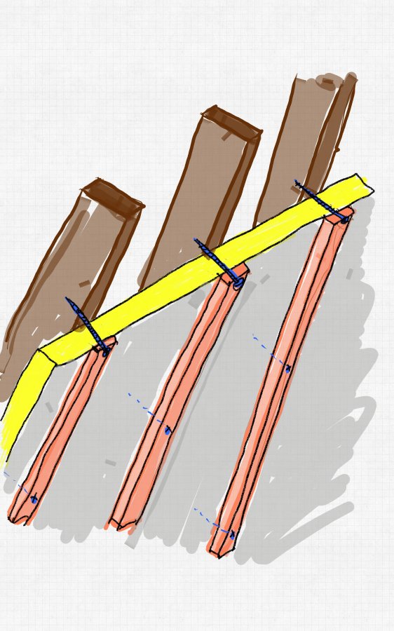

I am looking to improve the insulation level of my "non-habitable" loft conversion. One area that needs improvement is in the eave cupboards. They essentially have no insulated backing to them and you can see right down to the eaves where there will be a draught coming through.
I was thinking of some form of baton along the top and bottom and then attaching some plywood sheeting and then facing it with solid insulation etc?

Rip that down and put some foil faced insulation between and or across the rafters. Seal gaps with expanding foam.
If any air gap needs to be maintained under the felt, then allow for that.
Otherwise (and less messy) just insulate across it as it is with the foil faced board. No need for batten and ply first. Use a 2x1 timber to hold it to the rafters - either horizontal or parallel to the rafters.

Just to clarify, there is already fibreglass insulation (probably not enough) between the rafters. That sheeting seems to be there to stop it from falling out or something. Hence I thought it would be an idea to square off the cupboards and insulate. There is no roof felt, this is a 1930s tile roof with back mortaring.
Obvious question, how would one attach and retain foil faced insulation between or across the refters?
Will certainly consider the options you mentions. I assume the 2x1 timber ply goes over the foil face board and screws into the rafters?
Yes thats it, it does not need to be 2x1 just something like it to do the job. It's a lot easier than using larger sheets of board.
Just to clarify, if I went with the first option and put 150mm of solid insulation across the rafters. How would one go about attaching it to the rafters?
