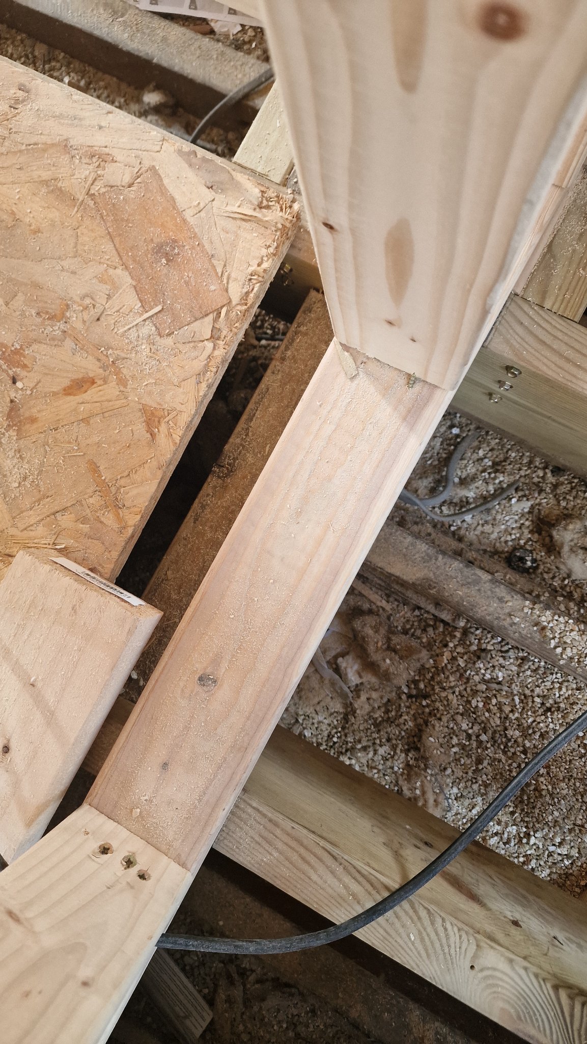

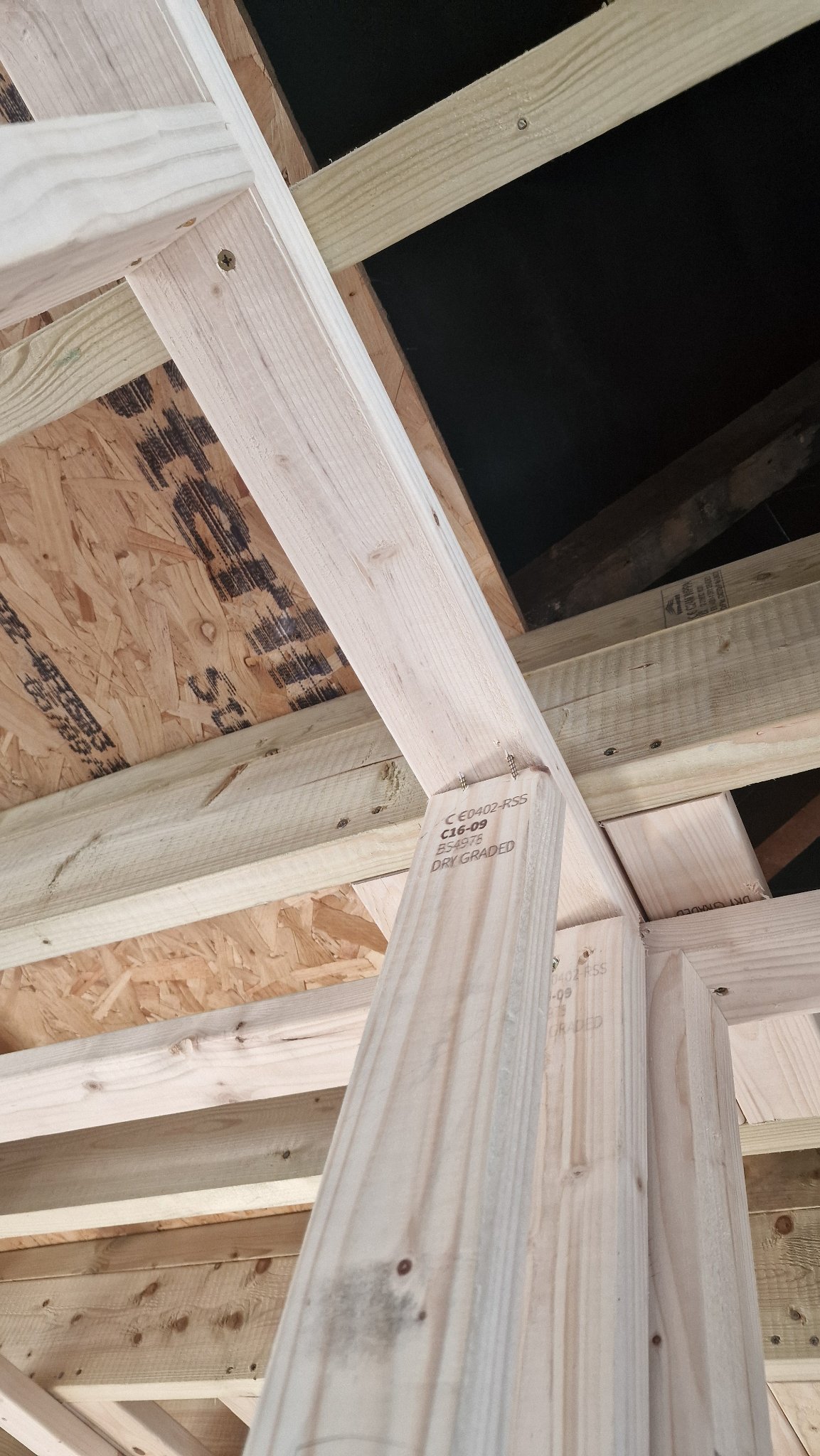

Hello,
I am doing DIY work on my loft, I have build up the stud walls and now am ready to do the first fix wiring and I need some guidance on where to drill the holes for the 2.5mm for ring and 1.5mm for lighting.
my stud walls are 89mm x 38mm, can I drill a 20mm hole to the studs including the head and sole plate? To feed the 2.5mm to the sockets from below and 1.5mm from above, i need to drill through the sole plate - is this acceptable and within building/electrical regs?
pictures of sole and head plate attached.
Any guidance will be appreciated.
Thanks,

You obviously have no alternative but to do that.
The sole and head plates you have added are presumably not in any way 'structural', so there isn't really any issue in drilling holes in them.
