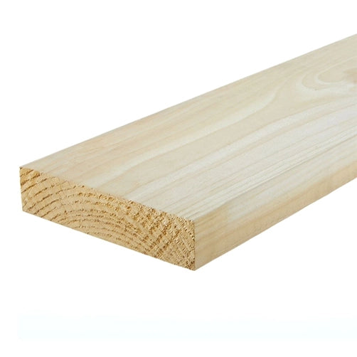

I have seen the joists below, will be calling them tomorrow and possibly pacing an order. I will be making holes in the walls and have these joists sit in the gaps.
Sorry i posted a wrong link, it's the 8x2 joists not the 6x2, I really should have checked this before posting.

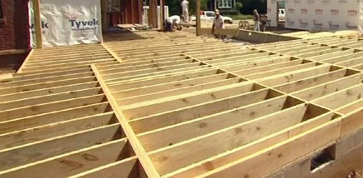

Assuming your intention is to stiffen the floor you need solid strutting, not noggins - noggins is in walls, normally. On a length such as this a single row of solid strutting down the centre line of the room suffices. The strutting should ideally be from the same material as the joists (i.e 8 x 2in C24), or failing that be of the same thickness but no less than 80% of the height (i.e 6.5 x 2in) to perform adequately. The fit between the joists needs to be very snug. Herringbone strutting is a bit better, but a lot more time consuming to install
Solid strutting in normally done as a single row (or sometimes multiple rows), like this:
Herringbone strutting (the other main technique) looks like this:
Note that in both cases the strutting is installed in more or less a straight line. Not random. The function of strutting is to prevent joists under heavy load from twisting by transferring somevof the load into the adjacent joists. In order to do this efficiently and consistently the strutting must be installed in a (more or less) straight line.

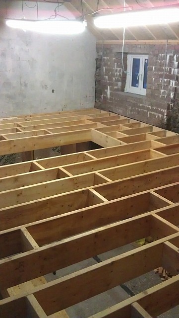

The example you referenced (see below) isn't really solid strutting as we install it in the UK (to meet Building Control requirements) so I have no idea whether it would work as well or whether it would be given approval:
Maybe it would be OK if you were installing a diaphragm floor, but even there trying to nail into the strutting accurately would be an absolute nightmare (and if you hit the edges of any of the timbers with a nail but don't sink into the timberit can result in a point in the floor which creaks), so I doubt it has any advantages

I googled the picture I posted and seems easier to do, I can drill either side of the joists
