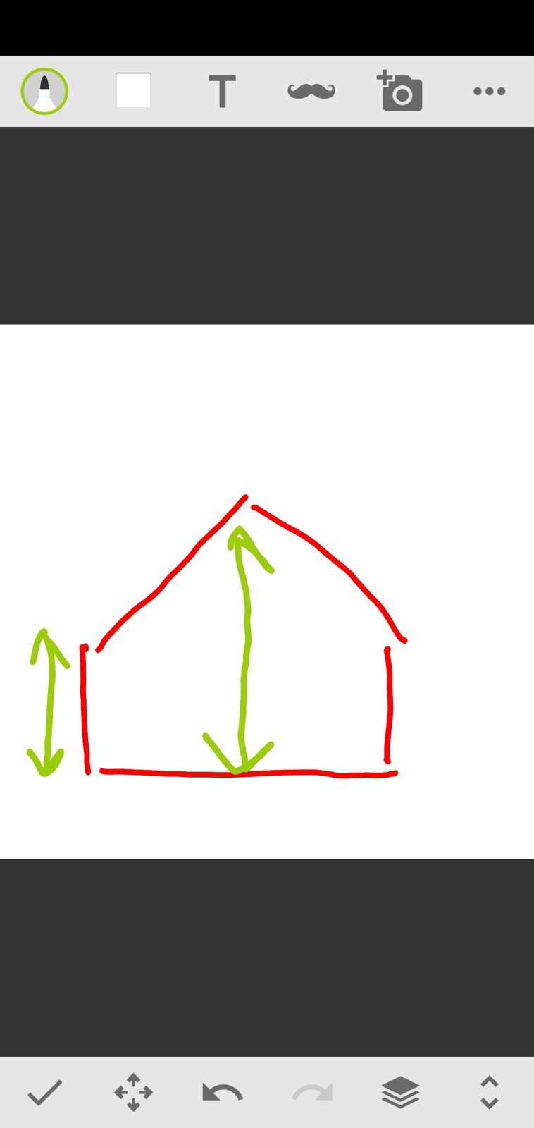

Do the radiators get as hot as those in the rest of the house? Have you tried bleeding them? Do things improve up there if you turn the rest of the radiators off?
What are the dimensions in green on my drawing?
Hi Andrew
Height is 1.07m, under the Velux (slope of the roof)
Ceiling height is 2.4m (insulated loft space above the middle section of the room between the sloping roof)
