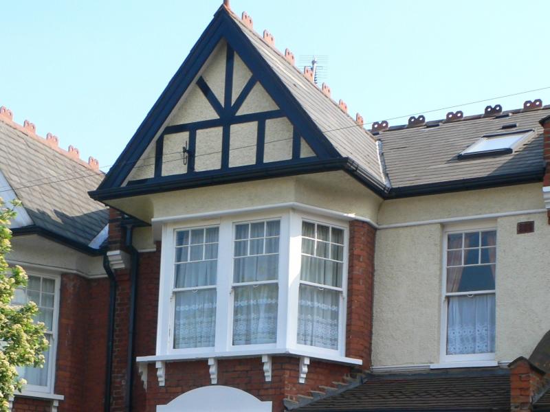

Hi Guys, about 8 years ago we had a loft conversion.
We always planned for storage but I nver got round to doing it, and since SHMBO wants the loft decorated the time is ripe so to speak.
Here's the external view, the area of interest is the inside of the front gable.

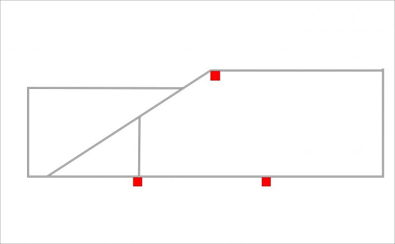

Here's a very rough line drawing from a side view, lhs is the gable which is lower than the roof ridge line. The red boxes donate some of the main steel support

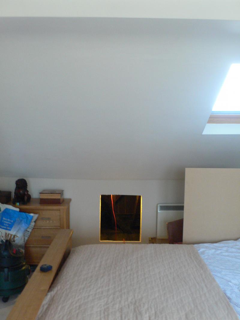

When they converted the loft we made hatch provision to access the dead gable space and today I took half of the hatch size out to get in a measure up.
The store room area will always be a simple store nothing more and the plan is to lay celotex on the existing structure, then tg 22mm chipboard, lag all areas and plaster board over to make the area sort of dust proof.
Now I can work round the existing structure, but I have been wondering if I could encourage some more space by removing what looks like unnecessary diagonal rafters that would have supported the gable prior to the loft conversion.
Here's half the intended access point

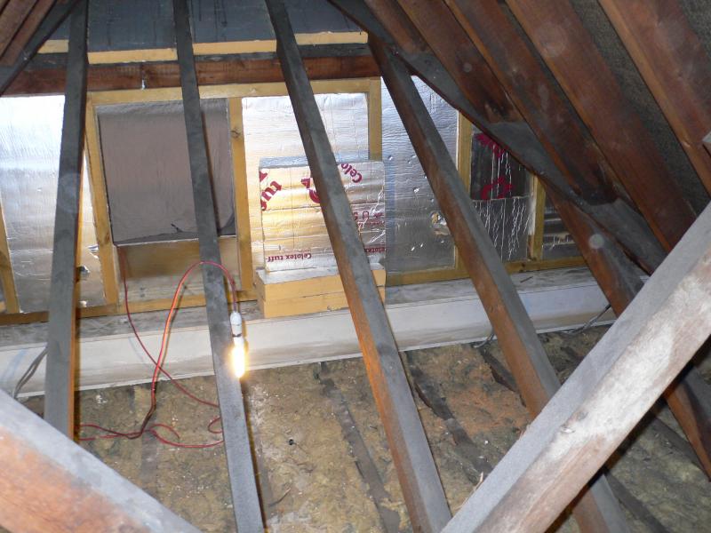

Now with your head looking in to the gable, you see the picture below. In the far ground is the internal brick face of the gable and between the camera and the brick face are the rafters in question.
Looking from the gable brick face back towards the access hatch you see the rafters better

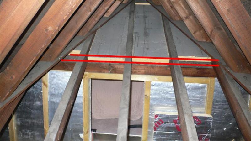

Rafters at the top towards the ridge of the roof and the sub roof steel. Its the 3 central ones that Id like to cut out.
Lower down
and finally where the rafters join to the old joists between 1sr floor ceiling / old loft floor level.
So any ideas, am I playing with fire even thinking that the three rafters I'd like to take out can be removed?
My (uneducated) logic is the prior to the loft conversion and the 'new' structural integrity created by the steels the rafters would have been essential on a full wood roof structure.
But now since the steels take the loads, and since there is load support between the front floor steel and the roof line they are simply redundant.

Those rafters you want to remove look like they are supporting the layboard which the gable rafters are fixed onto. My gut feeling is no they cannot be removed without finding sufficeint support for the valley board. .
Chicken lips is right in that builders would often use the rafters of the main roof to support thin layboards, which in turn support the rafters of the bay roof.
The middle 3 rafters going down below the level of the steel may appear to be redundant but you need to be careful.
I did exactly the same thing several years ago (cutting out 3 rafters below a purlin to get into the roof void of a later extension). When cutting out the last 2 rafters, the saw kept jamming. I was forgetting that the the whole assembly of ceiling joists and rafters forms a rigid triangle, and once I'd removed the connections between the rafters and old ceiling joists, the opposite roof slope was tending to pull away (the rafters were obviously in compression). To reduce any further tendency to spread, I glued and screwed large sheets of plywood across most of the ceiling joists to make the ceiling a rigid horizontal diaphragm, continuous with the part where I'd not cut the rafters away.
Sorry I've gone on a bit but the pronlem is not easy to describe. I should think carefully about this. Could you just take out 1 rafter? That would at least give some additional space.

Putting plywood where you suggested would not solve the potential problem I outlined. This is my fault for not explaining it clearly, so I've attached a couple of sketches to hopefully explain the issue
The top sketch shows the normal situation, where the compression in the rafters is balanced by the tension in the ceiling joists, and the whole thing remains stable.
The bottom sketch shows the situation when part of the rafters are cut away; the tension goes out of the ceiling joists and, in theory, there is nothing to stop the opposite slope from pushing outwards. In my case, with 3 lower rafters removed, I glued and screwed ply sheets -shown red - connecing the freed ceiling joists to those on either side, so making (hopefully) a rigid horizontal diaphragm.
In your case, you have additional joists and boarding for the loft floor, plus a flat roof, both of which will act as horizontal plates and considerably enhance rigidity. In these circumstances you might, on reflection, be OK.
Just looked at your diagram again in your 1st post and there is a way to do it.
Your Layboard, which is supporting your rafters in your gable, will have to be turned into a hip layboard.
Basically rather than sat flat, the layboard needs to be turned and sat on edge to give better support to the rafters in your gable. This would happed over where your existing steel is down to the ceiling.

I understand that the roof triangle was broken, that the dormer back square is supported as a rigid box. The front house lower steel as seen in white fire proofing paint in the early pictures is there (I think) to support the new loft floor level AND support the front rafters since the triangle rule is broken by the dormer.
I also understand that the main rafters support the layboard for the gable rafters that make the valley zone.
The three rarfters I want to remove seem to have no great supporting role as far as the valley, or the layboards that support tha gable rafters. Are concerned.
The centre one appears to offer no support at all
The LHS and rhs of centre offer support at a point that could remain and that would be easy enough to fix some hd plates, brackets or whatever fixing is suggested.
So what do you say guys, yes or no, or yes with actions?
