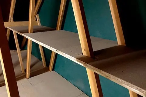

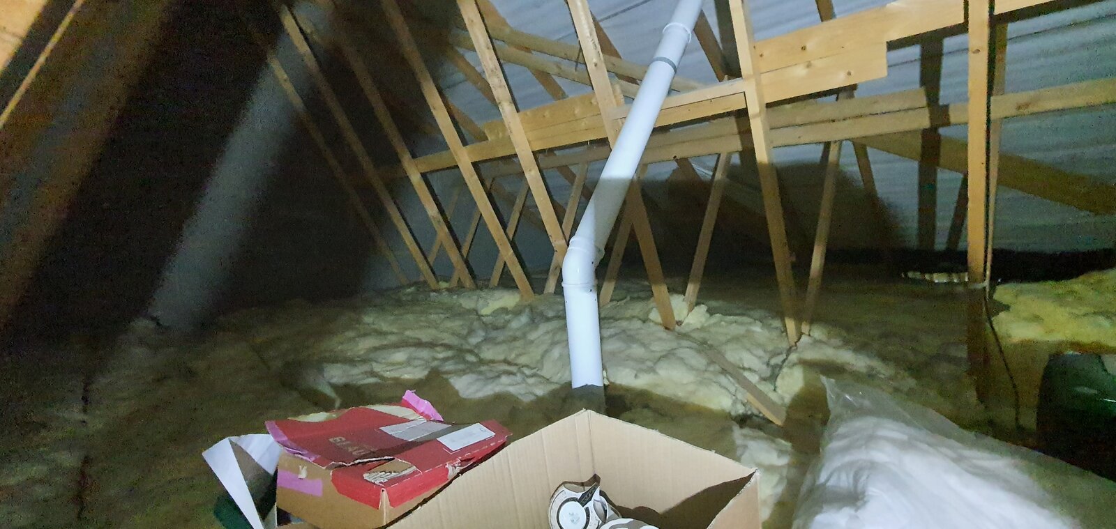

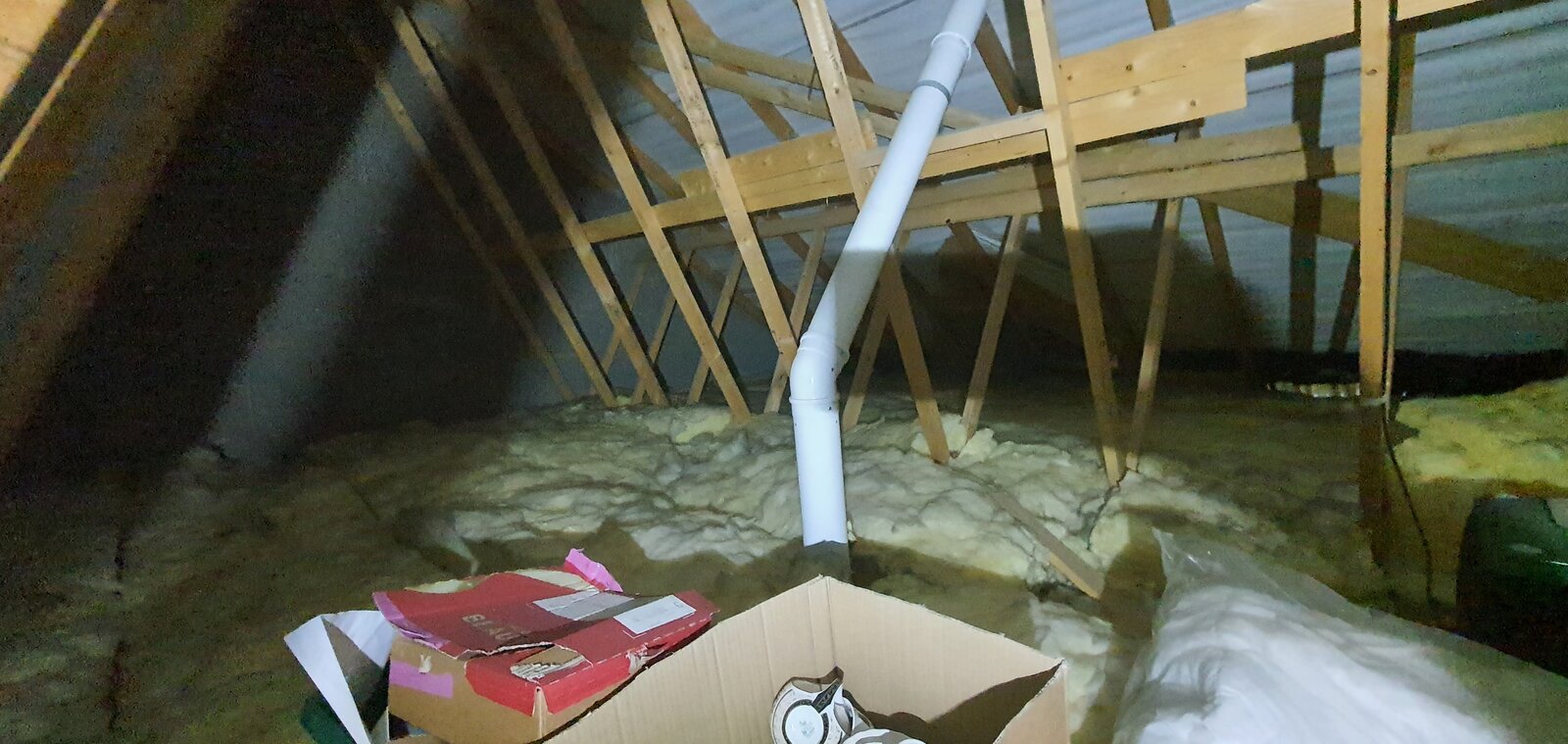

I live in a new build , the loft is about 6m x 6m (pic attached) and the joists are about 34mm x 94mm and roughly 60cm apart (although that varies). Given that, I expect I'm towards the lower end of the storage recommendations.
I was thinking of boarding using loft legs and 18mm OSB boards. Problem is, 18mm OSB boards themselves weigh 11-14 kg per m2. Add to that the weight of the loft legs and I think that means I only have about 10-12kg per m2 of storage weight.
That makes me think the usefulness of loft storage is pretty limited. Have I missed something?

The roof won't collapse, after all during construction it coped with some 16st fat ass builders walking about on the trusses. The order of the day is to just be sensible, Christmas decks, suitcases no worries. That said I lived in a new build about 20 years ago (they're no worse or better now for strength) and stored all-sorts of ridiculous stuff up there, 25kg speakers, massive boxes of junk and filing, the roof was crammed in the middle section, I'm still alive.

Rather than loft legs, I prefer counter-battens, laid at right angles to your existing timbers and skew-screwed to them. This will spread the load and add rigidity. If you top it with a ply floor, also screwed down, this will add even more rigidity. I used decking timbers, which are pre-treated and quite cheap.
You can double up the battens down the middle where you will mostly be walking and standing if you like. Use 600mm spacing so you can easily lay insulation between them.

If you feel you need 250mm of insulation, and you existing timbers are about 100mm deep, you can add 150mm or so of counterbattens, or loft legs which do not give such a strong floor. You do not squash the insulation, you run it between the timbers. There is also a slight gain from the surfaces of the floor.

I'm adding an extra 170mm of insulation to my loft so I will have a total of 270mm of insulation. If I buy 170mm joists for the loft boards they will be adding quite a lot of extra weight. Loft legs don't get much appreciation but at least they are relatively light.
Though you're adding less weight you're also not spreading the load onto the adjacent joists.
True but how much would five 2400mm x 170mm x 50mm joist weigh, plus of course the weight of the loft boards, probably more than the items being stored.
I'm still undecided between joists and loft legs.
