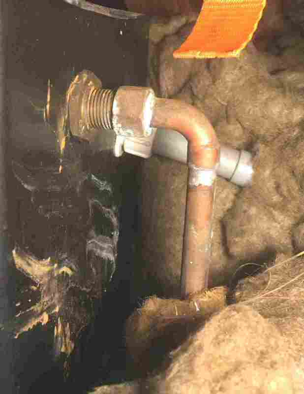

I need to replace the float valve in my daughters loft tank. The old one is noisy and leaky. I intend to replace it with a quieter side entry fill valve. i.e. this one.
I’ve replaced the fill valve in my own house a number of years ago but I can’t remember what type of fitting is needed to connect the brass shank of the fill-valve to the 15mm pipework.
The old fitting/connection looks a bit skanky,...see picture.
Can I re-use the existing fitting (as skanky as it looks) or is it best to replace it?
If I can re-use the existing fitting all well and good,...but I’d like to have new fitting/s to hand just in case the old one can’t be re-utilized.
In essence, what do I need to buy to make the connection?
As ever, all replies gratefully received.

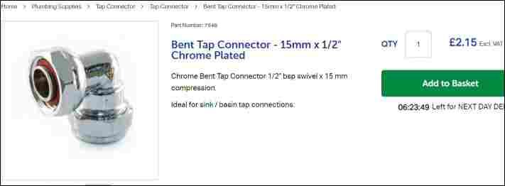

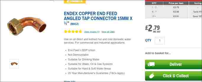

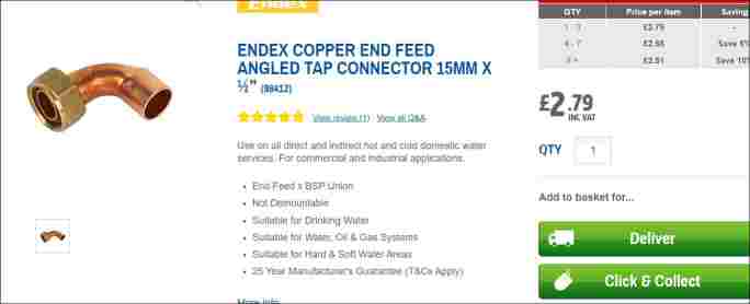

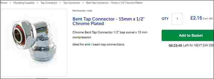

Would either of these ½”-15mm elbowed connectors be suitable to replace the existing skanky old connector if the need arises?
You could replace it with the same if you were ok with soldering but to be honest, there’s nothing wrong with what you have - just a bit of limescale where it’s had a weep in the past. Go to any plumbers merchants and just ask for a 15mm tap connector washer.

However, I’m a passable solderer if need be;...end-feed is not a problem,...I’ve done lots of it over the years,...it’s just that I don’t do plumbing/soldering on a regular basis and I do get a bit rusty! :unsure:
That overflow pipe looks like it's distorting the cistern wall
