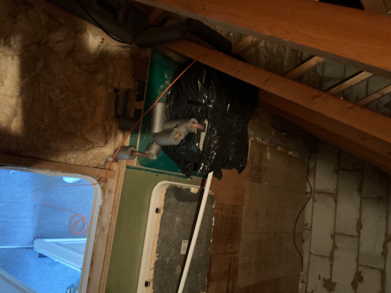

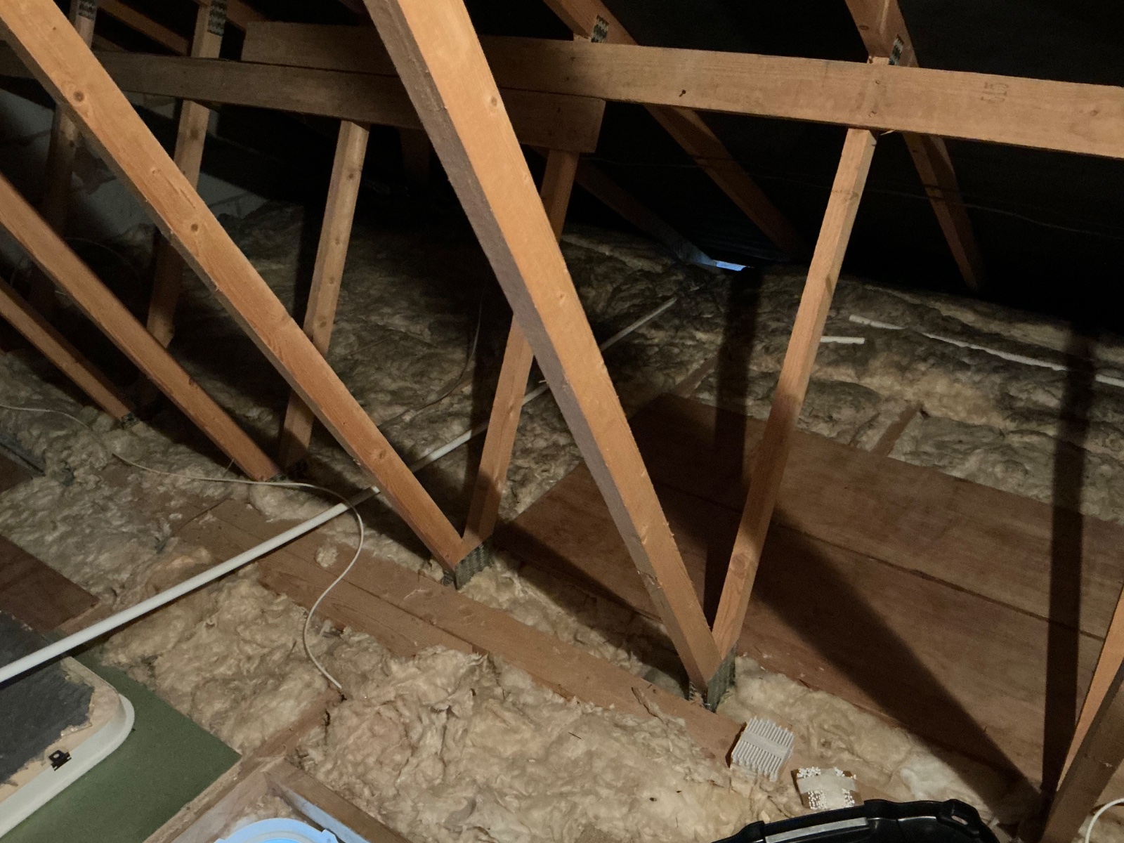

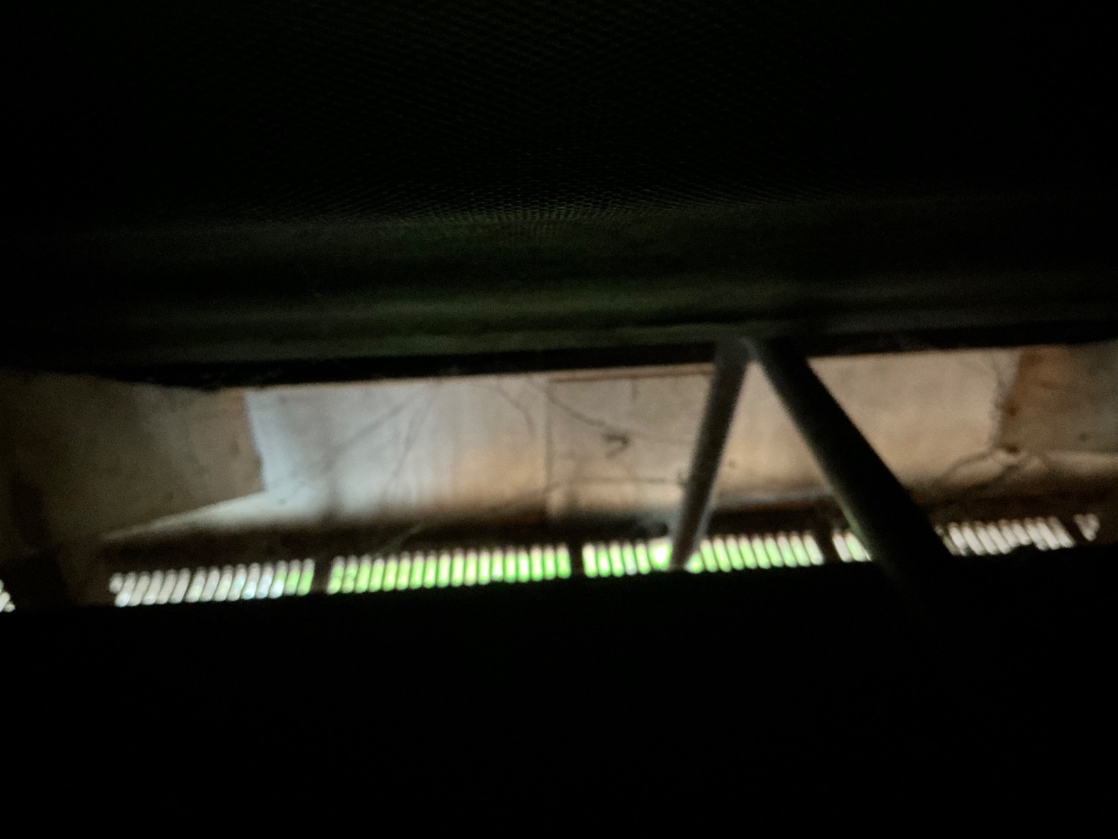

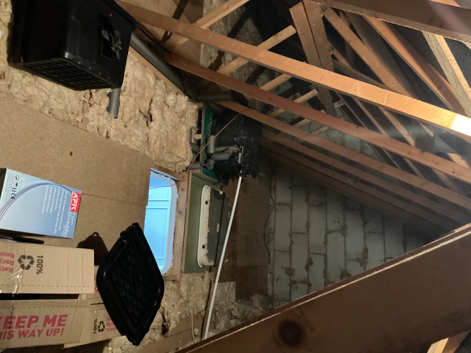

This is my loft, build circa 2005. The green you can see in the last photo is my lawn. As someone who is totally clueless, that doesn’t seem normal? I know the roof needs ventilation but I thought that was via vent tiles? So is this normal? It’s all the way around the loft apart from the gable (?) ends. Any knowledge much appreciated.

Looks like soffit ventilation , nothing unusual , roof design dictates why style of venting is used .
Thank you. That helps. I’m planning on rolling out some more insulation as it’s minimal up there. I’m assuming I’d need to take the boards up but have two thoughts about that. Firstly, that laying them back down directly on top of the insulation seems a bad idea as squishing surely isn’t good and secondly, the loft access hole will no longer be flush. Is that normal or should I find a way to raise the access hole surround? Apologies for being captain question, I have added loft insulation before just not in an attic of this style!
If you want to increase the insulation depth you need to increase the board depth as well to accommodate it , various ways of doing it.
Just google it for video how too.
