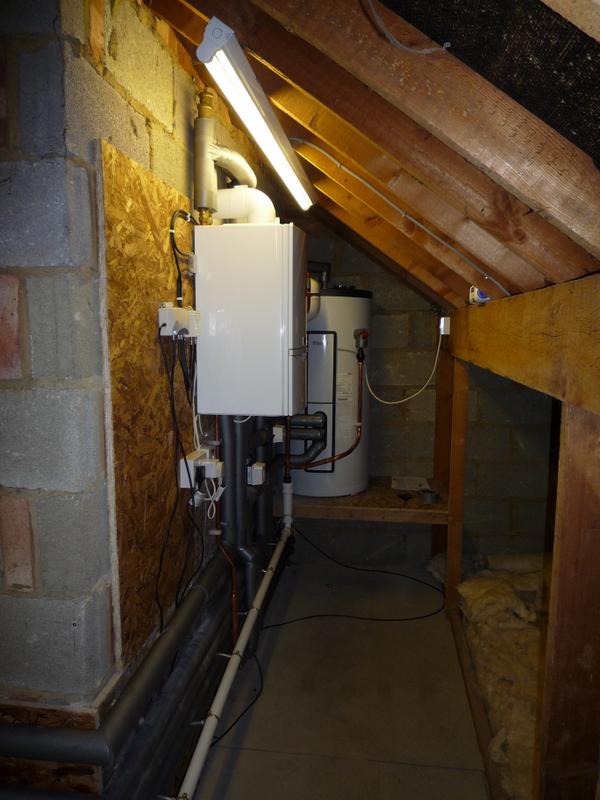

Is this ok for a boiler in a loft? Not finished yet but I'm getting there.
I won't work in a loft that isn't boarded. I'll check tanks but I ain't wobbling about on joists in amongst the insulation. You wont get any thanks for dropping a tool or falling through!
the light above the boiler is great good effort, I would still need my torch as most of my work approaches from beneath.
The condensate pipwerok inside a loft is classed as external so needs lagging at least but no harm steping up to 1 1/4.
With my lungs I would be coughing for a few days if I didn't wear a respirator though as the fibreglass is exposed. I always put mine on before I go up. We are supposed to wear a bump cap, though I don't have one, I did crack my head not too long ago so can see the rationale.
I did aproach one front door with my ladders respirator and hard hat in hand to a look of incredulity from the householder. I resisted the temptaion to tell them off for allowing some twit to fit the boiler in the loft in the first place. The twit might have been my employer after all. Have to train myself to ask who fitted it before commenting!
It will take an age for the hot water to come through to the kitchen taps though.
The installer will want more too for the extra work. :(
I doubt that it will take ages, I live in a 1st floor flat with the loft space above my flat.. so it would be directly above my kitchen.. difference of about 1.5M vertically..
pipes already run into loft space for heating, so would only need to run gas pipe, hot and cold water..

the main downside to boilers in lofts is the inevitable leaks that will ensue over many years; aav's being the main culprit.
Yes indeed they all have evindence of gradual leaks and also very shoddy repair work casing screws left off front panels tossed asside. You have to rebuuild the thing aswell as work on it.
is there enough light there?!! :D :D
Whats going on with the flue, it might be my eyes but it looks like its got quite a slope on it, the wrong way? I might be wrong...........
It does look like it has a slope on it! It is ok though, the house was built very quickly in the 70s. Some parts of it look like the builders had a few tins for breakfast so the walls are a bit all over the place. :roll:
