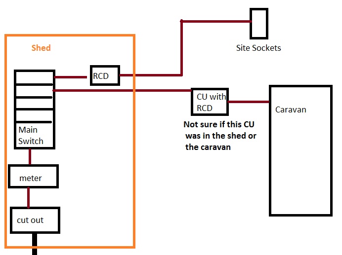

There was, meter tails went to a CU as the single isolation point. Four MCBs, during building only two used to feed caravan and builders panel.
Where were your two RCDs, then - in that CU?
If they were in the CU, so that he was complaining that you wanted the meter to be connected to a dual-RCD CU, that would be crazy - and, these days, would result in the great majority of meters not being installed!!
Kind Regards, John
At the time regulations suggested that an installation could not have more than one Residual Current Device., maybe a hangover from the restrictions on VOLCB devices.
<a diagram>
I presume that the thing in the shed with a 'Main Switch' is the CU to which you were referring, and that Main Switch would certainly serve as a 'single point of isolation' for the entire installation.
It seems rather odd that the meter installer should have been concerned about anything downstream of the single CU to which he was connecting the meter tails!
Kind Regards, John
