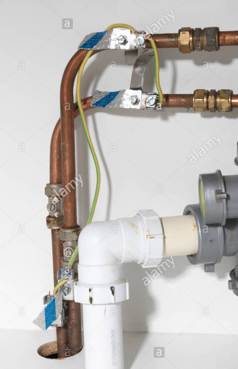

Partly because the 15th went super ubercrazy with bonding, connecting nearly everything made of metal.
I think I've bored you before with an elderly relative's house which had the Crittall windows bonded and even links put between the frames and the opening lights....
It is always explained that regs are a minimum standard. Many people working to the 15th got worried and interpreted the need to do more bonding than was necessary.
Yes agreed. However one reads court cases and often one thinks there by grace of god goes I.
I read the report on Emma Shaws death and have to admit I would have sent an electricians mate to plug in a loop impedance tester and note reading.
OK I would not have raised paperwork with the electricians mates name on it, but he should have been skilled enough to plug it in push a button and write down the readings, if it says OL then write down OL, and if I had seen a reading of OL I would have gone to site and retested.
How it is seen as OK to go into a site hut and fudge up some results I don't know? It is not what the electricians mate did which is a problem, it is what the courts did, so now you can't use electricians mates without an electrician being with them at all times.
I did a fair bit of work in the late 70's - early 80's for a developer and had to bond ALL EXPOSED METALWORK. The inspectors would test every window handle and hinge on wooden windows etc.
They got the plumbers to 'ream out' copper T pieces and slip them over the pipe then run a piece of pipe to the adjacent pipe, ie this linked 2 pipes together without a water connexion and still the inspectors of the time wanted to see earth clips doing the same job.
Did they test to see if it was bonded by holding a live wire in one hand and touching the part in question with t'other? :)
that was when someone at the IEE bought shares in the clamp makers!
