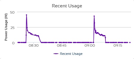

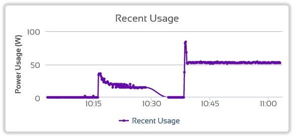

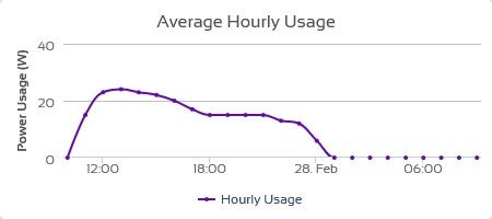

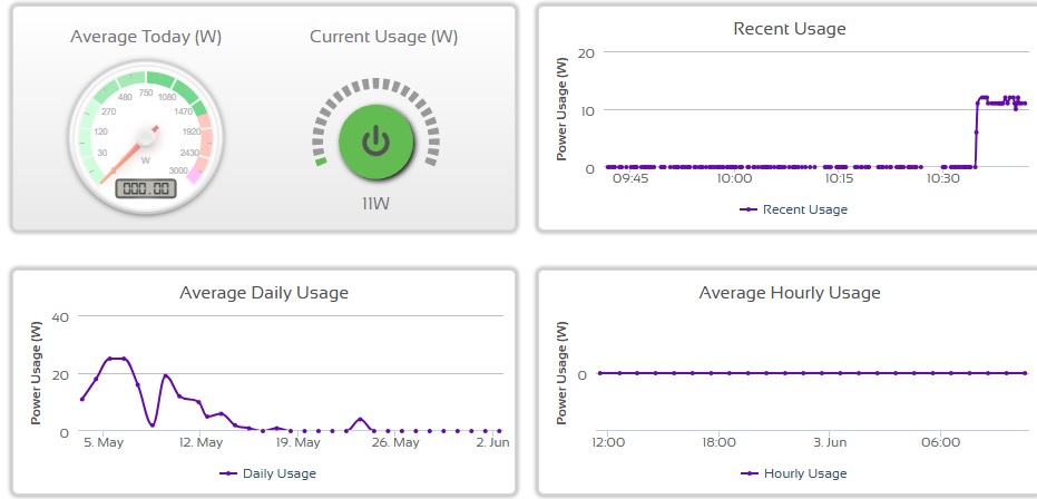

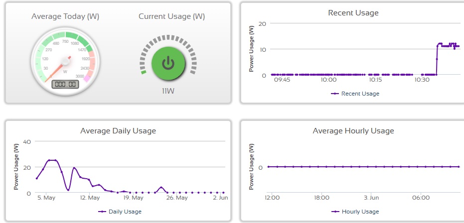

My energy monitor
will produce a graph,
this was recharging a flooded sealed lead acid, it would auto restart to charge each time battery dropped to 12.8 volts, and stop when it hit 14.4 volts, Honda battery first switch on..jpg if the battery is very low and allowed to sulphate it starts with pulses, then it goes to standard charge once recovered to some extent. The software rounds the edges so this Kia battery charge, second day..jpg showing the recharge is not really true, it does not really charge like that, it has stages. Start recharging Lindas old Jag battery.jpg There are three graphs over different time periods, only the top right is real time, but it seems all battery chargers are not the same, and some are very poor.
Two stair lifts, fathers-in-law and mothers, the fathers-in-law had a good battery charger, looking at 8 years for a pair of batteries, mothers if used a lot, batteries would last, but used infrequent, and batteries could fail after 6 months, the charger open circuit voltage was around 32 volts (for a pair of 12 volt batteries) but if used every day, then hovering around 27 volts, but if not used, it baked the batteries.
Unless you use a monitor you have no idea of the quality of the charger. With a good quality stage charger you can leave plugged in, the charger will stop and start as required, but a bad charger can overcharge the batteries.
