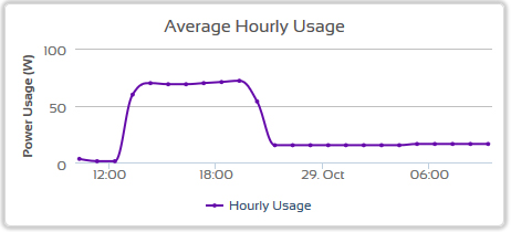

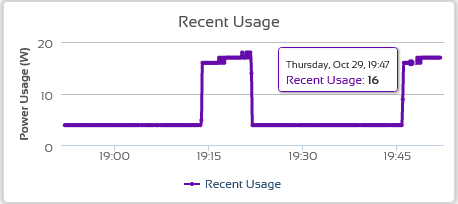

So batteries were put in parallel with a good battery to get charger to work, and charger connected to energy monitor which was on Firefox start up page so I could see if all OK every time I started up Firefox.
The result was not what I as an Auto Electrician had expected, the donor battery would quickly charge, and the charger would go dormant, and it showed no charge for around 2 weeks, then as if some one had flicked a switch, it started to charge, and the time on charge matched the Ah of the battery, and using the battery they seemed to be A1.
This was not done once, but with around 6 batteries, one proved faulty, but 5 were fit for service, varying from 7 Ah to 95 Ah. Most were AGM but at least one was flooded type.
Considering the results, it seems to make sense, if sulphur is left to harden over time, it will also take time to soften again. But until the smart charger we really did not have the option of leaving batteries for a long time on charge, it would have dried them out.
Colvid also presented problems looking after batteries, with cars sitting in drives for months, so the two Lidi smart chargers were doing the rounds, a week on each battery, the charger has 5 charging rates, 3.8A, 3A, 0.8A, 0.1A and off. Larger batteries once charged alternate between 0.1 and 0.8 amp, and smaller batteries 0.1 amp and off.

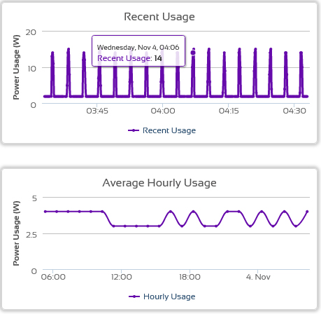

I again used the Energy monitor, and once charged you would see a good battery for example the nearly new battery in the Jaguar XE (AGM) switch off for most of the day and switch on same time every day for a short time, I assume some thing in the Jag was sending info to Jaguar at same time every day? But the older battery in the Kia, the charger was alternating between 0.8 and 0.1 amp too regular for my liking. This Jazz and Kia charging 35.jpg see hourly reading at top, I decided was not really good for battery, so would remove from charge when it did that, this Jazz and Kia charging 19.jpg however seemed to my mind OK, typical charging was like this Jazz and Kia charging 6.jpg and I would leave for a day at least on the very low rate of charge even when charger says charge is complete, to equalise the cells.
But as the battery gets older, if trickle charged the Ah seems to remain, but it holds the charge for less time, seems self discharge increases, I suppose to test one needs a load and a clock and a voltage switch, to record how long it takes before the voltage drops below a set figure. I would think running an inverter is likely the easiest way, as the inverter has auto shut down when the battery goes under a set figure, and the energy monitor would record not only the load but how long it ran for on the PC. But I have never bothered testing a battery that way.
