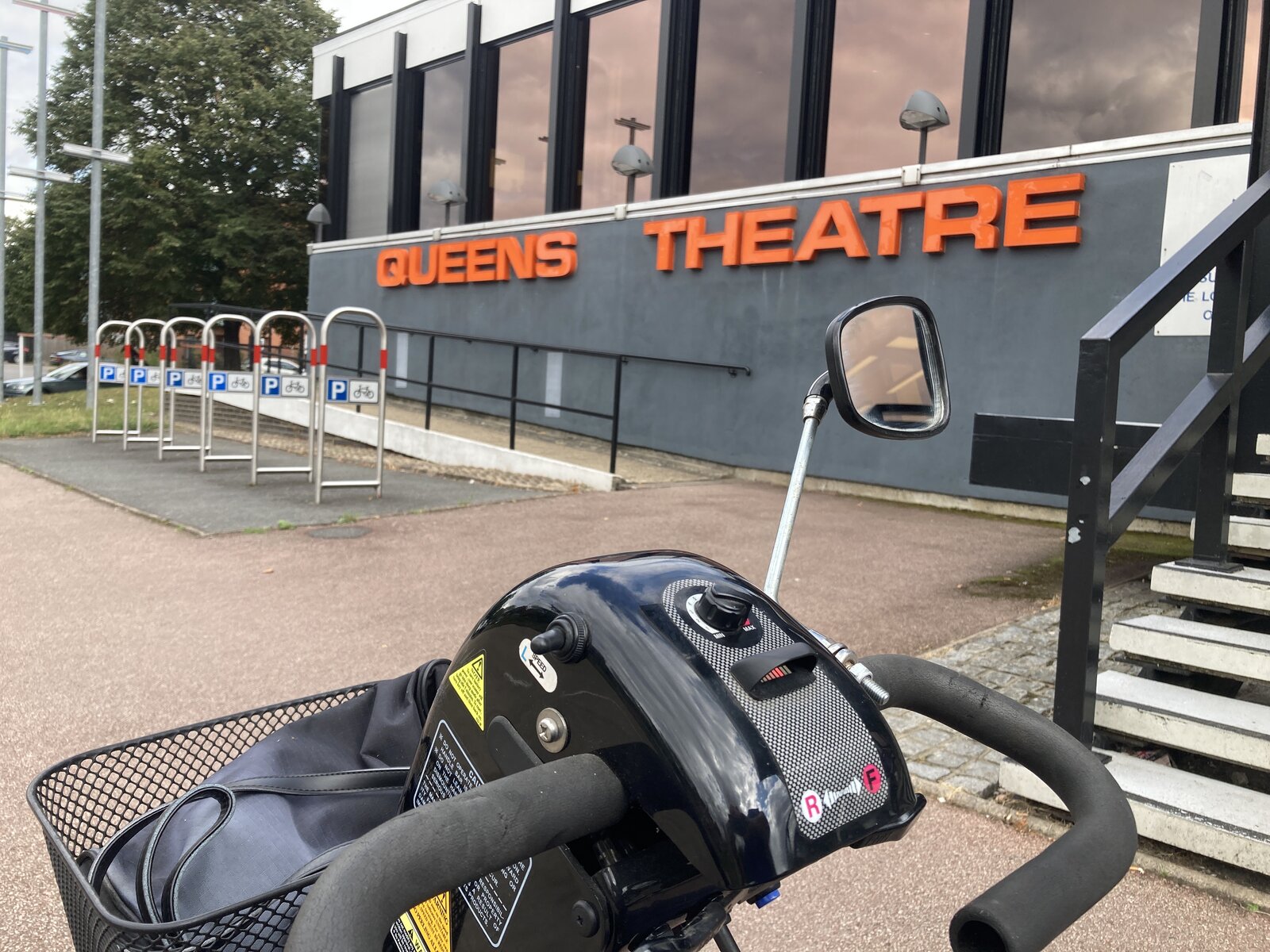

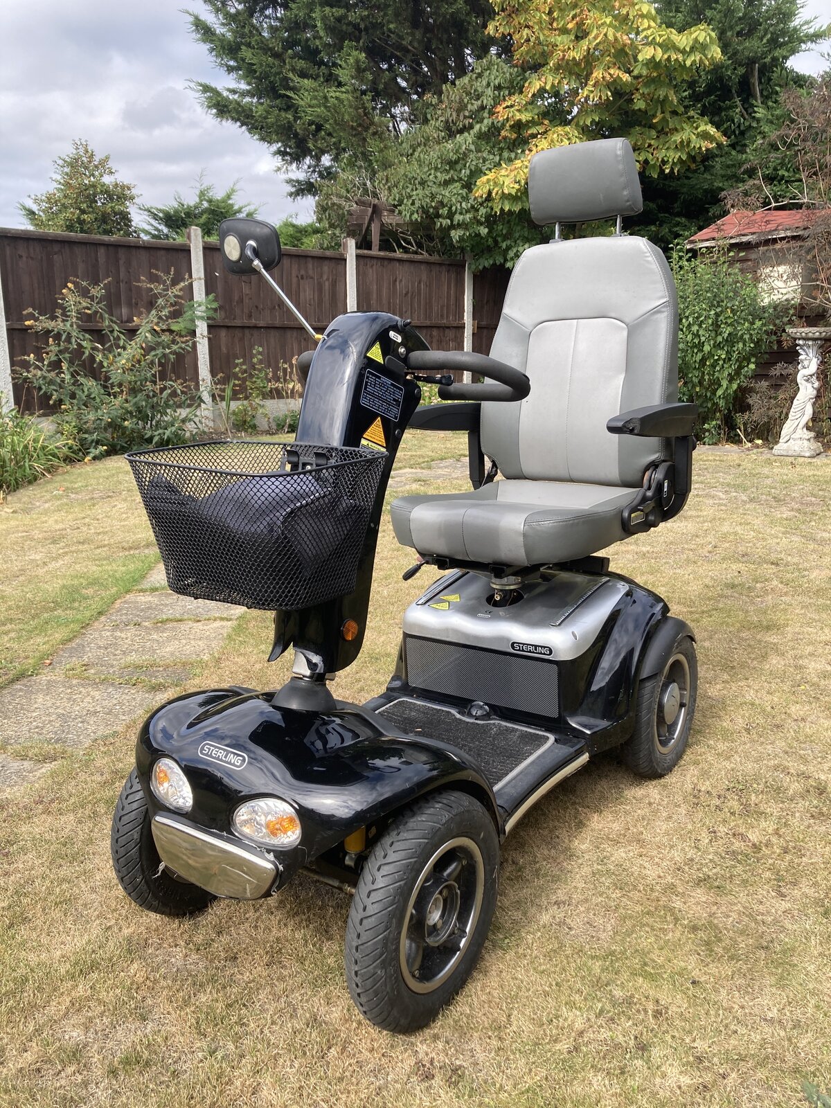

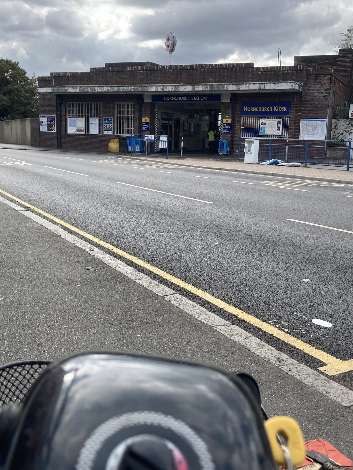

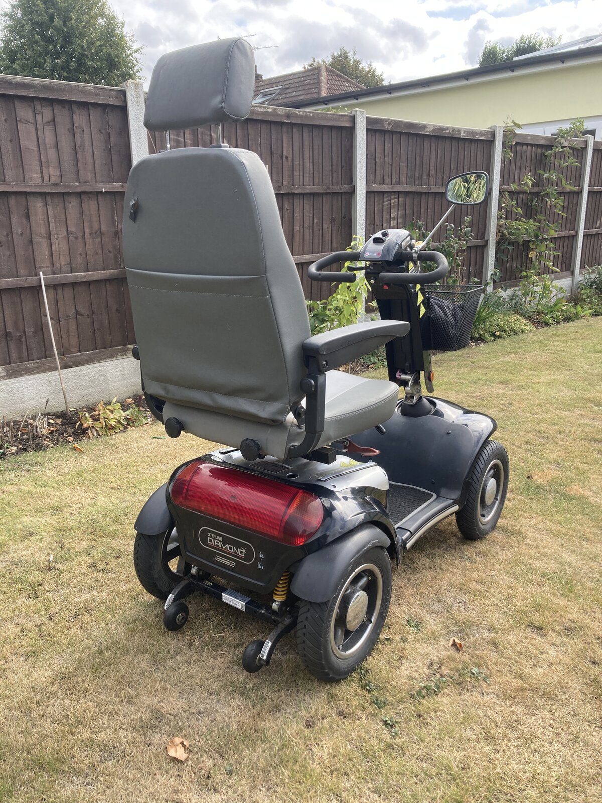

Why not try it out by continually running it until the battery depletes? You can do that without going too far from your home. That’ll give you a good idea of the range and how the battery meter performs. Before getting rid of my dad’s one, I charged it up and gave it a bloody good run all around Hornchurch. The batteries were still fine after an hour so I knew it'd have at least half an hour or more on an outward journey and still have enough to get back home.
Went round my mums, pumped up the tyres and cleaned up my dad’s old mobility scooter as she wanted to get rid of it. Cleaned up a treat. To test the battery, I went out on it - must've been out for over an hour with her dog riding on the footplate. Went all round Hornchurch. Sold it already - I let a friend of ours have it for her dad as he is diabetic, got a dicky heart and is on the list for a hip replacement and when he gave over his blood count numbers, they took his licence away! At least he can pop down the shops and the doctors on his own now.
