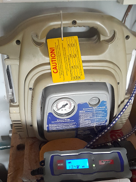

The main use of the existing lead acid battery pack, is to pump up the bike tyres, today these

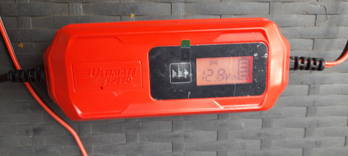

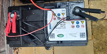

do a better job, the old battery pack 1757064751874.png now needs an external pump, so not as good, but still works, the batteries 1757064862914.png may be on their last legs, would have been used in the caravan when we had one, but will still run a light for a very long time, but I only have two chargers these work well 1757065014939.png they auto turn off at 14.4 volts, and back on at 12.8 volts, so can be left on the battery, but I am left moving these battery to battery, to keep them charged, so why not have some benefit from having the batteries?

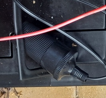

I think these 1757065309784.png maybe the answer I am looking for, if I get a couple of clips and an in-line fuse, then the cig lighter sockets will allow a host of items to be simply plugged in, be it a light or a pump, or even connecting batteries together, that seems to be the answer.
It will allow in a power cut for me to decide what I want to do. Like power router with one battery and watch TV with the other.
Just need to do the soldering before we get a power cut.
